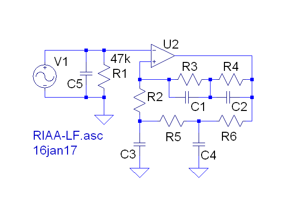

Now here's something that is novel AND useful so suitable for inclusion in the new book.
How about incorporating a 12dB/8ve HP filter to replace the infamous IEC 20Hz roll-off in a simple single OPA RIAA stage?
I worked out a single implementation in Jurassic times and the "turn your page sideways algebra" was so traumatic that I went away and wrote my own Linear Circuit Analysis package to avoid ever having to do that again (This was the days before sensibly priced and easy to use SPICE implementations ... or even 5534s ... were available)
____________________
R2 3 4 & C1 2 can be any of the 4 RIAA networks per Lipshitz. Add the extra supersonic pole to taste.
R2 with R5 6 & C3 4 implement a HP filter which is near 2nd order Butterworth HP at 20.02Hz to replace the infamous IEC roll-off.
IMHO, instead of agonising over the accuracy of the IEC amendment, we should just consider it the simplest subsonic filter and welcome higher order filters with about the same 20.02Hz -3dB point.
"near 2nd order bla bla" cos at very LF, the non-inverting stage reverts to unity gain.
This would be difficult to implement accurately with switched gain so perhaps single examples at 40 & 30dB 1kHz gain would be good.
Besides, Holman & others show that there is a huge bump extending into the audible range from the cartridge/arm resonance and there is a good case for variable Q on this 20.02Hz filter
As Doug apparently shares my fear of mind bending algebra, perhaps Mark Johnson could work out these 2 simple cases when he has a spare 20min.
