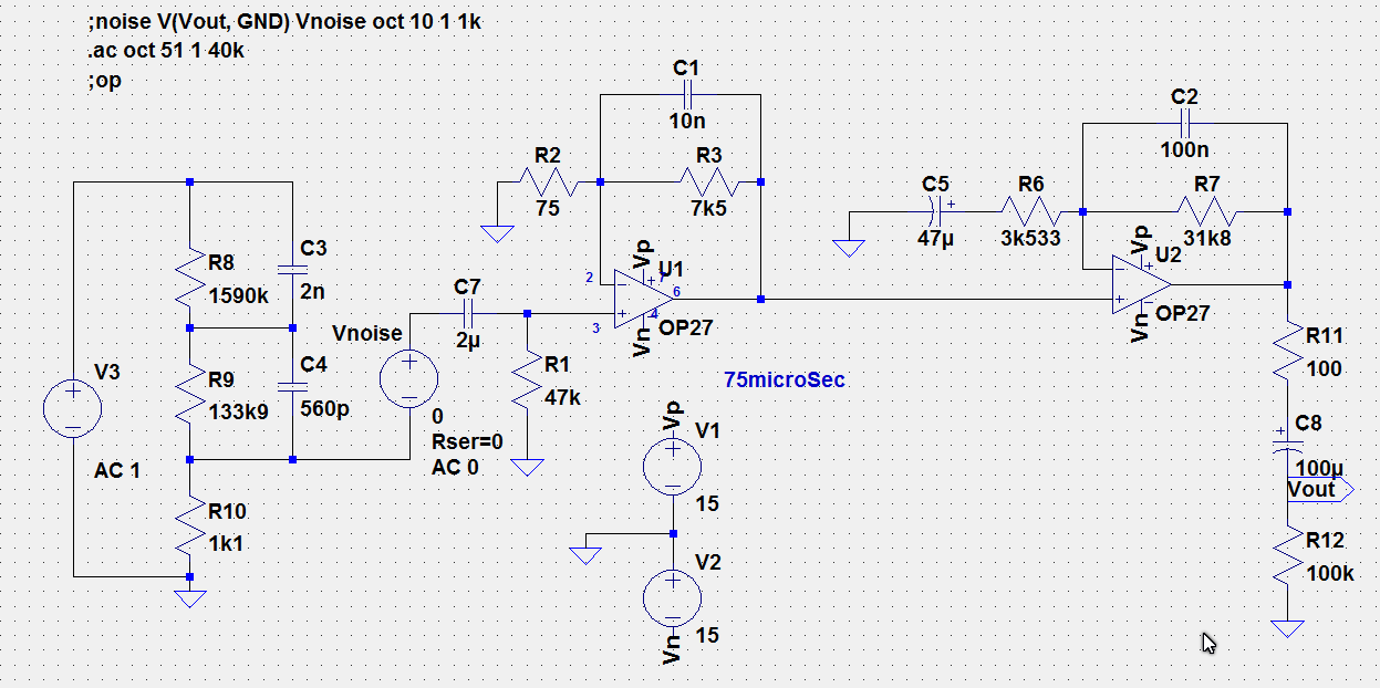

All active only uses a single amplifier stage - so it is in fact simpler than active-passive types where you have a gain stage and almost always a buffer. The only 'challenge' with all-active is in doing the network design properly and as you can see from the previous posts, that requires a bit of effort but it's not rocket science.

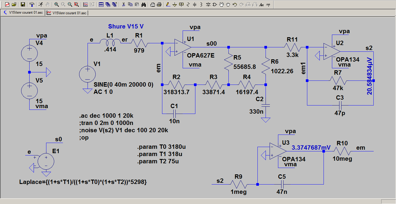

Not so, it is perfectly possible to use 2 or 3 active amplifier stages, se attachment.
It is even extremely easy to design to within any desired accuracy and also decrease distortion as no amplifier needs to do 56dB+ gain at low frq.
Wrt inverting RIAA, there is a noise penalty from the input resistor - no penalty with non inverting.
No noise penalty in the case of inverting current mode RIAA, but you have to optimize for each cartridge.

Yes indeed you can make active over two stages - I was just showing in my earlier post that you can use 1 stage and get good performance. If you are using a good opamp, why use two stages = extra noise, complexity etc?
In your split active design, opamp 1 contributes additional noise - that's your trade off since you are boosting the low frequencies in the 2nd stage. If you try to reduce this effect by swapping the stages around, you give up HF headroom in the first stage, but possibly get better overall noise performance. It always pays BTW to try to put the high gain stages first in a signal chain wrt noise performance because the input referred noise of the later stages gets divided by the previous stage gains.
No easy solutions outside of all-active single stage designs I am afraid without tradeoff's!

Yes - agree. I think Erno borbely has done a very good design in LA recently showing this technique with MC. Probably not so easy with MM (Zsource varies significantly over frequency) but I have not tried this. Do you have a design you can share?
I made this one which I still have to optimize : you have to include the low pass formed by resistor and self of the cartridge in the response.

You don't necessarily get lower noise with 1 opamp vs 2 or 3. Complexity within reason is not an issue nor a goal in itself. You can't hear lack of complexity. Designed correctly, you can get quite good results with lesser opamps. LM833 comes to mind - it is less noisy than NE5532 at very low impedances and for the price of one LM4562 you get 7 LM833, for basically the same noise performance.

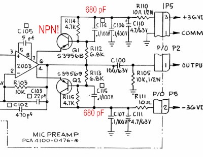

There's no doubt passive-active, active-passive or active-active work - there are plenty of examples around that attest to that. I think the statement that's been made by the single active stage proponents is that there are tradeoff's with these approaches that do not exist with single stage all active designs.
That might be an error too. Not my drawing.
EDIT: That IS a drafting error. In the JH-500C they are 680 pF.
I've used that circuit with far lower values of capacitance.
As a general concept and headroom extender it works OK.
MCI used it first in the 500-series console in the EQ section to replace the HA-2645 HV op amp. If I can find a schematic I'll look and see what C values they used.
By posting this it does not mean I think boosted rails are necessarily a good or bad idea in a phono preamp. Simply a point of reference for a 40 year-old circuit...
Here's a corrected copy from the JH-500C mic preamp. The Cs are 680 pF.
The 0.1 uF rail bypass are nearby.
Their proximity in the drawing obviously must have confused the draftsman in the JH-600 schematic.
Not surprising since he got Q1 wrong too.
Good catch. 680 pF moves it to about 87 kHz.
