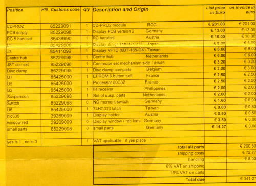

I'm not sure if it's wirth it. My cost actually was 340 Euro (shipped) plus another CAD70 in duties and CAD30 for money transfer costs. But I assembled the dispaly board myself and didn't buy all the componenets. It was also more than a year ago and transport was 201 Euro😉

Here's what I bought.
