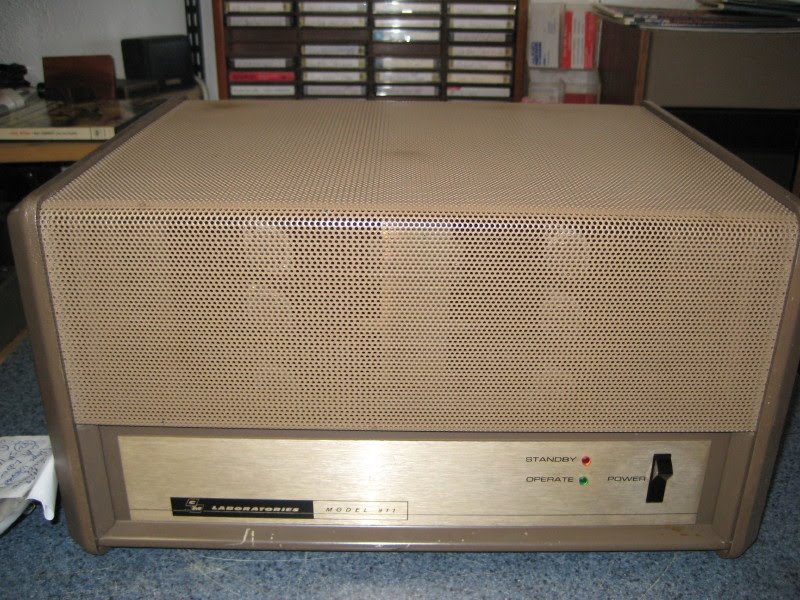

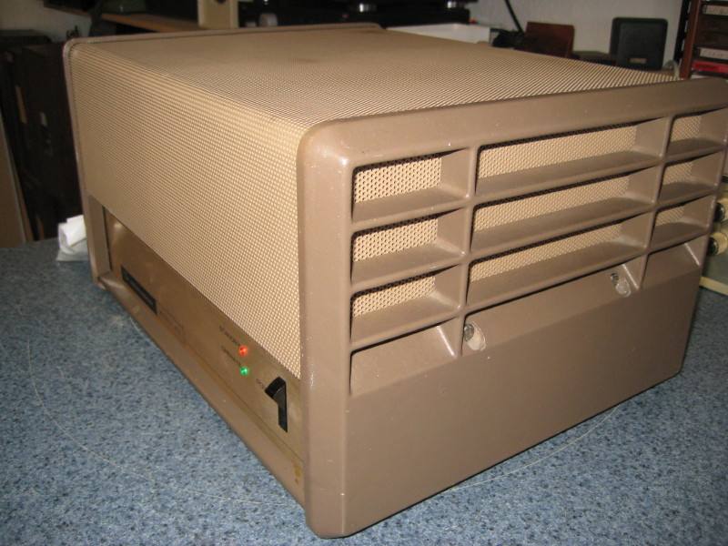

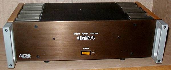

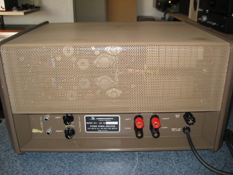

CM lab 911 and 914 (CM911, CM914)
one of this amps could also be one of the earliest models with complementary power devices - unfortunately not exactly to determine because there are no schematics:

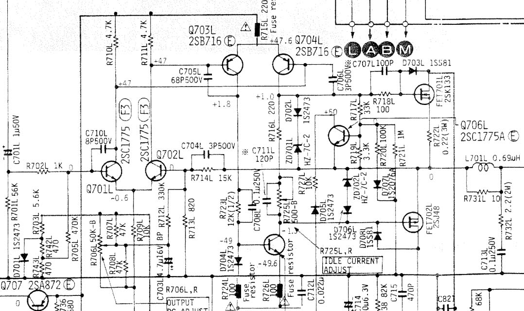

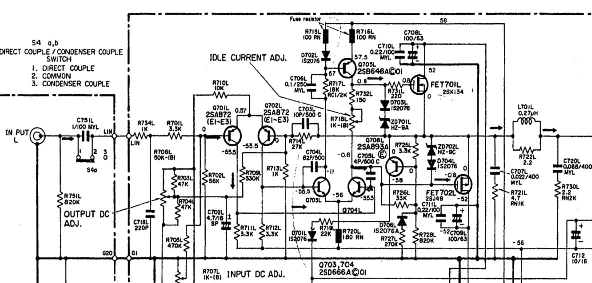

It would be an interesting exercise to build Bart Locanthi's amp exactly as it is but with modern improved components. Looks very simple and quite elegant.
Already done in 1978 and 1979 by Hitachi, in their first power amplifiers demonstrating the advantages of their 2SJ/2SK lateral MOSFETs. Note the use of the current mirror as collector load for the VAS. That's an elegant evolution from Locanthi's January 1967 schematic. Audio-grade opamps like NE5534 and OPA134 have the same structure. Was Locanthi the originator, in January 1967, of such twin differential arrangement ?
