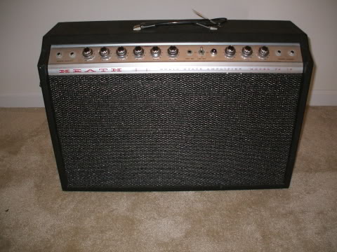

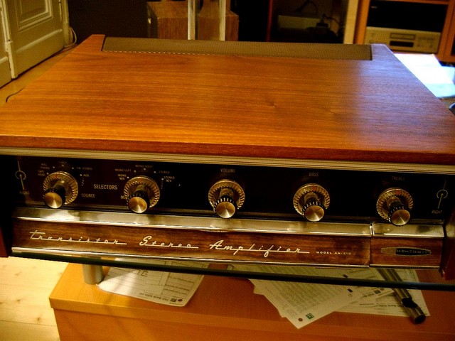

Heathkit TA-16 Guitar Amp supplement to post #95 and #96
The guitar amp TA16 from few yoears later uses the same power amp topology (OTL and complementary push pull) and the same output power devices, only mounted on the amp chassis.
VINTAGE c. 1968 Heathkit TA-16 Guitar Amp Twin 12” -- fat sound! (South Park Slope) $150 | www.socialwonder.com

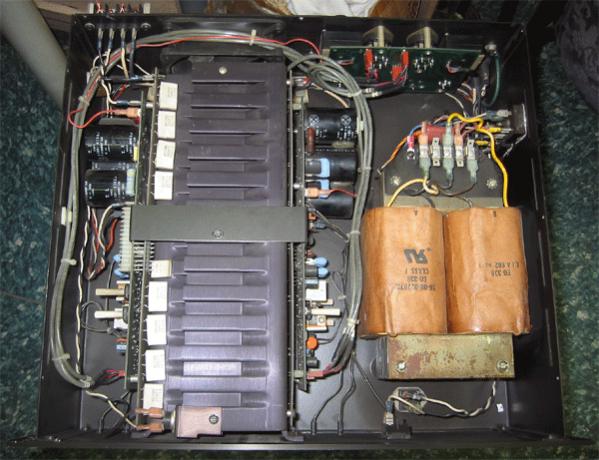

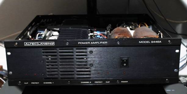

Altec 9446A - maybe first true complementary "Grounded Collector" Topology
QSC and Harrison create similar amps with follow goal: To avoid stuff for electrical isolated mounting of the power devices.
QSC (model No 1080, 3200, EX4000B) used also grounded collector topology
http://www.qscaudio.com/support/technical_support/schems1.htm
Harrison use the grounded source topology (Source-Connection instead that one from Drain is on the iron TO-3 enclosure by the used Hitachi lateral MOSFET's). This schematic you will find about
http://www.diyaudio.com/forums/solid-state/147392-harrison-type-k4000-k-4000-mkii-2x1000w-4ohm.html
Altec 9446A could be the first power amplifier in this topology

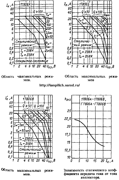

When I was a kid I tried to build amplifiers out of them. And found out very quickly what second breakdown was. The ones I tried were rated like 80 volts and 15 amps - but wouldn’t even work on a single 36 volt rail. Didn’t even bother to get hot and still shorted out.
I went back to the old standby, the 2SB407 in a TO-3. And in those days you could get them at *Radio Shack*.
Attached a safe operating area for the Ge russian GT806. Is rare to see data for second breakdown for Ge.When I was a kid I tried to build amplifiers out of them. And found out very quickly what second breakdown was. The ones I tried were rated like 80 volts and 15 amps - but wouldn’t even work on a single 36 volt rail. Didn’t even bother to get hot and still shorted out.
And the collector curves bends almost vertically on some Ge if one exceeds this zone by much (not all Ge, some have surprisingly nice curves even exceeding power ratings). That means most Ge have the maximum collector voltage specified only for cut-off conditions.
Good to hear that I was not the only one, every Germanium power amp I built did not last longer
than a few minutes. I built them from an old RCA transistor manual before the AP notes went to Silicon transistors.
I remember wanting a Germanium NPN output device and eventually finding one but the
amps still failed.
amps still failed.
