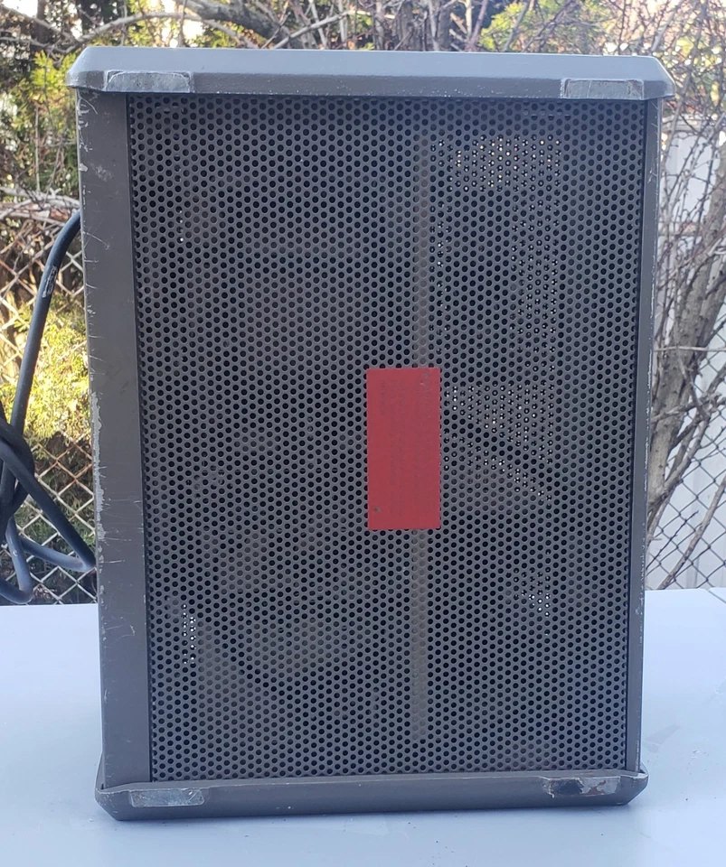

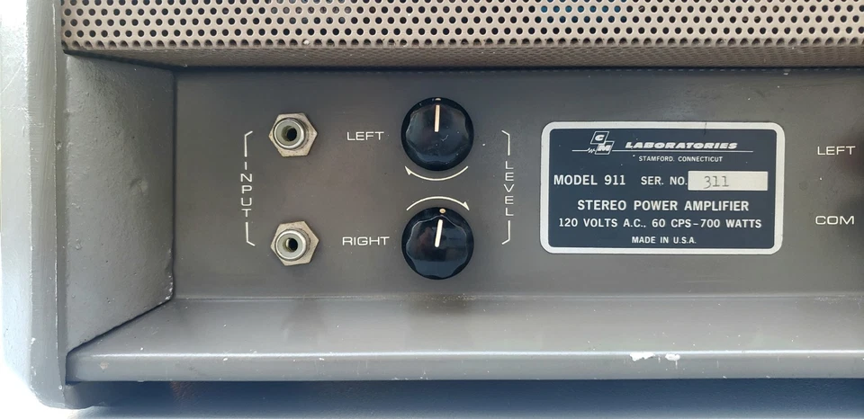

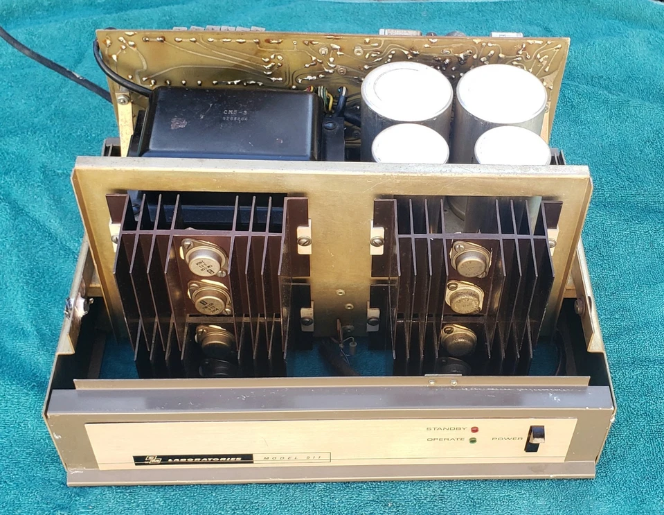

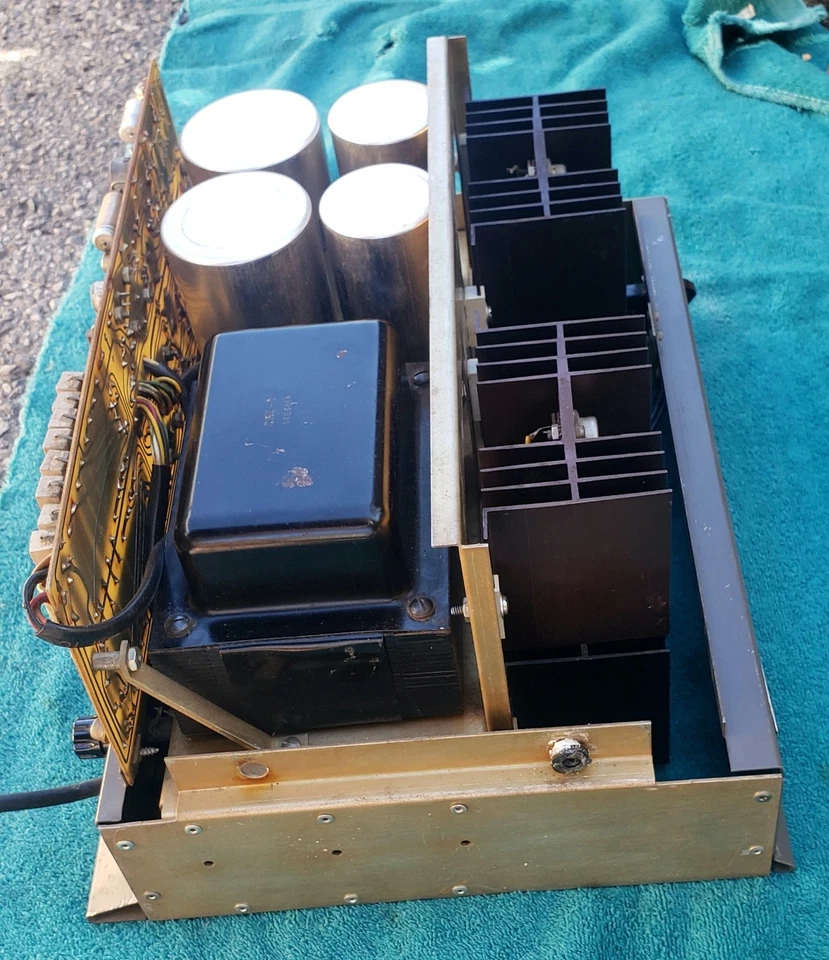

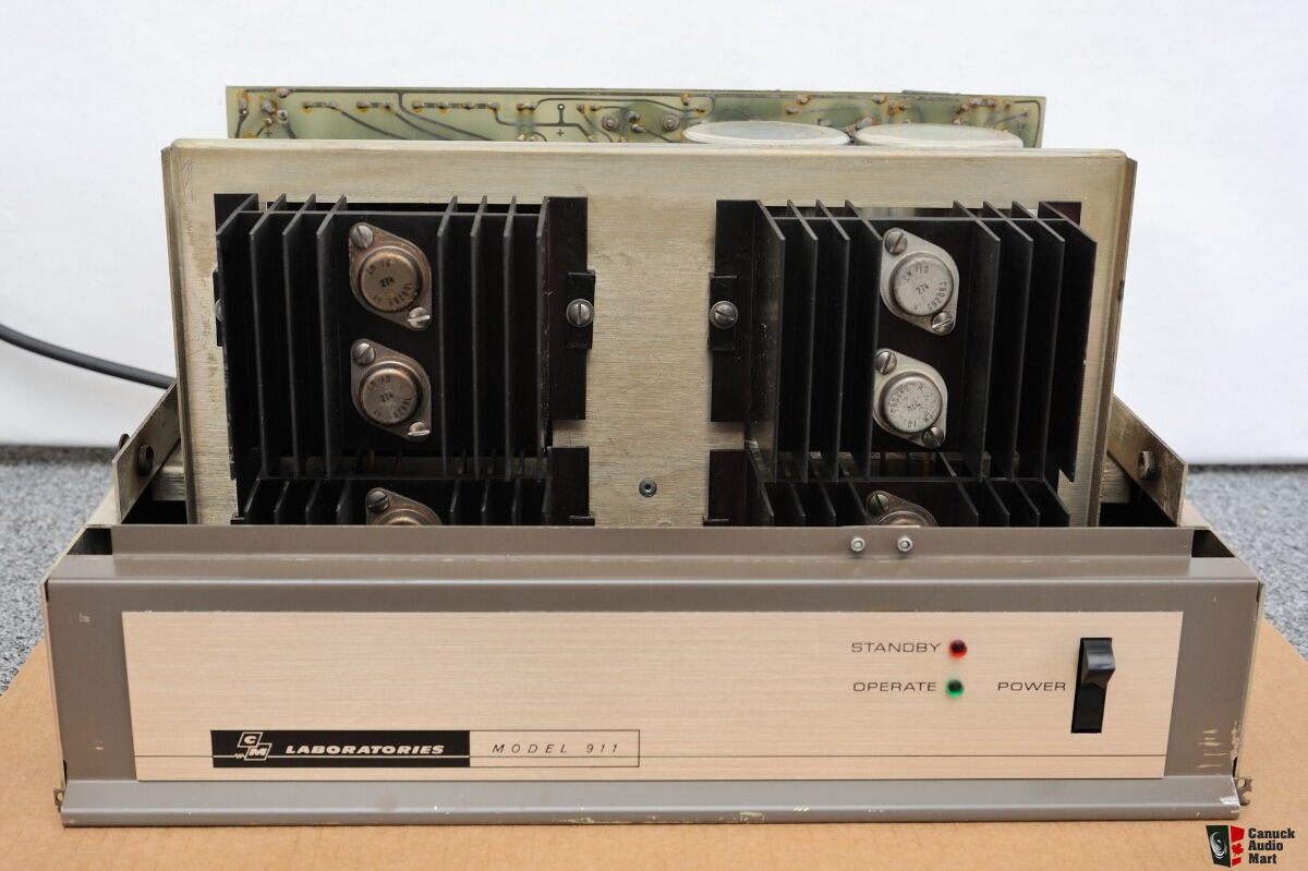

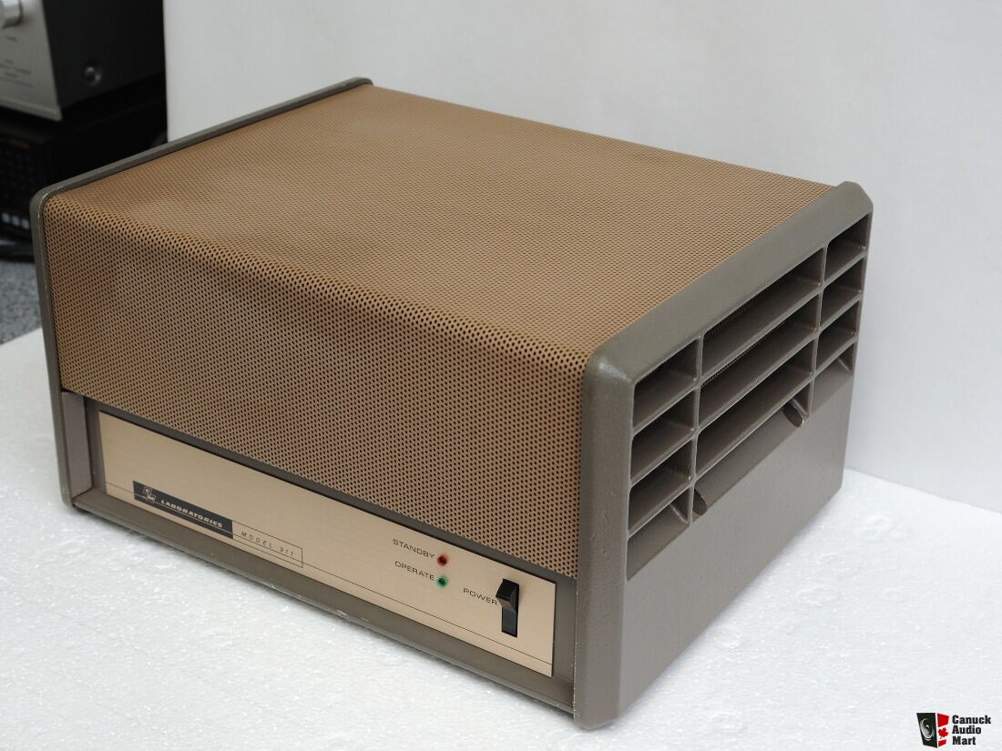

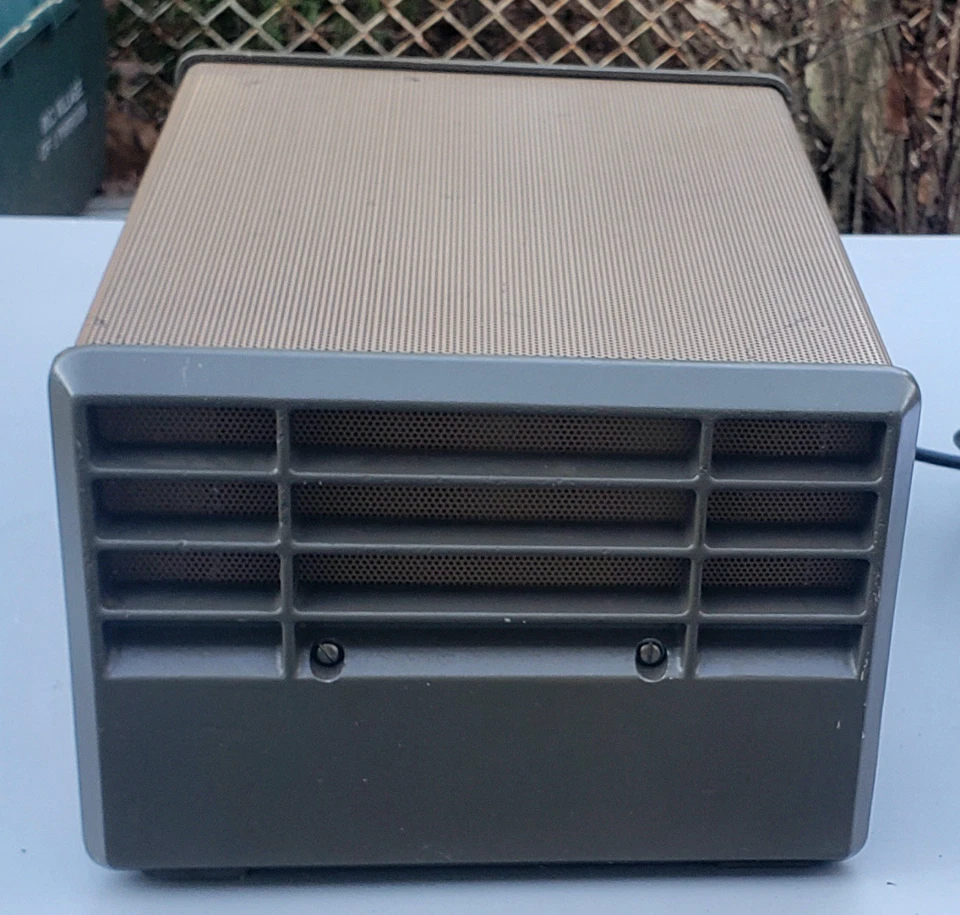

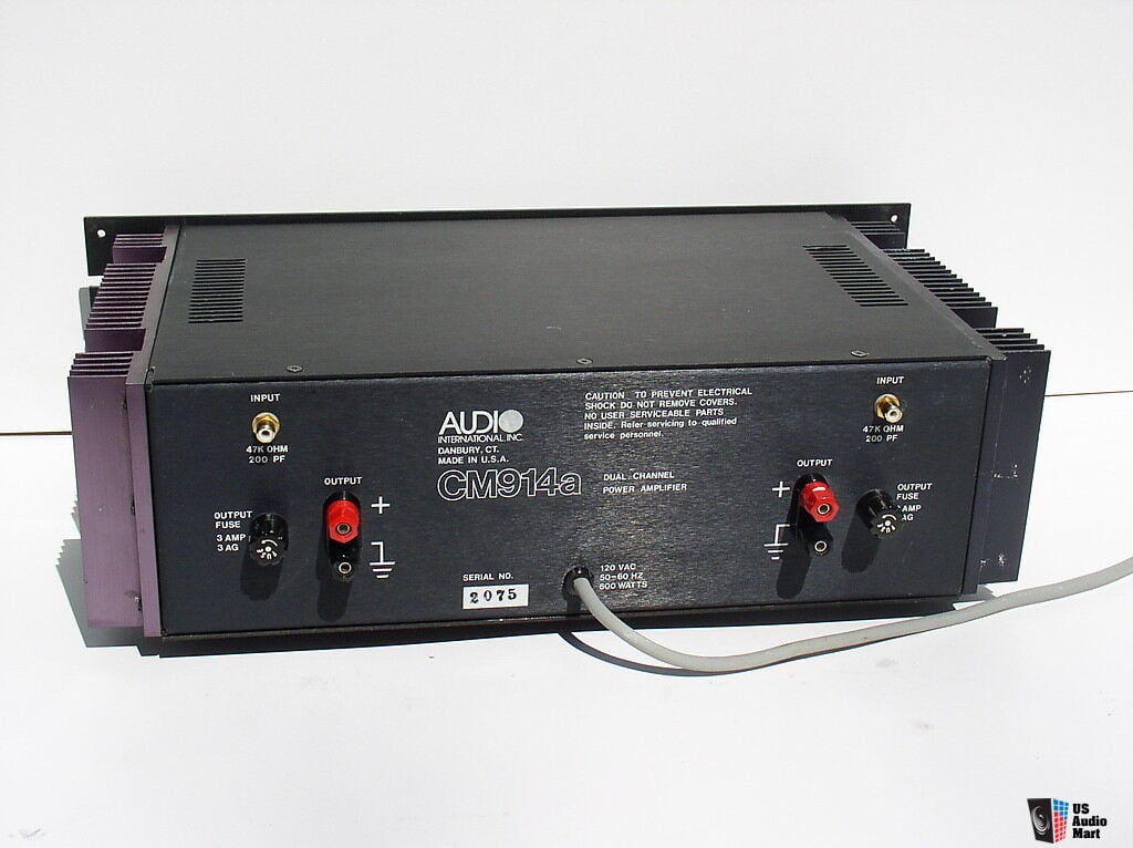

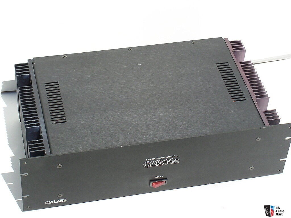

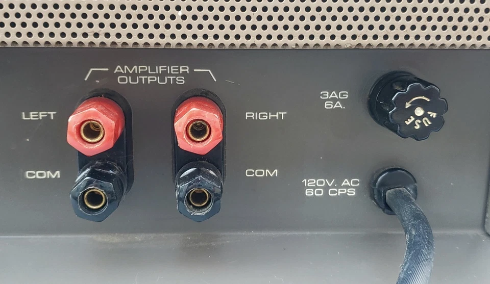

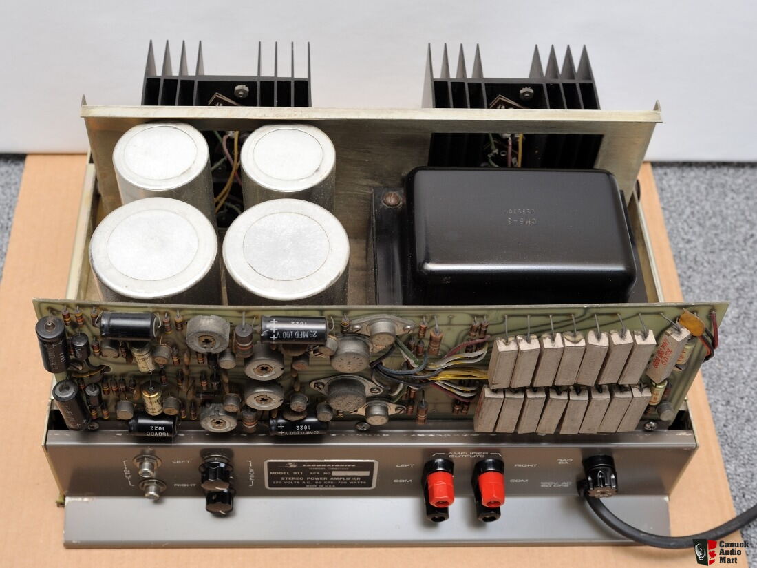

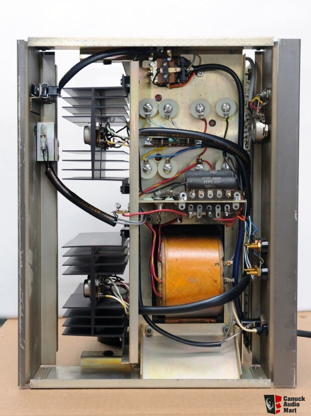

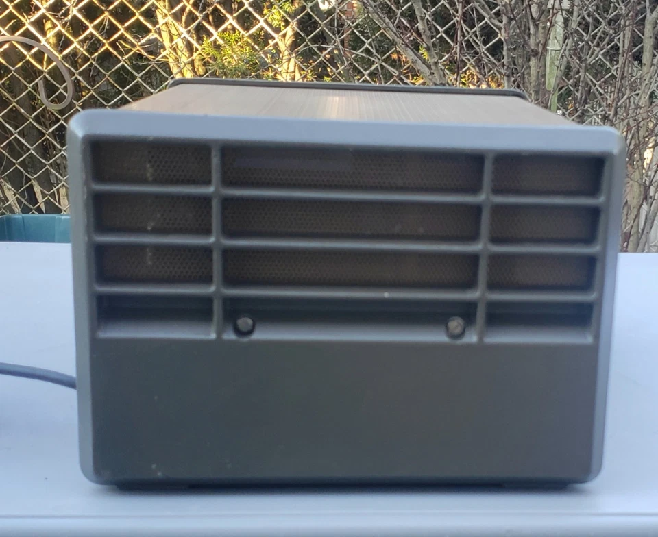

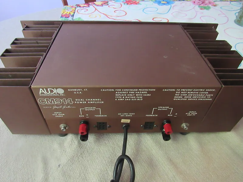

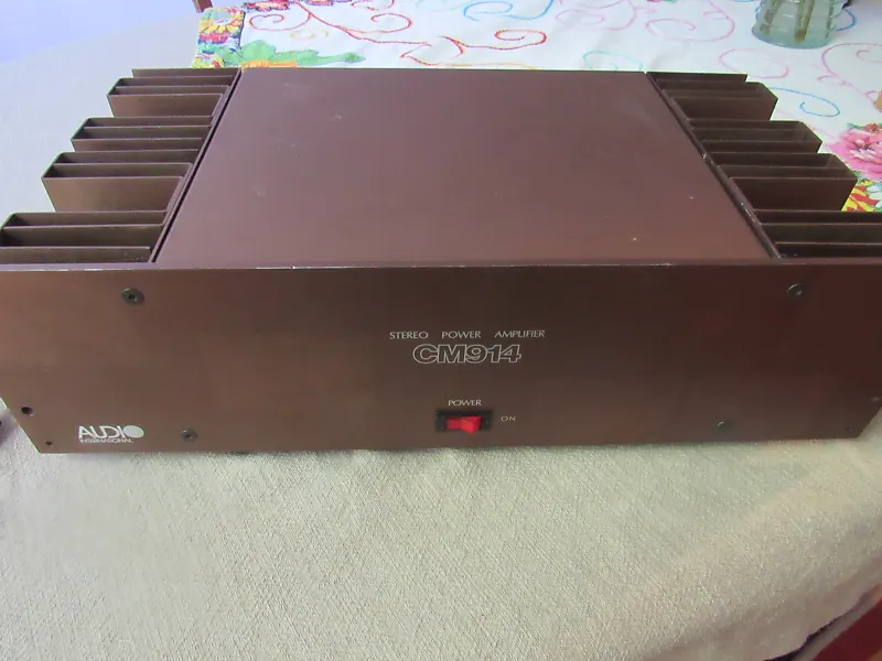

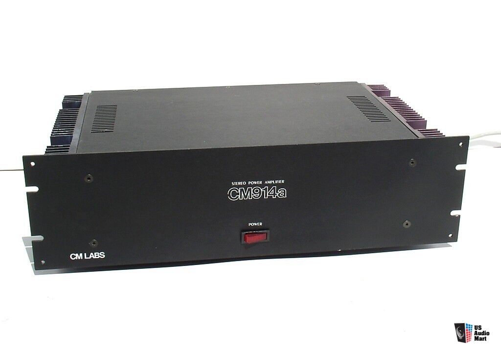

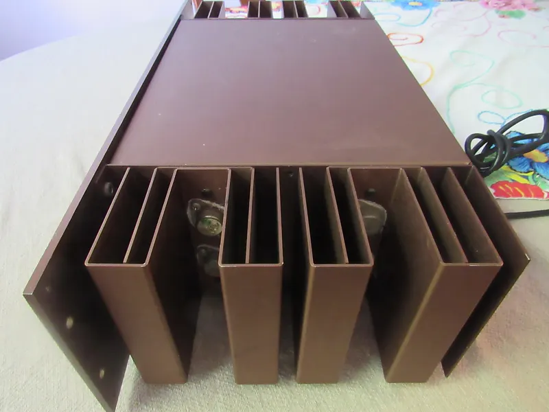

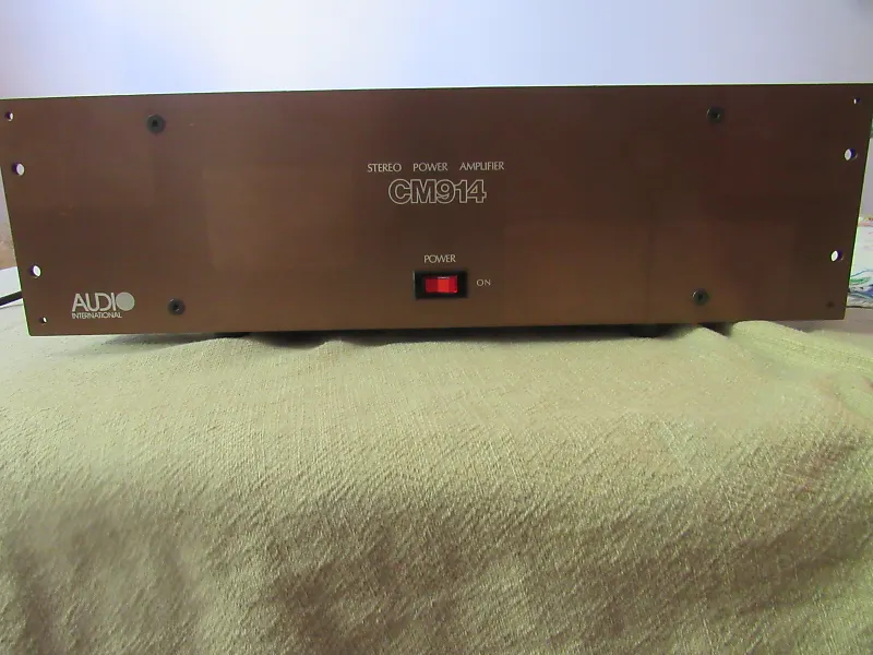

images of CM Labs 914a, 914 and 911 (supplement to post #58)

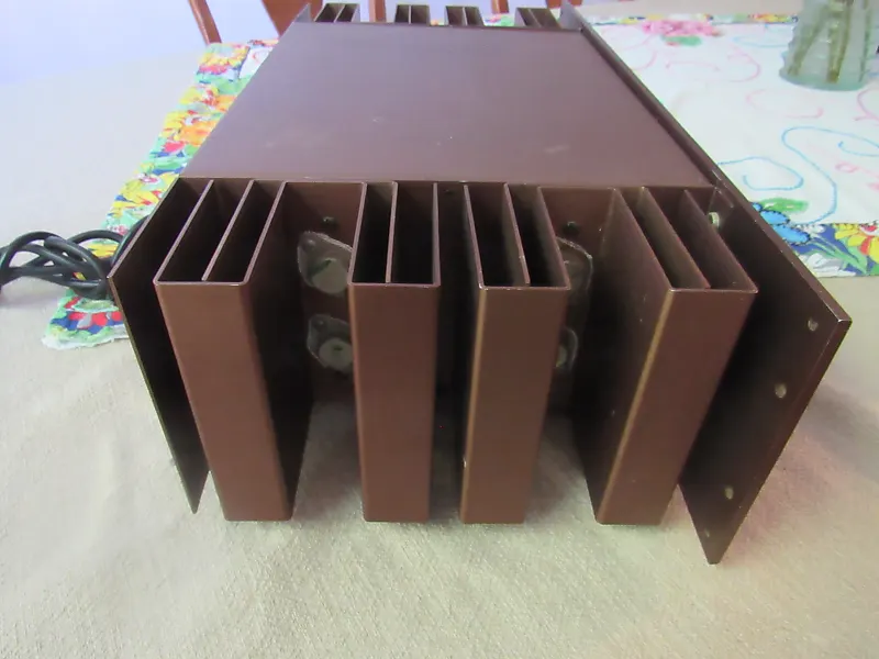

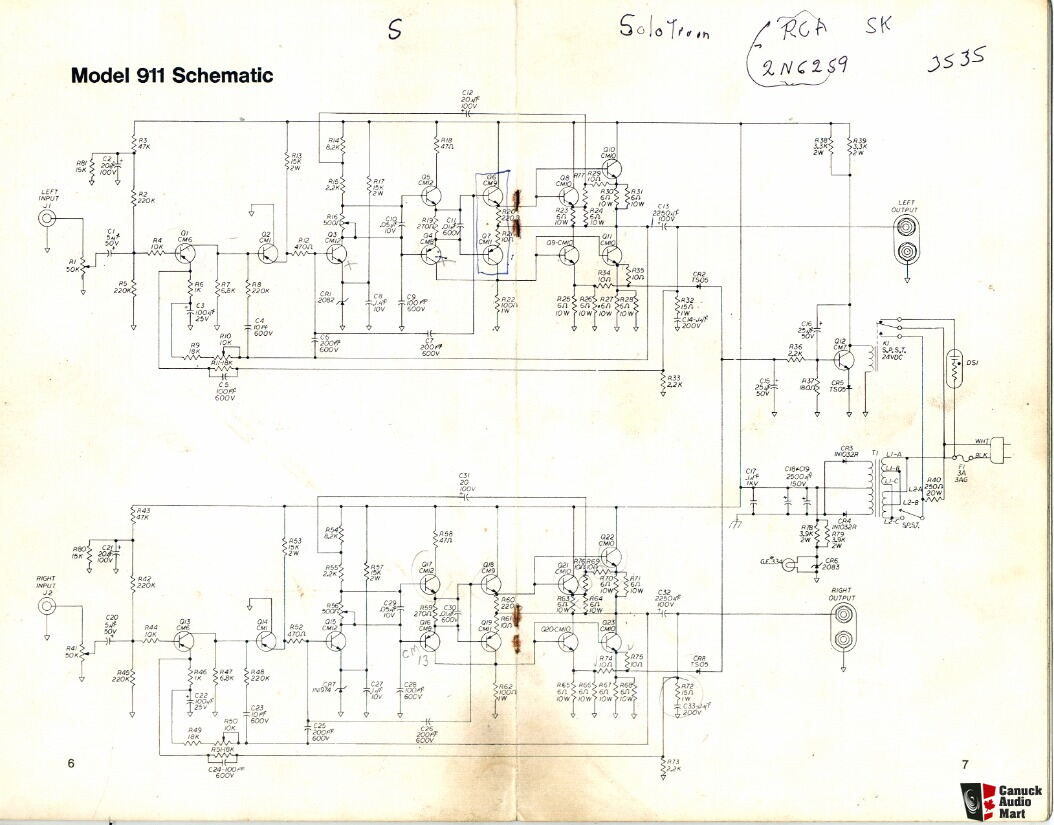

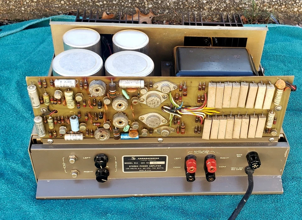

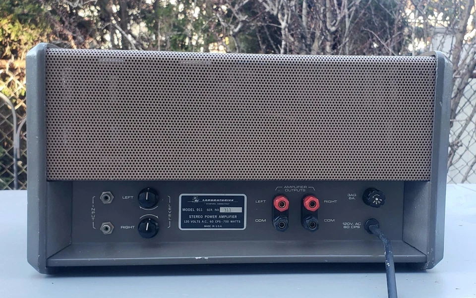

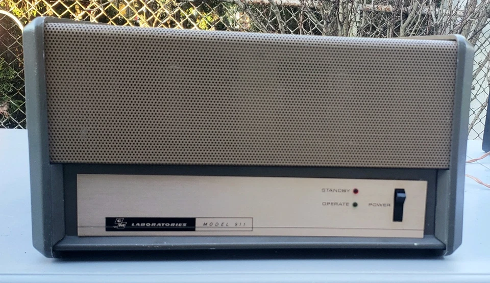

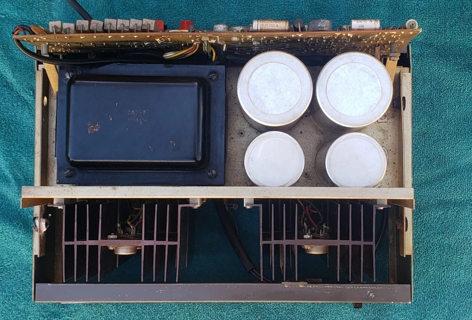

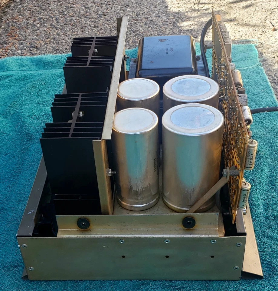

images of CM Labs 911 (supplement to post #58)
- What was the first Complementary AB bipolar amplifiers?
