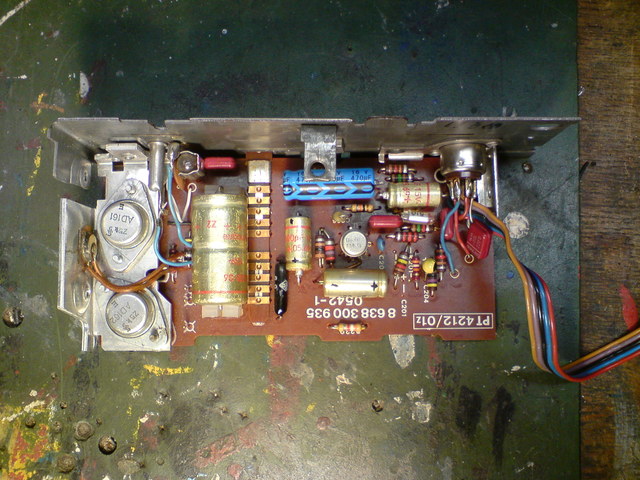

I think the first true complementary silicon transistor pairs in Europe (to realize OTL Class AB stages) was germanium transistors like
- AD161/162 often to find in amp sections (10W - 15W) of UKW-FM Stereo receivers from German brands arround 1966 until 1973 like this:

also to find in various Blaupunkt car audio receivers from the same aera
Frankfurt 7.630.640 Radio Blaupunkt (Ideal

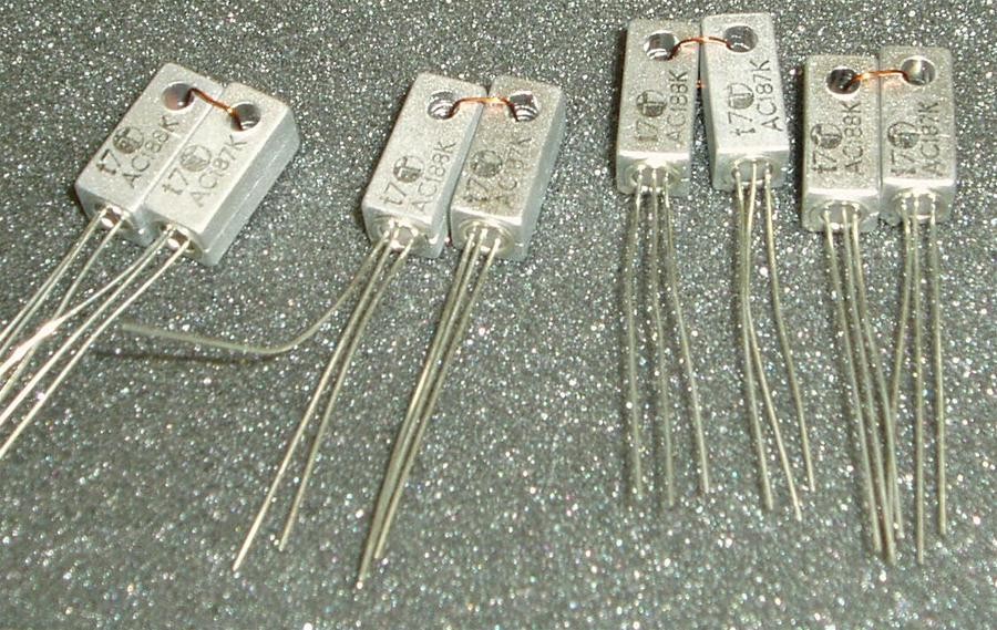

- AC187K/AC188K mostly to find in medium pocket radios like "Loewe Opta" Lord - see attachement and
http://www.yellab.com/auctions/AC187K-AC188K.jpg
for output power 4 watts max.
- AC127/128 - same than AC187K/188K, but without screw-block for heatsink mounting - therefore only 1W max
Until this day I haven't success to find the orig. datasheets from brands like Valvo (now NXP/Philips Components), Telefunken (now Vishay) and Siemens. I am highly interested to such datasheets.
Pocket radios and amps/receivers for low/medium output power from Japanese brands haven't true-complementary output stages in their amp sections in this aera - as I know. Instead of this there are still driver transformers and output transformers in use, even by very small pocket radios like formerly German's topologies used AD149, AD155 or OC-Series like OC26/OC36.
