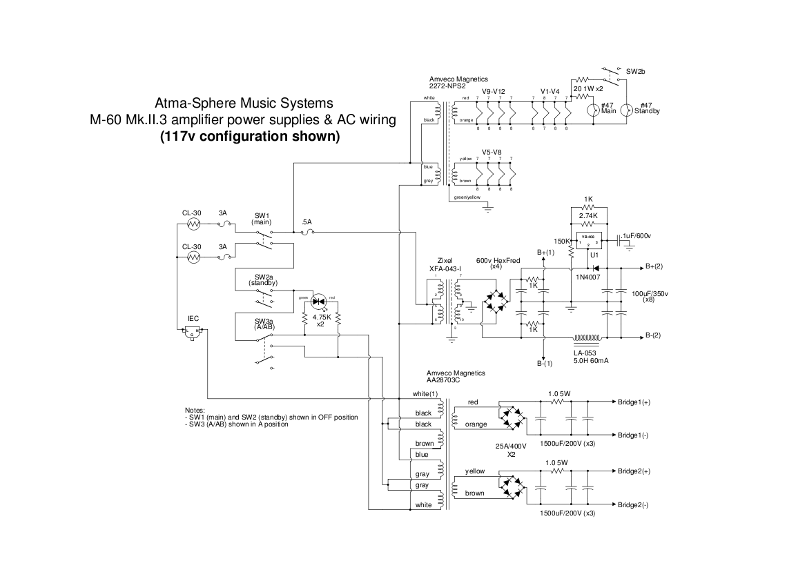

Any chance you'd post power supply schematics for the M60's?

Here ya go... the transformers are proprietary and the usual copyright restrictions apply.
Thank you.
There is benign mistake in PSU schematic posted by Atmasphere.Both SS 25A rectifier is conected inverse to filter.

Supous you are begginer in tube DIY.That Atmasphere schematic is 100% OK.Circlotron output stage have excelent common mode hum& noise rejektion, so from dual floathing ouput PSU and filament to cathode hum & noise induction is automaticly canceled in the Load(speaker).that is not case in Futterman topology.Input dual diferencial cascode stage have same rock stable nature,driver stage too.Important is to conect Psu trafo secondary`` in phase`` with SS rectifier both for output stage and filament.Anyway this OTL amps are rock stable and sounds supreme.If you are not expirienced Diy guy maybe solution for you is to by M60 Diy Kit from Atmasphere(dont know did sell this Kit anymore) or finished amps.Think for output 2 phase bridge is 150v/1A(two time) and for input and drive is bipolar +- 300v/100ma(for precision answer ask Atmasphere).In general VDC is VACx1,41.I made some circlotron multiphase Otl amps and thats the best souding amps I ever made.Salute
You could use a choke in the output section power supplies. I like to use the one ohm 5 watt devices because I want immediate current availability from the power transformer. BTW, the better the transformer the better the voltage stability.
Noise induced by the AC filaments in the driver circuit can be an issue if the power transformer has poor or no electrostatic shielding. We usually run the filaments off of the output tube supply. The 6SN7s are quite rugged when it comes to filament/cathode arc over and so this means has proven quite reliable!
The driver supply should be HEXFREDs or similar for best results. OTOH a good quality silicon bridge is all we use in the output section. Cheesy ones will require a fair amount of neutralization. We have used HEXFREDs in the output too, but you will have to provide heatsinks for them and use the highest current ones you can find. Silicon can survive up to 10X its rating at surge; whatever the HEXFREDs are rated for is also their surge current.

atmasphere,
Thank you for providing this information along with the power-supply schematic! I had assumed that the power-supply underlying the M-60 would share the traits of the signal-path topology --- a simple, rational design that has been refined by listening to the circuit over an extended period of time. The M-60 power-supply is the semi-massive, yet straightforward, support system that I had assumed would be necessary to provide the robust power characteristics necessary to support the 60-watt configuration of the Class-A2 M-60.
I am uncertain of the power-supply sub-circuit centered around the three-pin device, U1, on the B+(2), largely because I cannot discern the part designation on U1. Is this an AC-ripple regulator?

The M-60 power-supply design posted by "atmasphere" is closely aligned with my expectations; the balanced/differential nature of the M-60 signal-path topology would tend to provide a fair degree of immunity to power-supply disturbances. So the simple, rectifier-fed "pi" filter sections make perfect sense; we just need substantial, well-filtered energy-storage capacity to meet the power-supply requirements.
The inherent simplicity of the power-supply design places a premium on the quality of the power-supply components themselves, so we need to carefully select the specific components employed in the M-60 power-supply implementation in order to avoid compromising the audio characteristics. I imagine that a significant portion of the M-60 circuit refinement over the past three decades has been focused on optimizing precisely these type of parameters.

The M-60 is configured for Class-A operations throughout, so as long as we have sufficient energy-storage in the power-supply (that is well-filtered, combined with reasonably low ESR across the audio-band), the resulting power-supply rail voltages will be quite stable. The balanced/differential nature of the M-60 signal-path will largely cancel-out the residual power-supply noise.

The power-supply transformers that I had suggested for the M-60 were selected to meet the voltage/current demands of the various sections of the power-amplifier. The input/driver stage power-supply transformer will produce a +/-325VDC set of power-supply rails while the transformers suggested for each "phase" of the Circlotron/bridge output stage will produce a set of +/-104VDC power-supply rails.
The input/driver stage isn't especially sensitive to the slight increase in B+/B- voltages (325VDC vs. 300VDC). However, I will need to recalculate the resistor values for the voltage-divider that sets the output-stage fixed-bias current. The output stage can easily accommodate the somewhat lower power-supply voltages that result from the suggested power-transformers (104VDC vs. 140VDC) and actually benefits from the reduced 6AS7 plate dissipation.
The formula for converting transformer secondary VAC ratings to the resulting DC-voltage is (VAC rating) x SQRT(2), then subtract the voltage-drop across the rectifier diodes.
banat,
Thanks for your scrutiny of the power-supply schematic! I'll be certain to include the correction in the M-60 power-supply that I plan to post to this thread.
