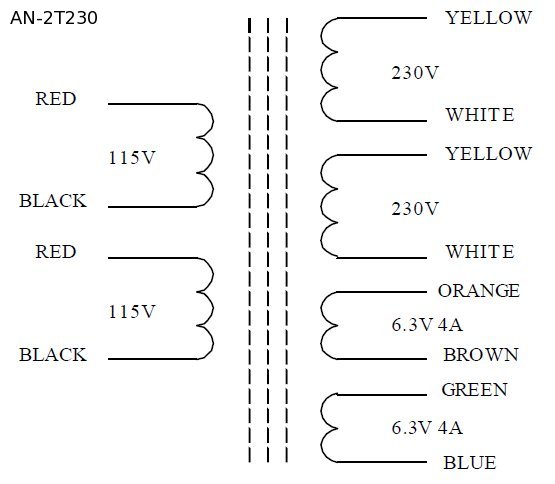

Power-Supply Transformer: Input/Driver Stage (1x)
The power-supply transformer for the input/driver stage can provide either center-tapped or separate secondaries since the +/-300VDC power-supplies will be joined at a common reference ground potential. The combined current draw for the input/gain stage and the driver stage is 18mA (with the pumped-up current-source configuration from the MA-1). The transformer I've targeted for powering the input/driver stage is:
The AN-2T230 is a 200VA transformer with dual 230VAC secondaries, each rated for 400mA of current delivery. Yes, it's a bit over-capacity for the B+ current needs, but it's "just right" for powering the filament-heaters. The 230VAC secondaries will each be bridge-rectified to about 320VDC; placing these rectified power-supplies in a totem-pole configuration will result in a +/-320VDC@400mA power-supply. I believe that the M60 input stage can readily absorb the slightly higher DC potentials (+7%); the tubes are not pushed outside of conservative voltage/current/head-dissipation values. The resistor values in the output-stage fixed-bias voltage-divider will need to adjusted to adapt to the slightly higher DC voltages.
The AN-2T230 power-transformer also provides dual 6.3VAC@4A secondaries for powering the filaments of the four 6SN7 tubes that comprise the input/driver stages. The voltage value is dead-on and the individual 6SN7 filament current needs of 0.6A/tube can be safely and conservatively spread across the two filament secondaries.
The AN-2T230 can be configured for either 115VAC or 230VAC primary voltages.

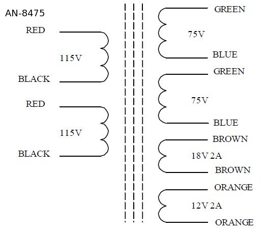

Power-Supply Transformers: Bridged Output Stages (2x)
The power-supply transformers for each half of the bridged output stage must provided by separate sets of secondaries; these power-supplies MUST "float" independently of one another. With the available product options, I've targeted a transformer that will provision +/-106VDC power-supplies in order to reduce the 6AS7 plate-dissipation to slightly less than 50% of the rated capacity. The combined peak current draw for each of the output stage power-supplies is 2.5A. The transformer I've targeted for powering the input/driver stage is:
The 75VAC secondaries will each be bridge-rectified to about 106VDC; placing these rectified power-supplies in a totem-pole configuration will result in a +/-106VDC@5.3A power-supply. Two such "floating" power-supplies can power up to an 8-tube 6AS7-based power-amplifier channel.
The auxiliary secondaries are not useful for powering the 6AS7 filaments, so they will be left unused.
The AN-8475 can be configured for either 115VAC or 230VAC primary voltages.

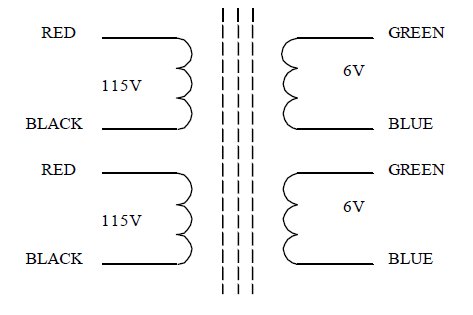

Power-Supply Transformers: 6AS7 Filament Supplies (4x)
To power the 6AS7 filaments, four low-voltage/high-current power transformers will be needed.
The AN-0506 is an 50VA transformer with dual 6.3VAC secondaries, each rated for 4.2A of current delivery. I've targeted a transformer that will provision two 6.3VAC filament power-supplies for the 6AS7 output tubes; four filament power-supply transformers will be needed in total for each channel (assuming eight 6AS7 output tubes per channel).
The AN-0506 can be configured for either 115VAC or 230VAC primary voltages.
NOTE: The effective "center-tap" ground reference will ONLY be attached to the "floating" output-stage power-supplies via the two 600-ohm resistors that bridge the power-amplifier output taps.

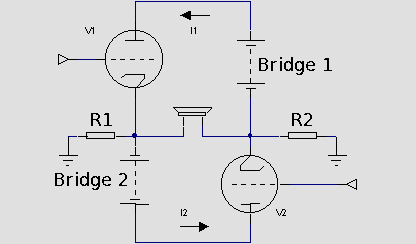

I have a little bit of trouble tracing the M-60 schematic so this may not apply at all.
But going back to the basic circolotron one tube does the positive one does the negative. you can typically place a ganged attenuation circuit on the grids of both stages this will change the volume in the circuit. pots are good for this. If it can handle the power from the driver tube you can use something like the lm13600 which i just found last night when doing research for my own project (an eq).
its a dual transconductance amp (current mirror). depending on how this thing is wired you may need to insert a coupling cap so you dont send B+/B- voltage into it.

Being a n0ob as I am there are still a couple embaressing questions left...
Looking at the schematics.
Where do you connect the Bridge1(+), Bridge2(-), Bridge2(+) and Bridge1(-)?
And, is the +/- 140V connected to the B+(2) and B-(2)?
I feel like such an idiot asking these simple questions, hate being a no0b. But if I don't ask I won't learn anything.
And, is the +/- 140V connected to the B+(2) and B-(2)...
MarkusG,
The M-60's fully-symmetric, bridged output stage hides a lot of sophistication in its apparent simplicity, making it difficult to see what's taking place until you can wrap your head around the whole thing. It's important that you clearly understand how the dual "floating" power-supplies for the output stage are integrated into the bridge circuit; let's use the simplified schematic (in which I've labeled the floating power-supplies to correspond to the labeling in the M60 signal-wiring diagram) that I've attached to this post.
The output stage power-supplies (Bridge 1 and Bridge 2) are each comprised of a +140VDC and -140VDC supply, which are stacked to provide a total 280VDC voltage source between the (+) and (-) terminals in the simplified schematic. The "ground" potential between these stacked power-supplies is never exposed or connected to any other point in the M-60. The "Bridge 1" (+) terminal is attached to the plate of V1, but the "Bridge 1" (-) terminal is attached to the cathode of V2. Similarly, the "Bridge 2" (+) terminal is attached to the plate of V2, but the "Bridge 2" (-) terminal is attached to the cathode of V1. "Bridge 1", "Bridge 2", V1 and V2 comprise the four elements of a traditional bridge circuit. In reality, each of V1 and V2 is actually made up of eight parallel triodes (four twin-triode 6AS7G tubes). Each of the power supplies (shown as "Bridge 1" and "Bridge 2") must be fully independent, with its own secondary winding, rectification and smoothing. This is the only real additional complexity of this output stage configuration, as contrasted with a more traditional push-pull output stage.
Since this is a differentially-driven follower circuit, the load (the loudspeaker) is attached between the cathodes of the paralleled output tubes. While the load is essentially attached to the -140VDC terminals of the "floating" power supplies, that voltage potential is un-referenced --- the output-stage power-supplies are "floating" with respect to any "ground" reference.
Under quiescent conditions, the currents I1 and I2 flowing in the two halves of the circuit are identical, so no current flows through the load. Resistors R1 and R2 (they're 600-ohm, high-wattage resistors) tie the two ends of the load to ground and ensure that they are at the same voltage potential. This ground reference is the only means by which the fixed-bias voltage (developed within the independent dual-rail B+/- power-supply for the input/driver stage) can be exerted against the output-stage vacuum-tubes, establishing the quiescent current for the output stage.
Take a moment to let your brain assimilate how the output stage components are interconnected to form a fully-symmetric bridge circuit --- there's a lot to consider. I know it took some time for me before I had that "Ah HA!" moment... 😉
BTW, there's some decent high-level background information on bridge circuits on Wikipeda; here's a good launch-point:
I hope that helps... 😀
