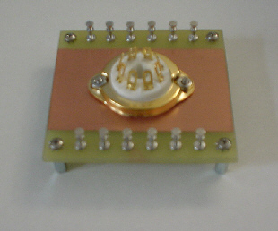

* Signal-Path Components[~$400] - I recommend following the best-practices used by Atma-Sphere Music Systems in construction and employ point-to-point wiring. To simplify and modularize the point-to-point wiring of the M-60, I suggest the use of single octal-socket terminal/turret boards such as the IAG TB-18's (Product Details) at about $17/each (see attached spreadsheet and illustration); we'll need 12 units per monblock (one for each tube). This approach allows us to pre-assemble each tube with the nearby components in the schematic, then simply install the "module" into the chassis. The pair of V-Cap Teflon coupling capacitors are an upgrade offered by Atma-Sphere and are used to bridge the input stage with the driver stage at almost $70/each. Add in the remaining Vishay precision metal-film resistors and Caddock metal-film power resistors, Zener diodes, film-type capacitors, etc., and we're up to about $380-$400 for the signal-path components (excluding vacuum-tubes). I use the usual suspects for DIY parts-vendors such as Digi-Key (DigiKey Corp. | Electronic Components Distributor | United States Home Page), Mouser (Mouser Electronics - Electronic Component Distributor) and Newark (US - Electronic Components Distributor | Newark.com).

Yes, I prefer to construct my DIY projects using a point-to-point wiring methodology. Those IAG single-socket terminal-boards really make the assembly straightforward as well as provide a really nice look-and-feel to the guts of our projects. The point-to-point approach greatly facilitates the inevitable modifications in a clean, non-destructive manner.
