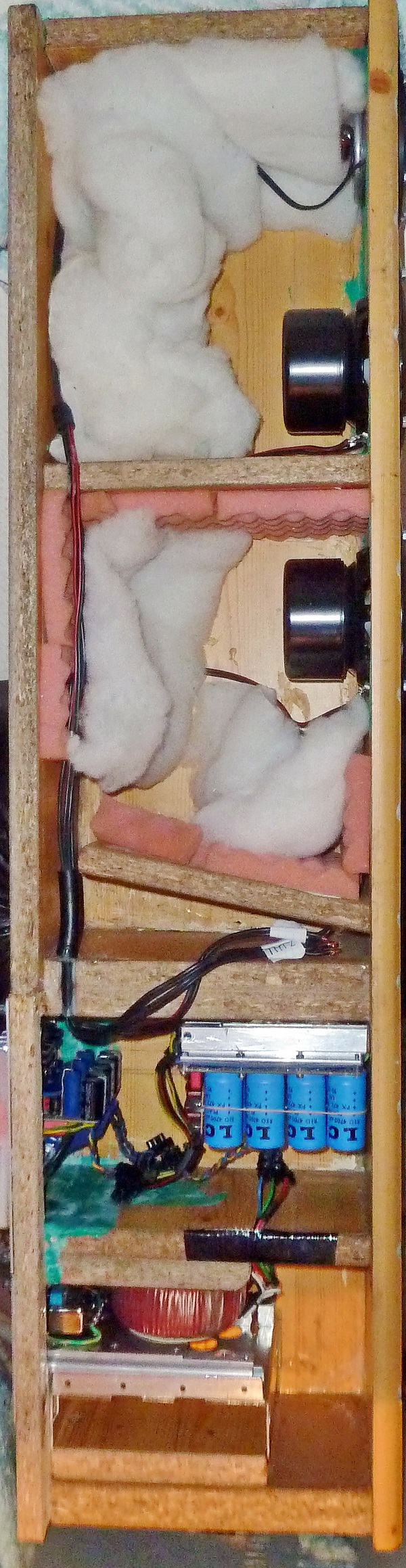

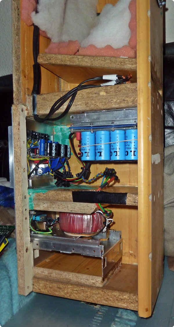

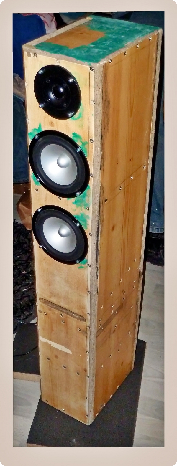

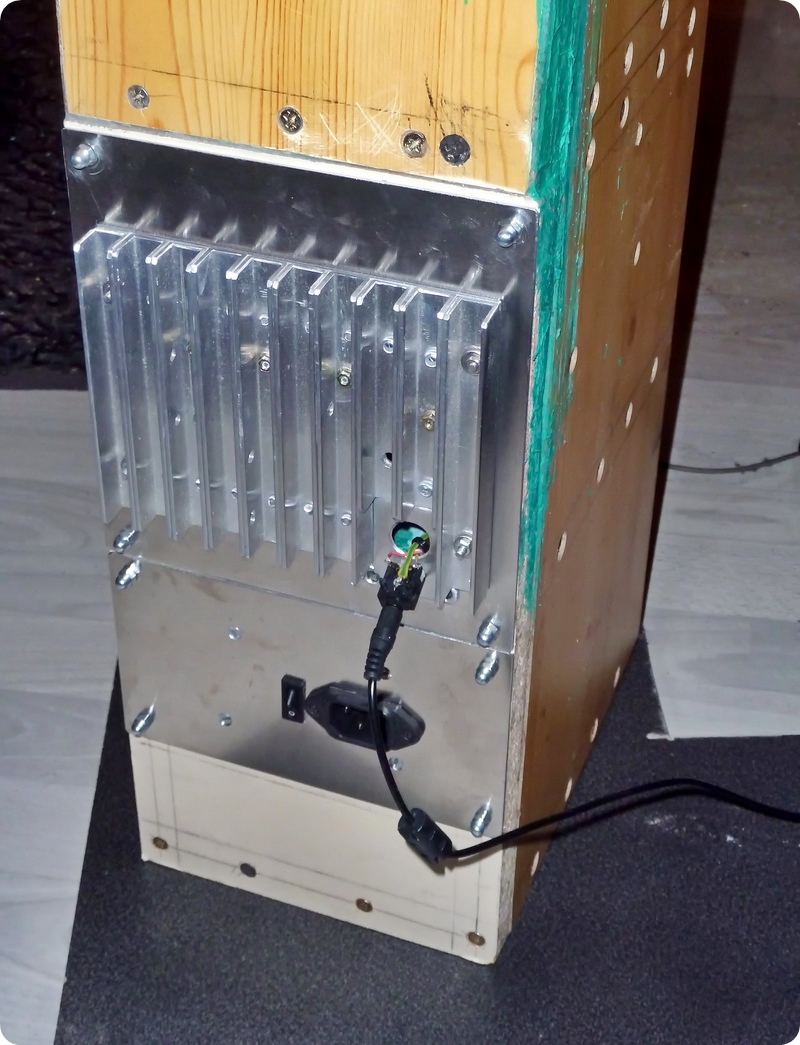

Hi people,
tonight I could try out my first box for the first time. It's not finished yet, and it looks pretty shabby because I'm on the lowest budget you can imagine, but it worked on 1st try and it sounds great!
For the moment I'm just using two of the three LM1875, because it has been weeks I was without music and so I just put a high pass capacitor in front of the tweeter. It will be activated in the next days.
It's 2.5 way all managed by Equalizer APO, one closed enclosure 8l for the first 5" and the tweeter, and 8l BR for the "half" way, the second 5".
It's still much work, but I'm really happy!

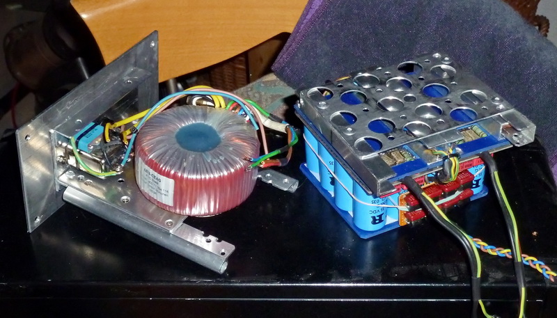

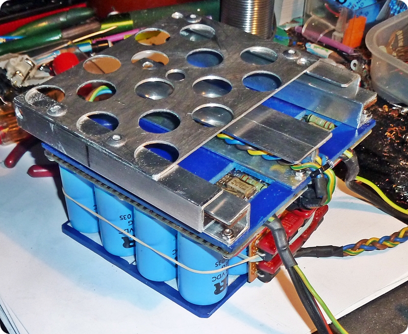

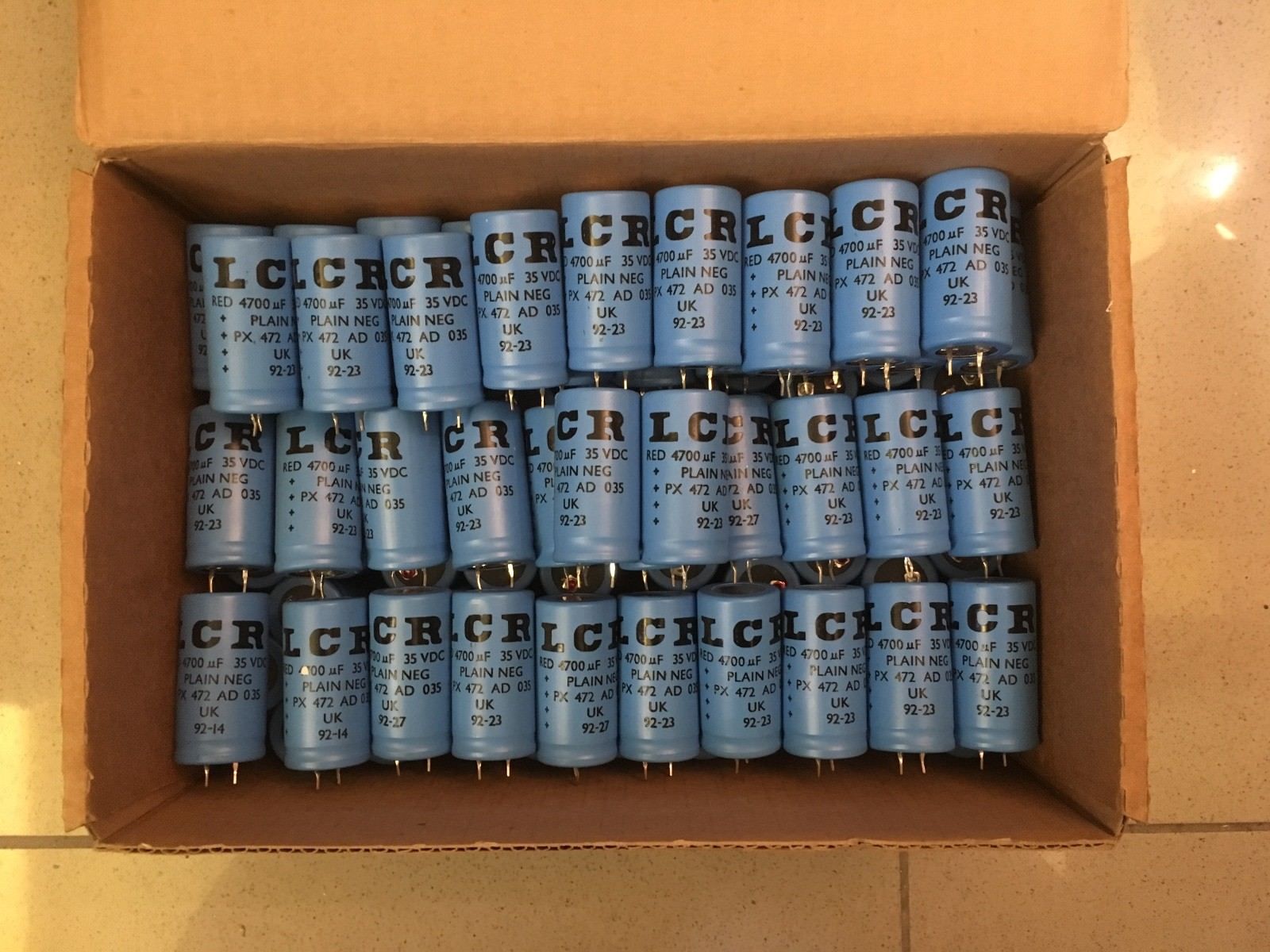

Impressive! That's what I call a capacitor bank. Sturdy construction. Congratulations.
Normally I couldn't afford these capacitors, but I was really lucky and shot 100 of these 4700µF/35V for 11,50€ at the bay.
12 Euro-cents a piece, that's a bargain.
