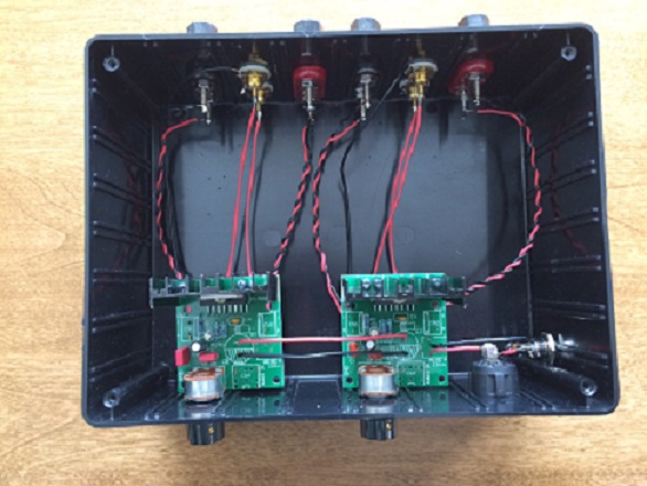

OK, here are some photos. The capacitor: it is hard to see the writing but the + as I understand it is on the longer lead.
RE: cap in holes 3 and 4:
The drawing indicates how I designated the holes, etc. And the + or - are showing how the two caps on the "master board" are oriented. In other words, the writing on both those original capacitors faces the chip.
I traced from pin 12 of the chip to hole #4 and the way the cap is oriented on the master board would make the negative lead of the cap - not the positive as you indicate - facing the chip.
I don't understand. Did they orient the capacitor wrong?
RE: cap in holes 1 and 2:
The cap for holes 1 and 2 seems to be correct. The writing faces the chip. In other words, the + lead on the cap at hole #1 orients towards/connects to pin #4 of the chip. (This all is as you said it should be.)
Mark

I assume the cap in the picture is the 1uf electrolytic? The caps installed on the board on not electrolytic, and therefore orientation is not important. I usually install then such that I can still read them, but that's my OCD.
For some reason I thought you were installing 10uf caps. I may have some 1uf Wima film caps I can mail you. I can check if you want.
I'm going to do some math using the 1uf value. Electrolytic caps can tolerate a very small reverse voltage for a short period of time.

Sorry...don't seem to be helping much. Here are my assumptions...
The caps that came with the board (labeled 224) are .22 uf non-polarized. Probably ceramic. The writing is probably arbitrary, as there is no + or - orientation. It can be mounted any way.
A tantalum capacitor is a type of electrolytic capacitor. Since the picture of your 1uf cap has "polar" markings, it must be polarized. You want to use it with an AC signal, which should be fine as long as the voltage across it is small relative to the caps maximum voltage.
You are going from a .22uf cap to a 1uf cap to reduce the -3db voltage point by 4 octaves.

Hi Mike,
Yes, yes, I did some reading and now understand that tantalum caps are indeed a type of electrolytic cap. Thanks for your patience and steering me in the right direction. Yes, you definitely are giving me a good education and I thank you for it. I don't know much. And, if it were not for guys like you, would know lots less.
Oh, I see. You say the original caps are ceramic and therefore non-polarized. Oh, I thought they were tantalums too.
Well, I don't know where I got the idea to use these tantalums. I know I read somewhere to try a 1uF value and probably somewhere else that tantalums "sound good". So, a rookie choice of parts I guess.
Mike, in your opinion, should I replace these caps with ceramic ones? And is the 1uF value OK? Or should I just put the original ones back in? Any suggestions?

I found some 1uf Wimas. I need to desolder them from a test board, but they should be good. PM me your address, and I'll mail you a few. No need to reimburse for the price of a stamp 😎
With the original .22uf cap, your -3 db point will be around 24 hz.
A 1uf will be fine. Your -3 db point will be around 5 hz. At 20 hz, it will be down .3 db. Would be amazing if your speakers were that good!
Mike

Do not put electrolytic or tantalum capacitors on the signal path. It is best to use block capacitors (such as Wima).

Have two of them in a Radio Shack project box. Bi-amping my Klipsch K-horns. Crazy good!

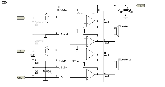

Does anyone have a suggestion for a "better" capacitor where that original 10uF one is on the board? It's the far left cap.
Is that one in the signal path?
I put a higher value (50uF) one there. It, like the original, is an electrolytic. I'm wondering if a higher quality one would net me anything.

Hey Mark
As I understand it, the purpose of that cap (and the two 47k resistors) is to prevent turn on pops. When the amp is powered on, it delays the voltage to the standby and mute pins long enough for the power supply cap to charge.
A larger value will only help if you were getting turn on pops with the 10 uf.
I don't think it affects turn off pops (I get those, albeit not really loud), but it would be interesting if you noticed a difference with the 50 uf.
They are not in the signal path.
Mike

I thought there was something odd about that board. Usually there are three resistors. Two for the mute/standby circuit to help with the pops. The third is the current limiting resistor for the led. Hard to tell, but they may be sharing one of the two "pop" resistors for the led resistor. Are they both 47K? They should be positioned in the attached schematic.
The 104 capacitor should be parallel to the power capacitor, and I believe it's there to remove high frequency noise from the power supply. I've heard it said that, with a clean PS, it can be removed.
Mike

100uf not bipolar is a better option for less turn on noise. Quality is pointless.

Thank you, fellows, for the explanation about the 10uF cap. Yes, once I saw the schematic MBoxler posted I see it's part of the mute circuit.
Not much turn-on/turn-off noise on this amp to begin with so I guess the 50uF I put in will suffice.
