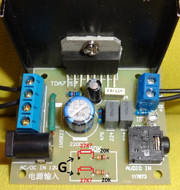

Just bought this little amp and doing some mods.
I removed volume pot and wondering how to set up the volume to about half the pot scale using resistors.
Can someone tell me if i need to solder 4 resistors or only 2?

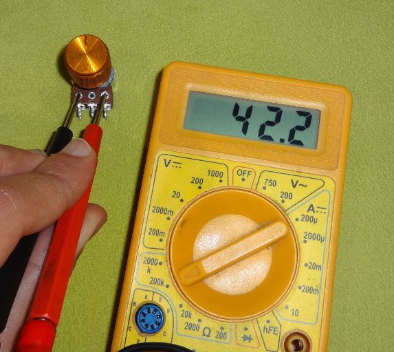

Two resistors per channel, thus four in total. If the potentiometer is linear, all four resistors have the same value. If the potentiometer is logarithmic, the resistors with one end connected to ground should be larger in value than the two other resistors.
NB: Turn the potentiometer to about half (12 o'clock). Measure the resistance value from the left terminal and to the middle terminal. Then you have the resistance value connected to signal ground. Then, measure the resistance value from the right terminal and to the middle terminal. Then you have the resistance value connected to signal input.

Keep in mind that "left" and "right" depend on whether the pot shaft is pointing towards you, or away from you. Also, on whether you hold the pot with pins pointing up, or pins pointing down!Measure the resistance value from the left terminal....right terminal...

True, as shown on the photos posted by "radekcga".

Thank You.
It was linear pot.
I've set 18k+27K per side and seems to work fine, a bit louder than my second 20dB gain amp

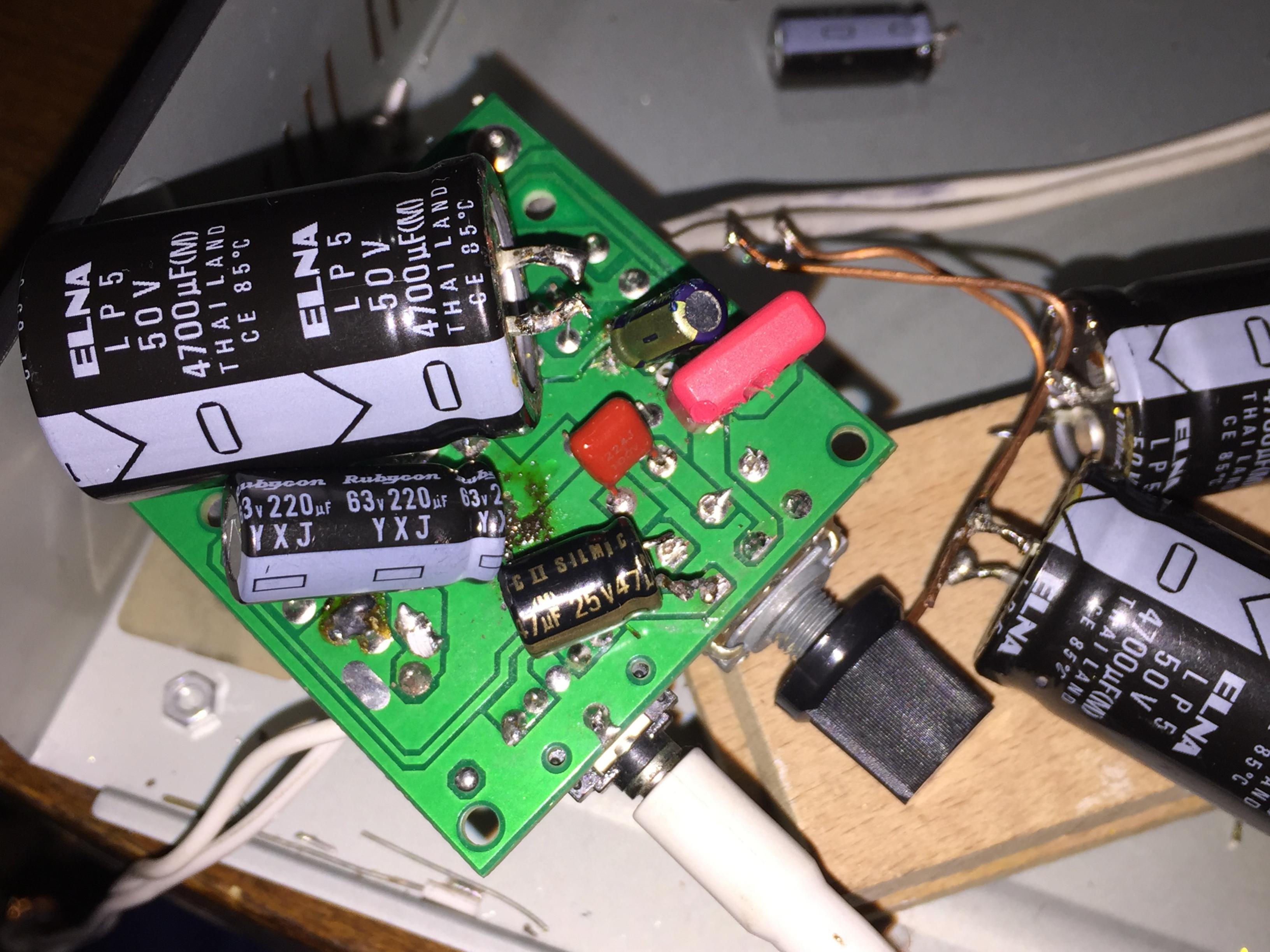

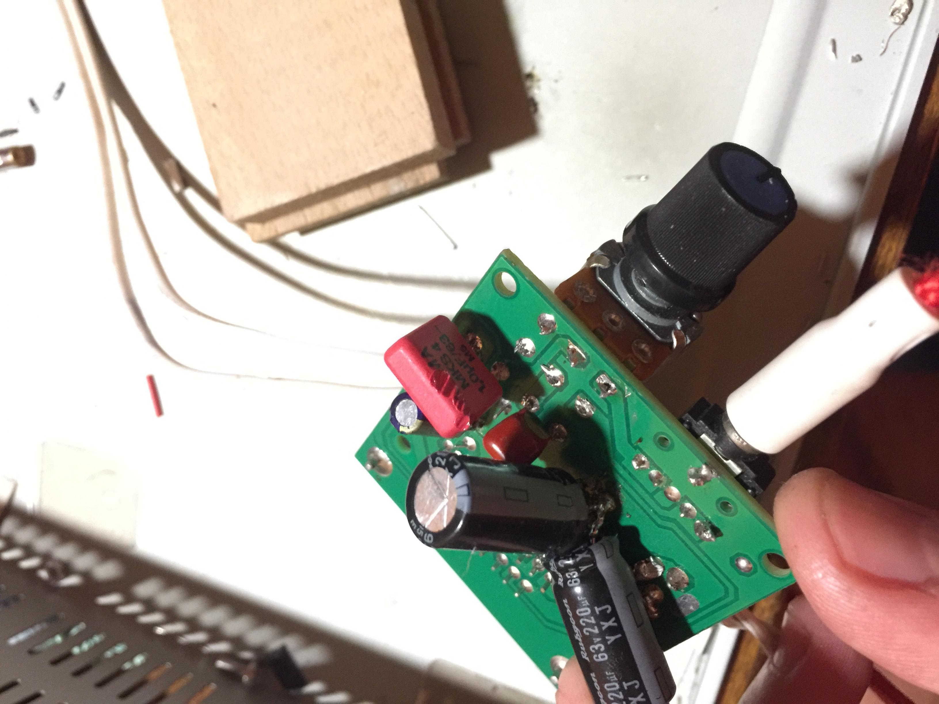

I have tried Elna 4700uF instead of stock 2200uF, not good sound and Rubycon 220uF😄 too much midds.)I didnt have others.

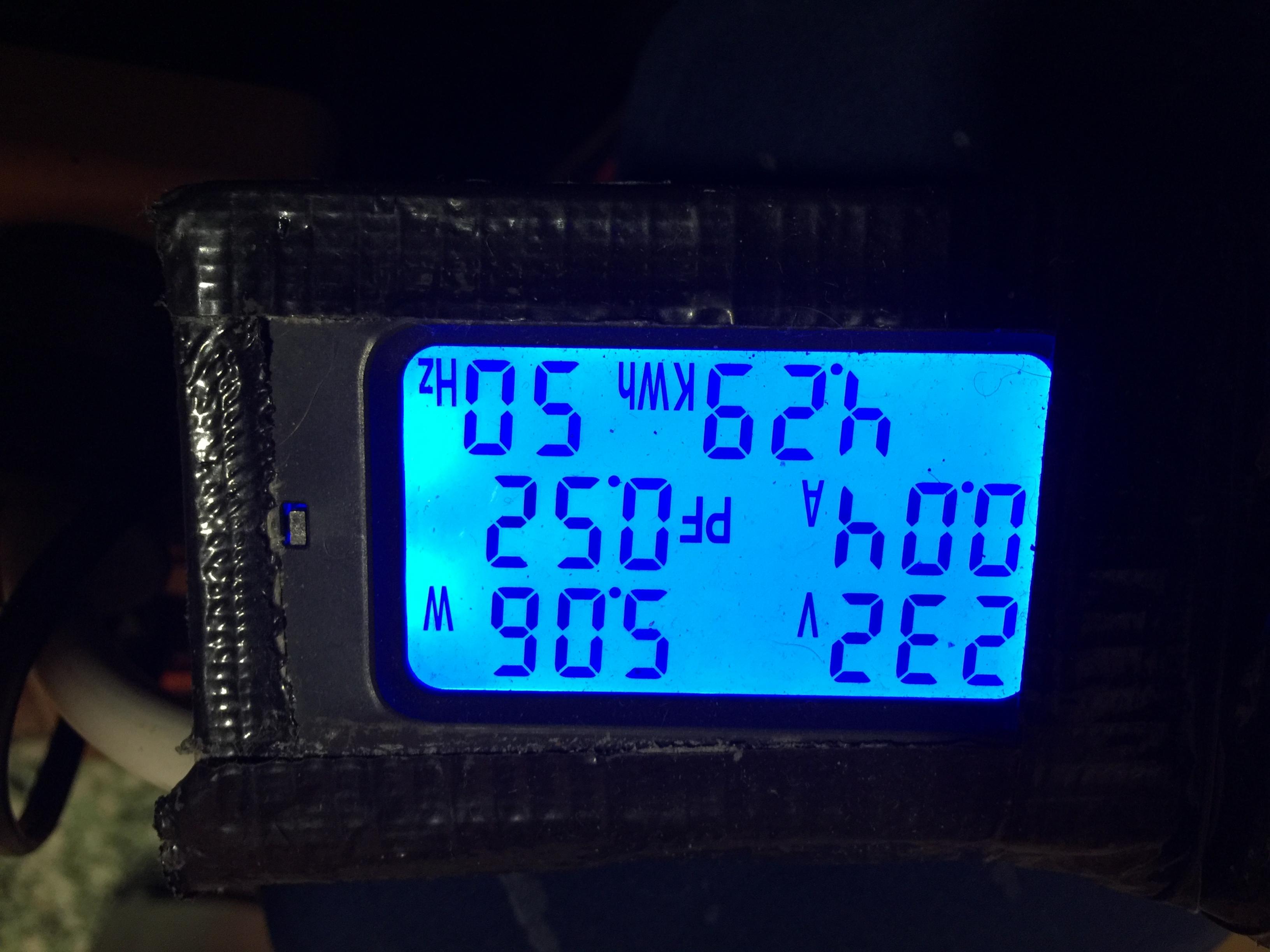

Im testing one 4ohm speaker on one channel with amp consuming around 5W so I dont think there is deficit in current right now, even with two speakers it should be enough for normal listening to music. Crappy power supply is MUST as I said, there is good reason for that, so I must pull out decent sound with what I have to.

Why is the 47uF electrolytic connected between the L&R inputs at what appears to be the volume pot?
