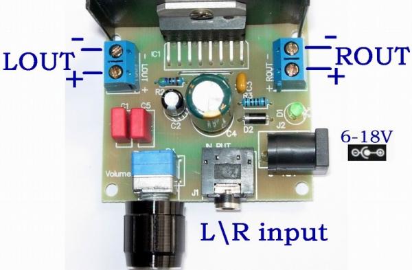

Hello,
I'm somewhat late to the party, but reading this thread made me try this little amp - I got two of them from the usual source (ebay).
I already have a modded Sonic Impact T-Amp, and I like it - but it could definitely use some more "ooomph" 🙂
So, I thought I'd try this little bugger...
Got two of them a couple of days ago, and after several hours of listening, I must say I'm not really impressed.
Namely, I'm using stock amps, no mods yet (see attached photos).
The problem is that the sound is rather "flat", no real precision, separation or "3D" stage - unlike what I'm used to with my little T-Amp.
Also, it looks like the sound is distorted in some more dynamic passages, like piano (e.g. the piano intro in Tord Gustavsen Trio "Edges of Happiness" suddenly has harsh and distorted peaks), even though the pot is not on full power (about half, i.e. about 12 o'clock position).
I'm connecting it to Infinity SM85 speakers, very efficient and sensitive (98db), and feeding it from my Squeezebox Classic - the same setup I'm using with my T-Amp when comparing the two amps.
I'm powering the amp using the ordinary laptop "brick", 12V, 5A. I also tried swapping several other 12V "bricks" I have, but no real change...
Now, I presume that all of the above could be improved. Could it be the pot? It's OK otherwise, both channels are equal, no complaints there.
So, should I try the usual: first the pot, then the caps, if that does not help?
Or am I expecting too much? 🙂

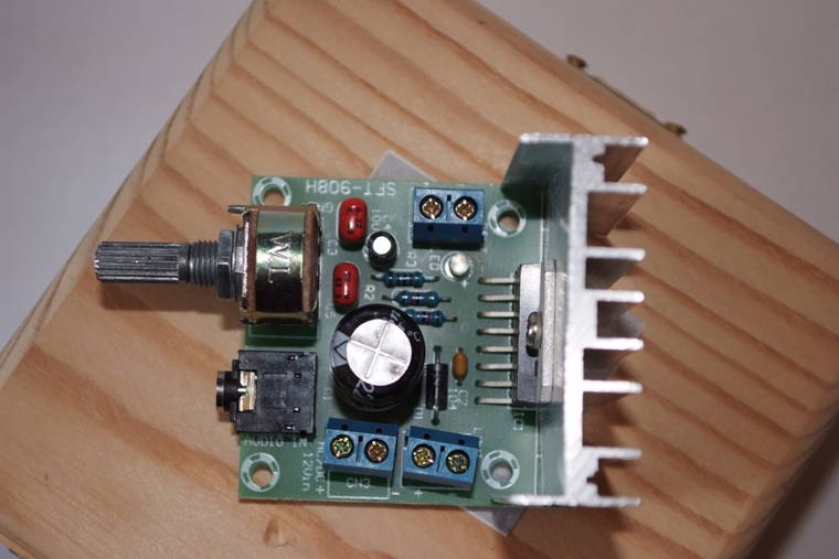

Well, after a couple more days, I can say that the amp sounds OK.
But, I have another question: I bought two more as kits - the same kit as in post #231.
I soldered those, and both kits have a problem, namely, unlike the ready (assembled) amps, these exhibit a high-pitched "beep" when connected to input signal (Squeezebox classic). If it were just one, I'd attribute it to my poor soldering skills, but the other one was assembled (soldered) by a more experienced friend who's quite experienced with a soldering iron.
Could it be a design fault for this board?
Anything I could do to improve this and get rid of this "beep"?
Again, the two already soldered amps work as expected - no hiss, beeping or any other noise...
But, these two both produce high-pitched "beep" when the volume is turned up (e.g. to half volume...). I've tried different power sources - no change (except a slight change in pitch of the "beep"). The other two (already bought soldered) amps show no problems with the same power sources.
As a note, I've used the stock components that came with the kit, as seen in the attached photos.

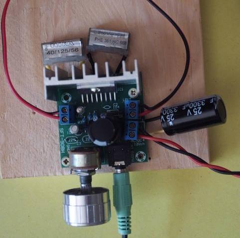

Sounds like feedback. You MUST route the output cables well away from the input ones. Could be fake chips I suppose 🙁
I don't know about fake chips - although the chips did look like they had a long and unhappy life which they spent in another device before I got them 😉
As for routing the cables, I'm using them in exactly the same way as the other (assembled) amps - and those do not exhibit this problem.
No big deal, I'll probably use these two for parts, but it bugs me... I'd like to know what's happening, and what's causing this high-pitched whine...

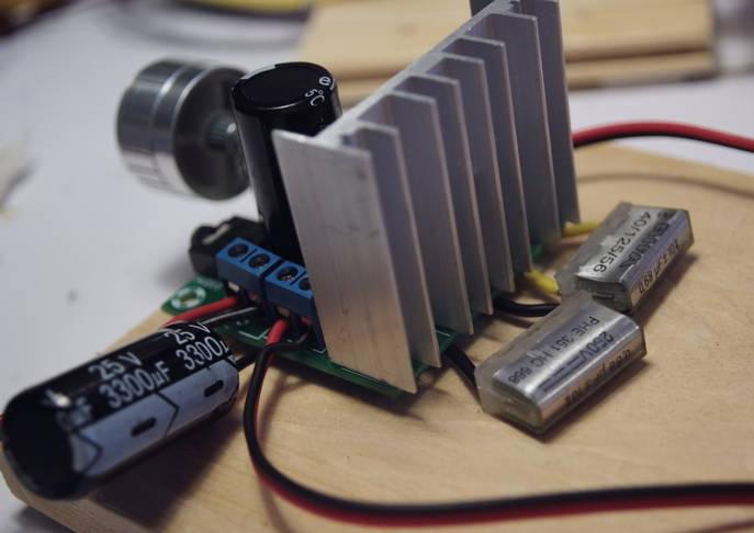

I think I'm about done with mods - tried several suggestions, some also from another forum (audiocircles)...
Anyway: removed the diode and bricked it, also completely removed the C2 little yellow capacitor - which resulted in definitive improvement of sound (no ringing any more in the upper registers!). In the attached photos I'm also trying out some RIFA 0.68uF caps that I had on hand - which resulted in some "fattening" of bass 🙂
Also, very important mod - adding a larger cap on the power input: I just soldered a 3300 uF cap on the "+" and "-" contacts of the power connector - which also improves bass. In short, as it is, it sounds quite nice - no complaints any more 🙂
I'd dare say it's quite comparable to my stock TDA3116 YJ 2.0 red board...
Oh, and changing the power supply for another "laptop brick" SMPS also improved the sound a bit (12V/4A)...
