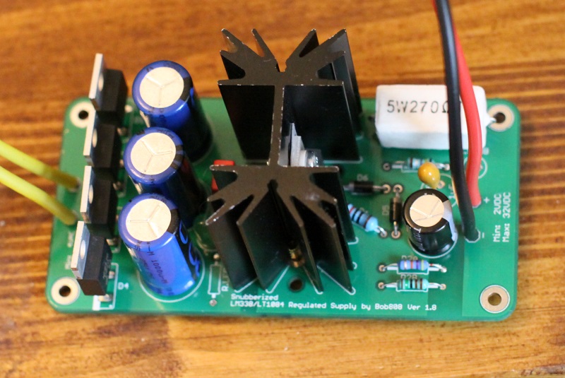

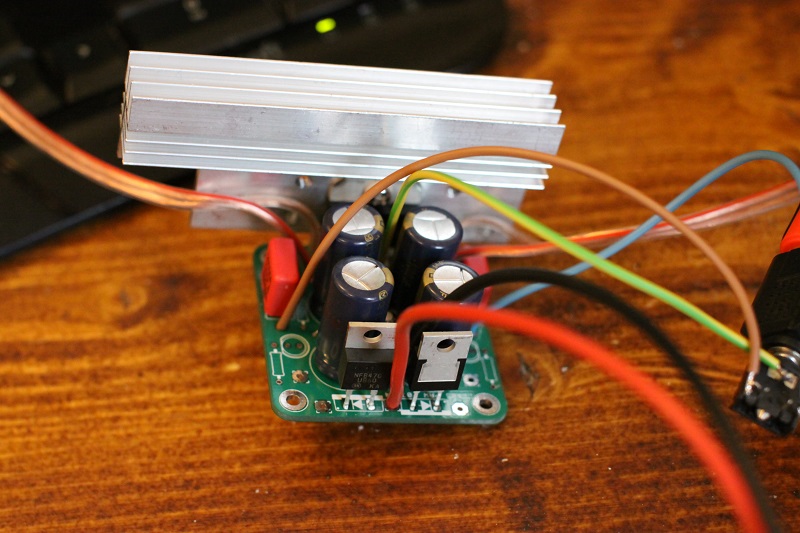

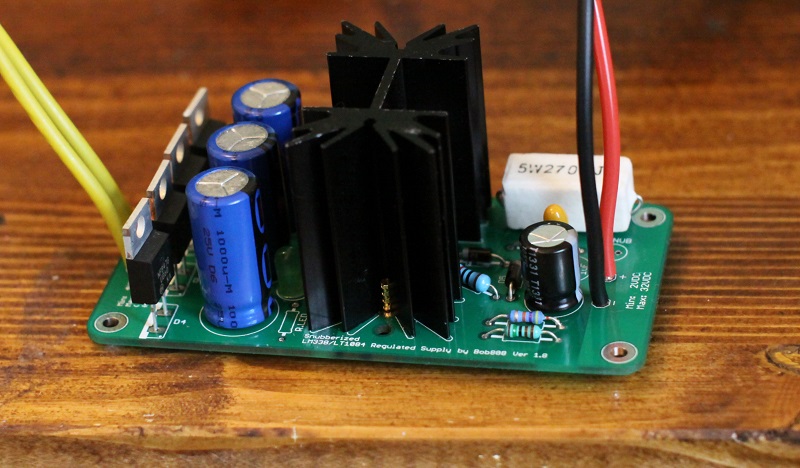

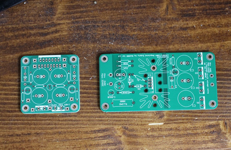

I received my boards 😀
I populated one set and sang at first try. I'm feeding about 16V on each rail.
Sounds very nice but I didn't have the time to do proper listening. Also I want to measure the supply for noise and ringing. I did not install the snubber capacitor yet, and the LED I chose seems real bright so I had to disconnect it at the moment. I will try less current.
I've used a LM338 but I will replace for LT1084/LT1085. I'm using a 16VAC/5A transformer. The amp definitely has more omph than the ta2020.
* I noticed that I've installed 25VDC capacitors on the PS. I must have mixed them for the amp ones last night as I was tired. 25V capacitors with 16VAC supply is right on the edge. The ones from the amp are rated at 35V so I will swap them later today. So it seems I did make a mistake 🙂

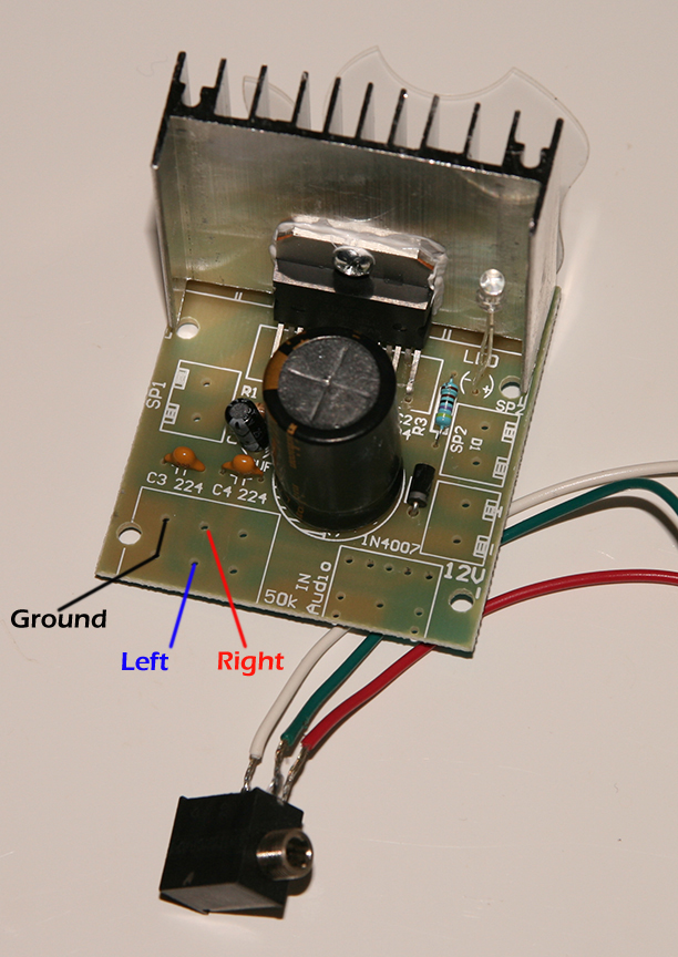

oops- I forgot to ask if I'm right to connect the 3 wires to the front 3 holes on the board and ignore the others 😕😱

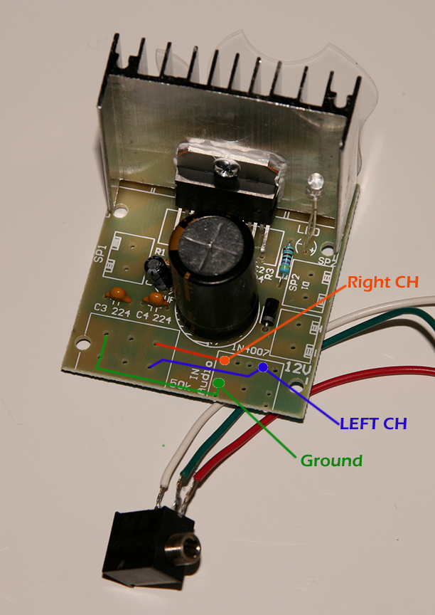

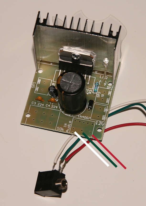

I am putting together this little kit and need some help for wiring up the audio in.
Any help would be most appreciated 😀
cheers
Thanks kja- but that side is for the pot. The right side is for input.
cheers
Sorry, I assumed you were not using an on board pot since it was removed.
My diagram is correct if you are using the 7297 as an amp with no on-board pot.
Hi kja- I hadn't put the pot on the board when I took the pic. my bad

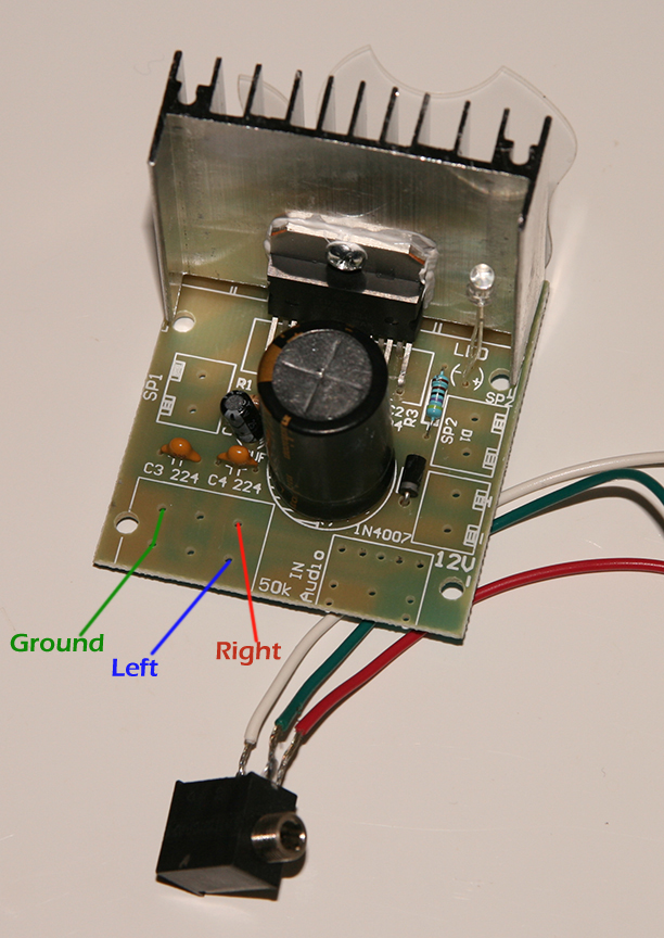

I'm not sure the three wires of the input go.
cheers
cheers
cheers
Follow the traces on the back of the board to these spots where the pot is installed.
I thought it would look something like this 😕
No, more like this.... double check to see that the traces on the bottom are like I've shown
