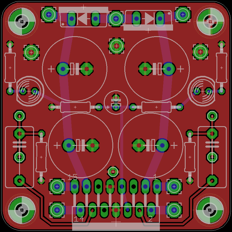

With the help of Daniel I managed to improve the board, and make it smaller at the same time. Should cost little to produce and the design looks real good.
Now, at first I will produce a few boards and if it checks out ok and I like the sound I may consider a group buy. There's still the psu board that I have to finish, I've implemented a tracking pre-regulator into the design but still have to sort some things out.
Meanwhile, a preview of the amp board. It is 5cmx5cm, the input caps are a maximum of 10mm pin distance and also fitted with 5mm pin distance. The power caps are 12.5mm diameter and 5 mm pin distance. I guess you could fit axial input capacitors in there but you'd have to secure them somehow if they are larger. Will check when I get the board.

No problem, I could just connected some wires in air if need be 🙂 I will try to sort it out tonight and see what I can come up with. The initial idea was to keep the Signal GND pin in air and connect via a wire to a different GND point on the PCB, but now I have to take the two resistors GND connection into account as well.

I basically want to make a board that fits my system and sounds nice/(er than the Chinese version). As I desoldered the parts from the Chinese board with my desoldering station I managed to rip one trace. It seemed real flimsy and thin. I really don't trust the board. Since I'm a diy guy I figured I'd make a better one keeping in mind some general ideas about board layout vs SQ. Daniel was nice enough to help me with knowledge in this regard.
Also I added some options for testing, like dual rail supply, parallel input capacitors and 5/10mm pin distance for signal capacitors. Since this is a cheap mod (compared to the type of capacitors one could install into any amp) a 4-6$ pcb is really OK. And it also fits the diy spirit perfectly. Off-course, it could sound worse than the original pcb, but I figure I have a pretty good chance of it sounding better. This way I could experiment with different electrolytic sizes/capacitance and input caps. What I'm doing does not guarantee anything for me, but I just try 🙂

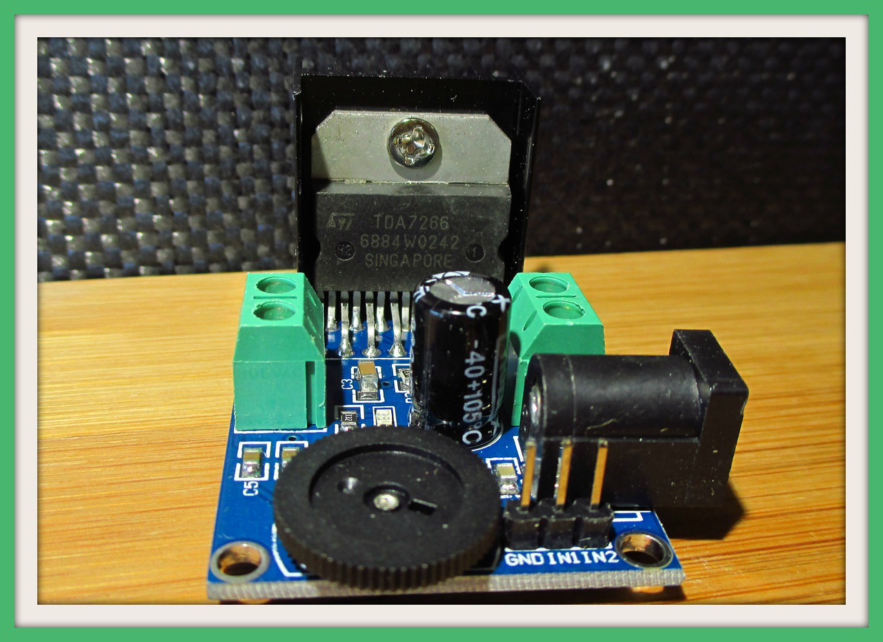

Been a while posting here. I'm still enjoying the 7292 amp. I do have a question and have not been able to find an answer.
The amp is already bridged, but can I parallel them together to get more power(sort of the same idea of paralleling few LM3886s together). i.e. parallel the two outputs spk + to + and spk - to - ? I intend to keep the input caps to isolate both channels' inputs. Of course, datasheet doesn't say anything.
I soldered additional cap to the power supply pins of tda7297 and forgot to check the soldering by multimeter, turn-on the module, a slight 'pop' and then silent.....
A very small solder spill over to the output pin after I used a magnifying glass to check... Lucky I got another one to play around.... If you soldered directly to the pins, please check with multimeter before turn-on 🙁
Gel Flux (petroleum flux) can help prevent accidental solder bridges.
However, generally, your idea is a good one--perhaps a 220u~470u installed parallel with the power jack (or closer to the chip), might improve the imaging. I haven't checked that simpler method yet. There could be some labor choosing models of caps that don't conflict despite one much larger than the other.
