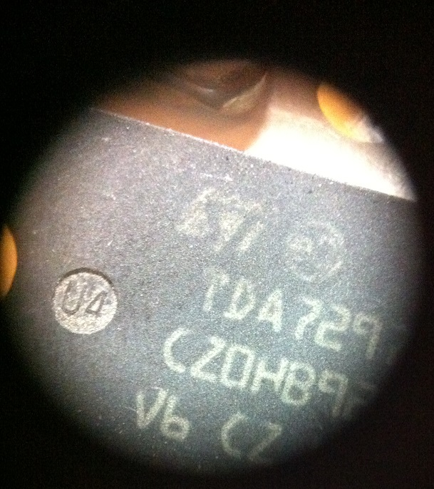

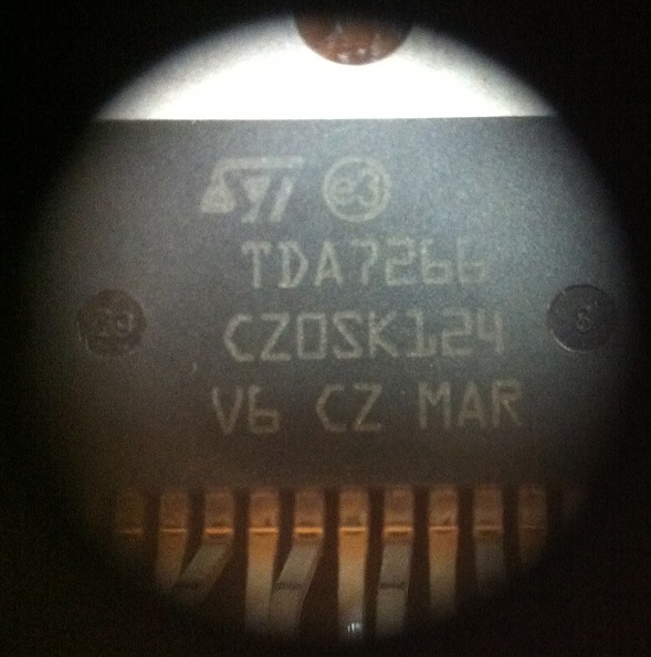

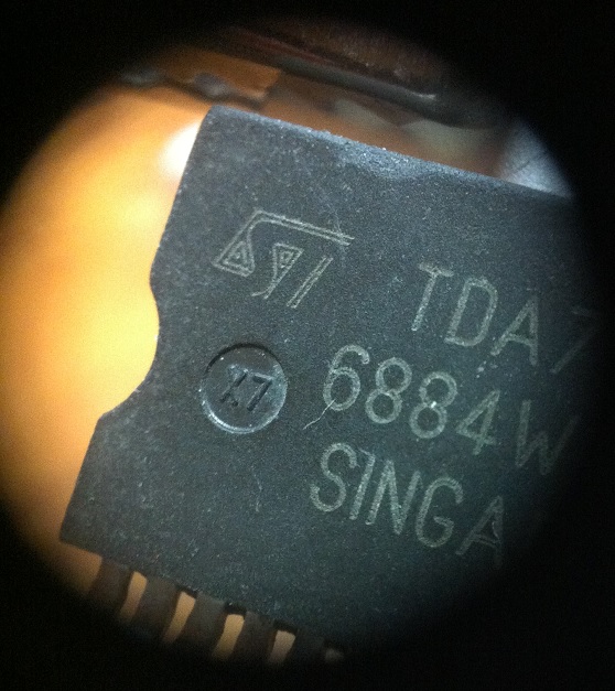

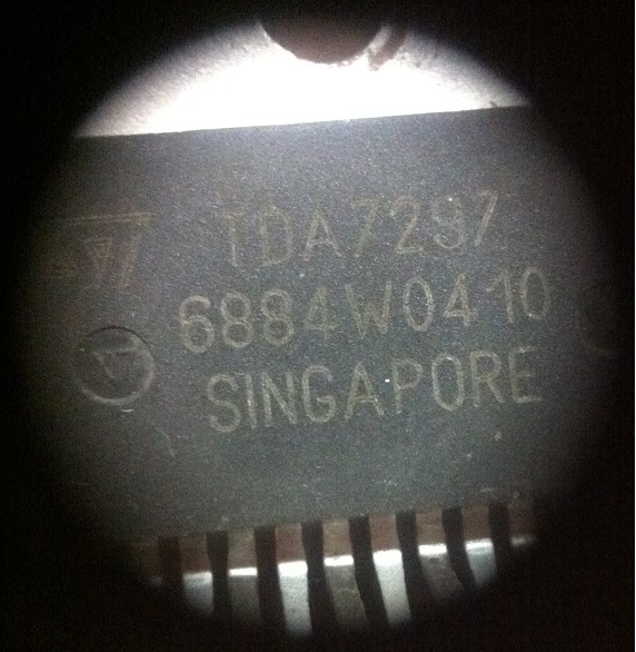

While waiting for my boards I decided to get a few more tda7297 chips, so I found some at a local supplier.
Upon closer inspection I found something interesting. The chips are marked different. The font is different and also the one that came from ebay has Singapore written on it. Logos are different marking style as well.
Did I get ripped off by my local supplier or is this thing normal?

After doing a bit of research on this subject I suspect that the ebay chip might be an improper called "fake". Better call them "rejected" production parts, as in they don't pass quality control. Basically they are thrown away, but somehow they end up on ebay. I was really squeezing my head trying to figure out how do they manage to make a profit on a 3.49$ device. There's the pcb, 3 connectors, one pot, heatsink and IC...and labor. I always discarded the chip itself from the calculus. I guess that's where they are making the profit actually, not on the other parts.
I'm saying it's not fake as it's working, and seems to be on spec as power output, so I guess that the risk here is getting a sub-standard chip. I am not even considering putting that chip into the new pcb.
This also explains my TA2020 amp. I also got a chip for backup some time ago and I saw that the writing on it looked better. The one from the ebay amp has perfect white writing, like silkscreen or something. I must find the time to replace that as well, I am not even going to consider ebay audio IC anymore. It's not worth the risk.

The datasheet doesn't seem to include marking layout. You might email the
pictures of the chips to ST Micro and inquire. Manufacturers are usually
interested to know if there are counterfeit parts out in the wild.
FWIW, the farnell pic looks like your first one:
TDA7297 - STMICROELECTRONICS - AMP, AUDIO, 15W, AB, MULTIWATT15 | Farnell UK

The item that I received is authentic ST. It is too cheap to fake. 😀
There is a higher power and a lower power version available in a different package. Both are ST.
Well, I just stated that they are not fakes in the real sense of the word, but parts that have been discarded by the production house as they are sub-standard. I guess it would be real expensive to acquire the tech necessary for them to clone something like this.
I'm only saying that it is a big chance that what we got from ebay might be a component that didn't pass the main producer quality standard, and have been discarded. Sure, they might sound good or behave properly but that isn't a guarantee that the part passed quality check. They could fail faster or even sound worse than a part that passed the quality check. Not counting the ones that let the magic smoke out. Electronic parts need the smoke inside or else they stop functioning as soon as it gets out 🙂

Regarding the printing, I still think contacting ST Micro is a good idea.
Who knows, perhaps the different chips came from different FABs
that print things differently? (The datasheet contains no info on the
parts marking, unfortunately.) ST Micro should be able to tell you that.
If the die inside is a real but substandard TDA7297 not meant for sale
then ST Micro has a problem in its FAB and disposal operation. If it's
a complete fake then there are counterfeits. Either way, they probably
would be interested in knowing.

For the Multiwatt 11 and 15 the 6" wafers are manufactured in Singapore and assembled in Morocco and China. This would explain the different markings.

This is certainly a possibility! I just sent an email to STMicroelectronics with pictures and all. I will post their answer on this matter.
