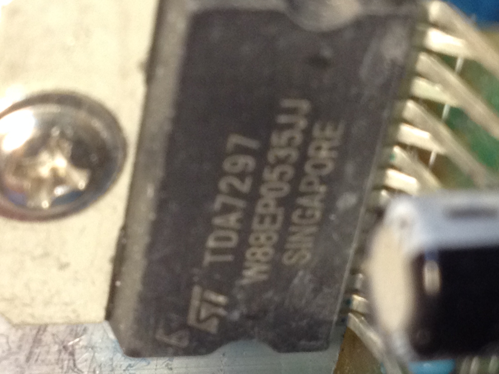

Are these esd succeptable?

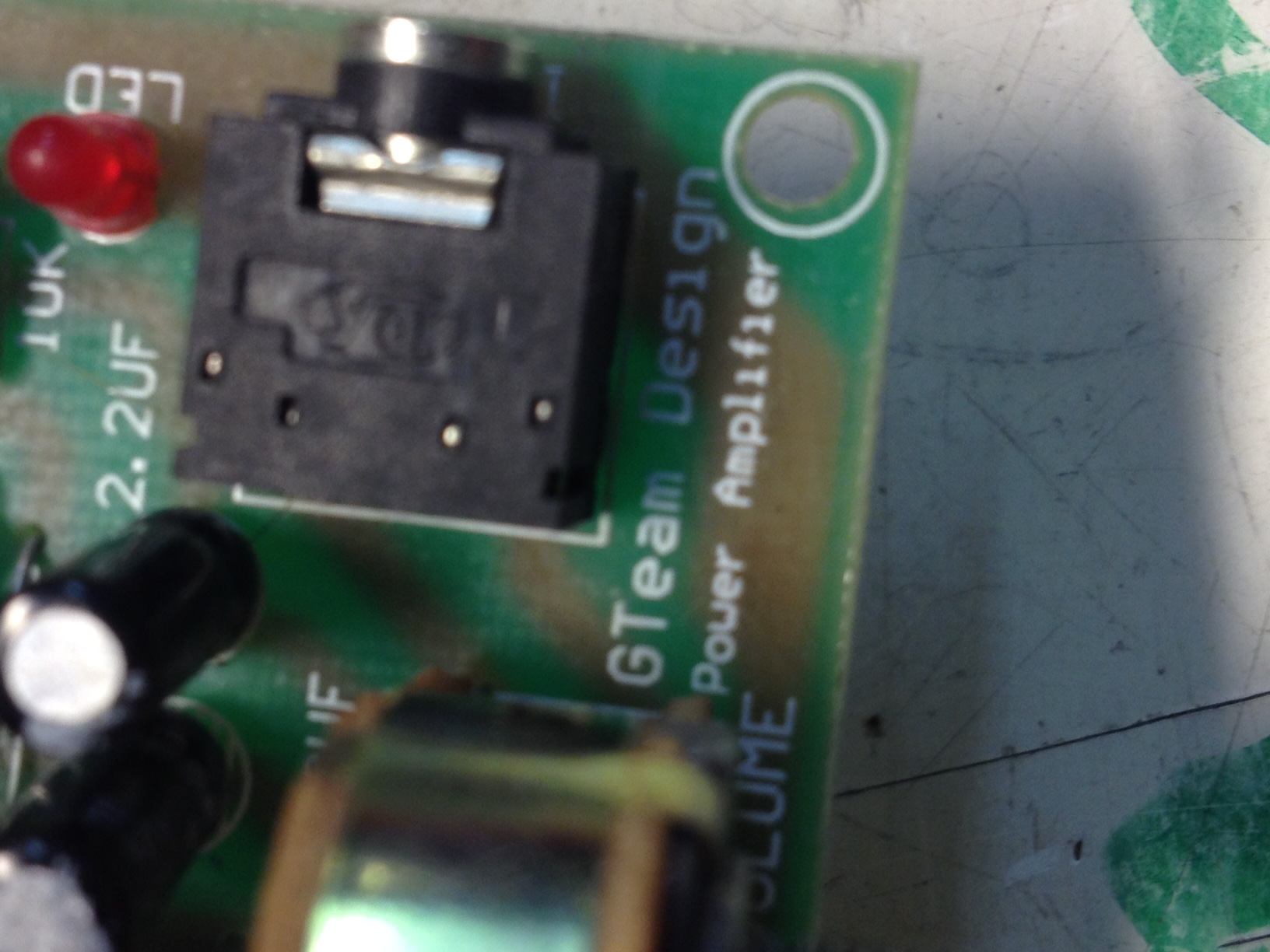

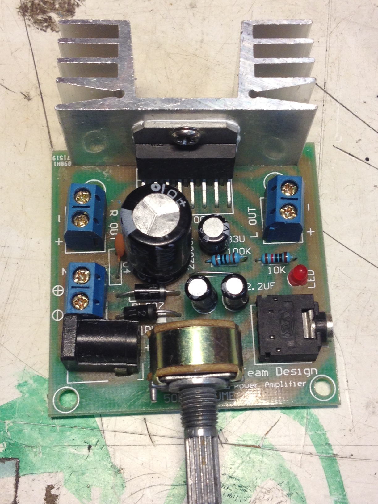

After waiting for 5 weeks, mine arrived looking good.
No sound during a quick test this morning, however, using one of the outputs.
Would the pot be the first item to suspect?

Well it turns out that the terminal marked + was connected to pin 8, pretty much the opposite of what it should have been.
Made some normal music until I went and bridged the input caps, swapped in better decoupling and bridged the diode, now it has a nasty hum, no music.
Hum goes away when the input connection to the pot is open, after un-doing the changes.

16v is better, nice sound, doesn't blow up. The ST chips from mouser might actually take 20v on a very good heatsink. The China chips blow the **** up at like 18v.
SG and PG have to be connected at some point or you won't get any music. (signal and power ground)

Thanks, it's strange that - according to the st data sheet http://www.micropik.com/PDF/TDA7297-datasheet.pdf - distortion vs. output power 5W: 12V is about 1% ati 15khz, but with 16.5V 0.4% at 15khz (I think 5W should be enough to me).
They say that the Max. Total power dissipation is 35W, what does it mean for a 5W output?
I wouldn't worry about the dissipation figure. Put it on a good heatsink so you'll get the available power. You don't "need" more watts but available current capability is important and related.
I've really been working on getting this board to sound very good. It has some limitations, but thus far every step puts thing into a pretty stupendous sound. It's lively and with authority. Getting the refinement has been the big trick.
Right now I'm running a 10nf in series with 500ohm resistor right off my speaker terminals, parallel, and it made a very nice difference in the bass. The amp sinks too much current into the resonation of the speaker cable otherwise.

I've found out that it needs a zobel, and resonance dampening is ok on speaker cable. The bigger upgrade was using a balanced XLR cable so that the shield can be drained.

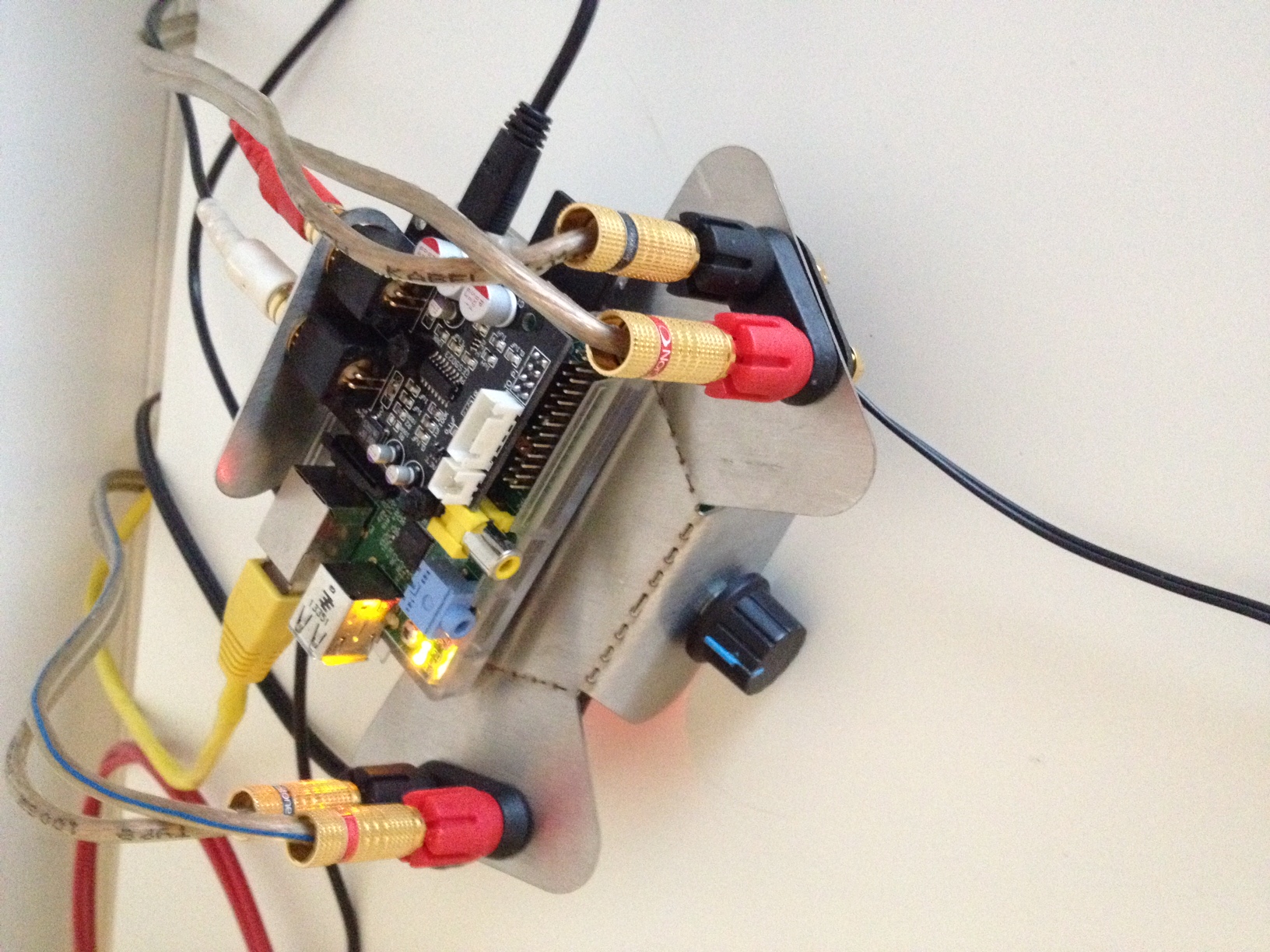

Got one too
.. actually, got two (one works really well, the other makes a lot of noise) anyways... it is a GTeam Design TDA7297. Mounted it in a metal object I had lying around and put a Raspberry + DAC on top of it. Makes quite a compact streamer 🙂
