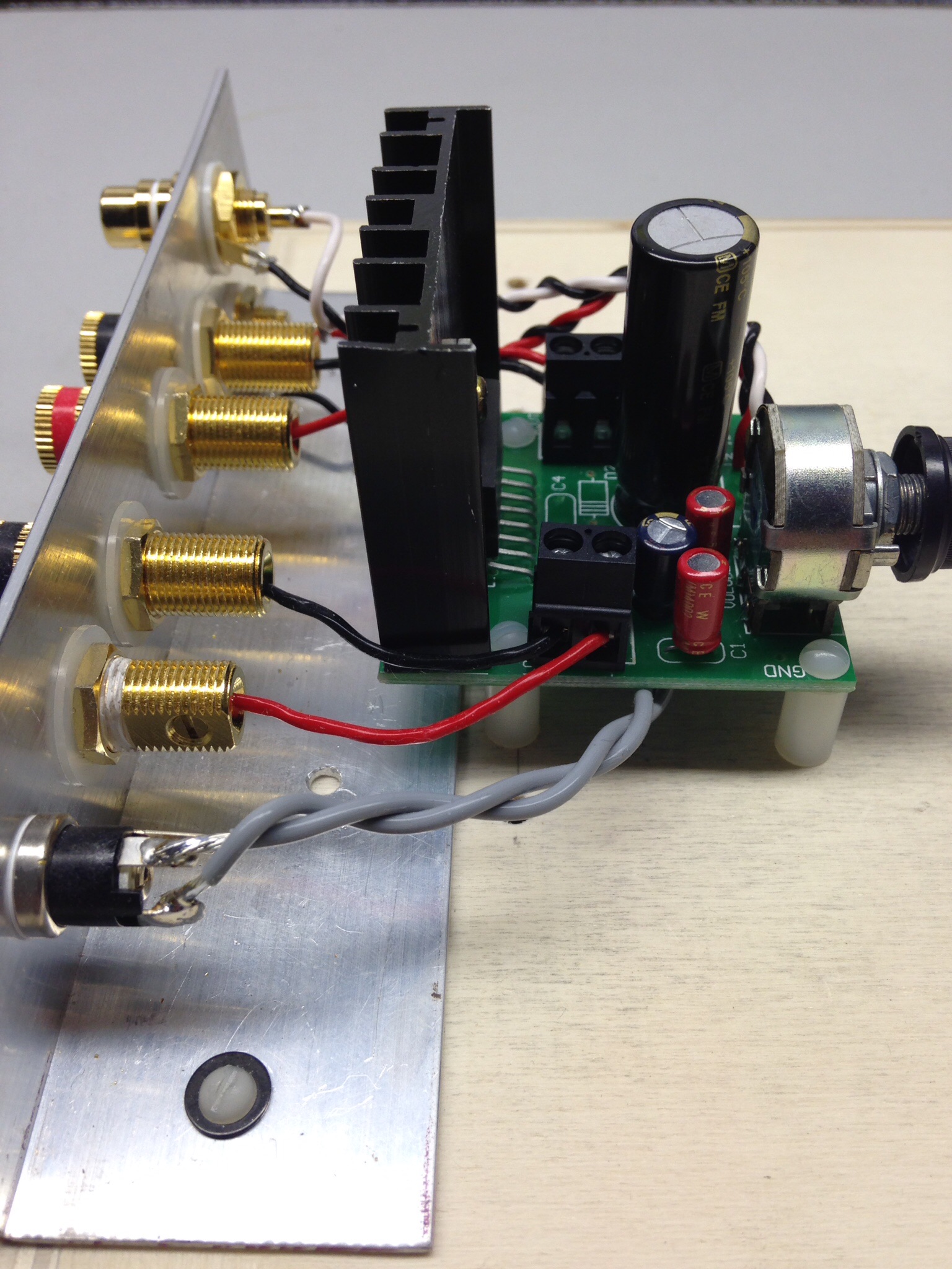

I'm actually having cross channel issues with my eBay TDA7297. Especially on certain piano notes it's loud - it sounds like buzzing.
I attached a picture of balance settings. PC is a source, I tried two different sound cars, same issue. When L channel is at zero and R channel say 33 in balance volume settings I can hear in the left channel the distorted version of what I'm assuming is the right channel.
Same thing the other way - I can hear sounds from the R channel when it's at 0, while L is on high level - however, audible buzzing on the right channel is not as loud as in the opposite situation.
I can't hear this cross-talk/distortion through the headphones in the same PC output at all.
I have following slight modifications on my eBay board:
- removed the pot, plus I added 47k input load resistors (in to ground)
- bypassed diode with solid copper wire
- replaced the stock power cap with an array of 5x470uF+1x2200uF (generic caps..)
+ I kept the input jack connector
Can you help me troubleshoot this? Where am I getting the cross talk from?

Salis, would it make sense to turn entire left section with the input caps 90 degrees clockwise? That way the inputs could be closer to the chip and traces a bit shorter? And possibly it would give you more space for longer input caps, without making the pcb bigger.

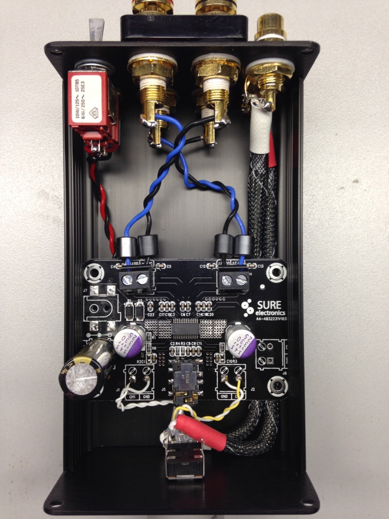

While I wait for my Digikey order to complete my DUG TPA3116 PBTL amps, I pulled my TDA7297 chip out of storage to play around with it.
This little amp rocks. I will have to do some head-to-head comparisons to my heavily modified Yuan Jing TPA3116 blue amp with CineMag input transformers. This is the best I've heard this little chip amp sound, and it might give my Class D amp some competition. I'm using this amp with the same modified Astron RS-12A regulated linear power supply I've been using with my TPA311x amps.
- Replaced stock volume pot with 50k log taper, 21-position SMD resistor stepped attenuator
- Replaced stock .22uF metallized Polyester film caps with 1uF/25V Black Gate N non-polar electrolytic capacitors
- Replaced large stock power supply electrolytic cap with 2,200uF/25V Panasonic FM cap
- Replaced DC polarity protection diode with a small jumper wire (Kimber Kable TCSS, 19AWG)
- Removed 3.2mm mini stereo plug and directly wired inputs to RCA connectors
- Removed 100nF ceramic cap bypassing the Panasonic power supply cap
- Wired signal inputs with Kimber Kable TCSS, 19AWG Teflon-insulated Copper hook-up wire
- Wired DC power input with 16AWG Teflon-insulated Silver-plated Copper Mil Spec wire
- Replaced stock 2P terminal blocks with Weidmuller 2P terminal blocks

[*]Removed 100nF ceramic cap bypassing the Panasonic power supply cap
You have to have hf ps bypassing. Solder a X7R, 100n, 100V with as short leads as possible on the chip pins as close as possible to the package.
Nothing large or far away can bypass at high frequencies because the package inductance and the trace inductance (respectively) become so large they take the hf bypass cap 'out of the circuit.'
Not really, but I've considered making the board fit 4x Orange Drop capacitors since they sound so good with it. Having the inputs away from the outputs reduces RF, and the inputs run against a copper pour below them. But also the board is designed for shielded outputs. It's good given proximity etc to shield a bit until the binding posts.

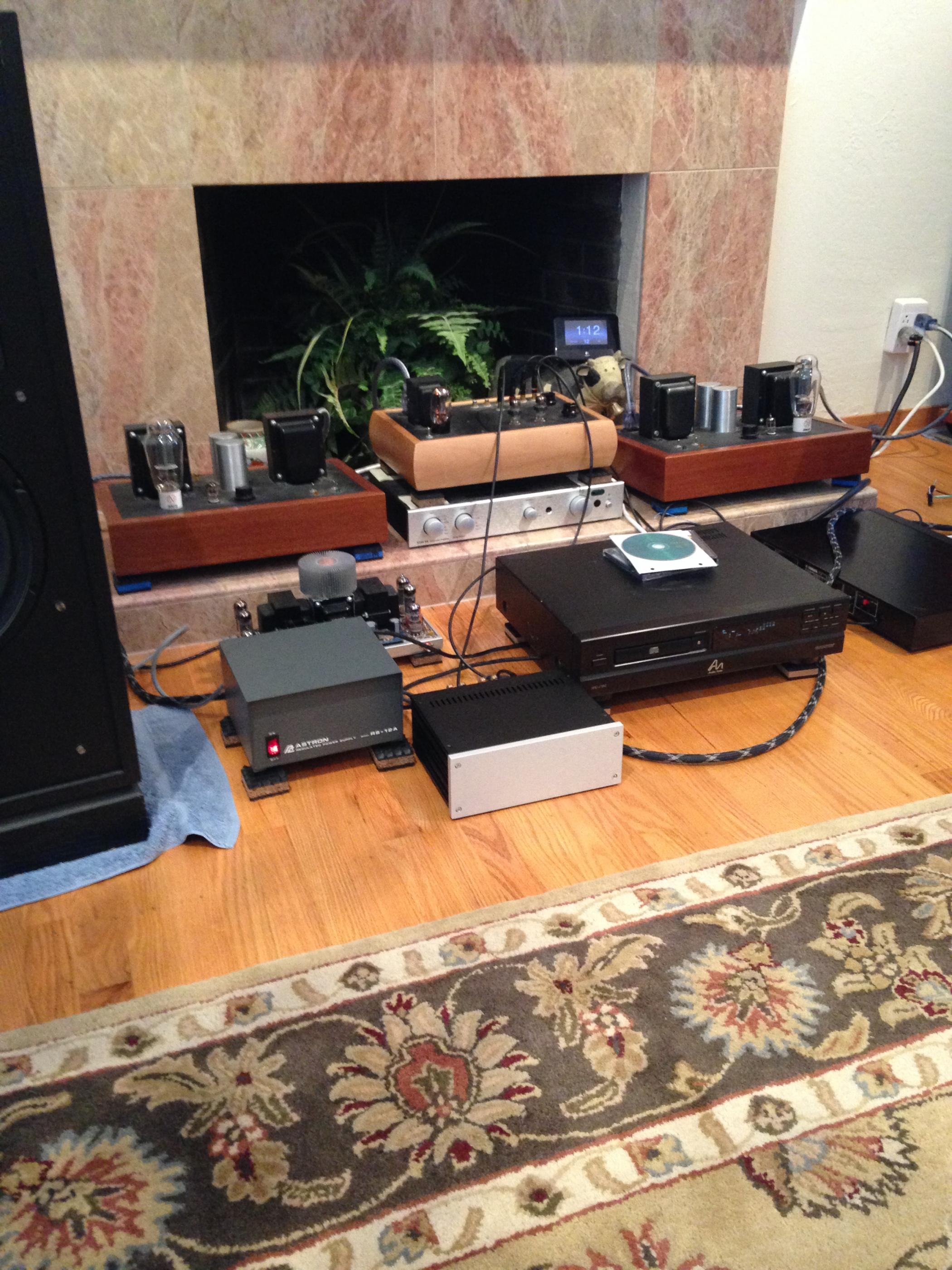

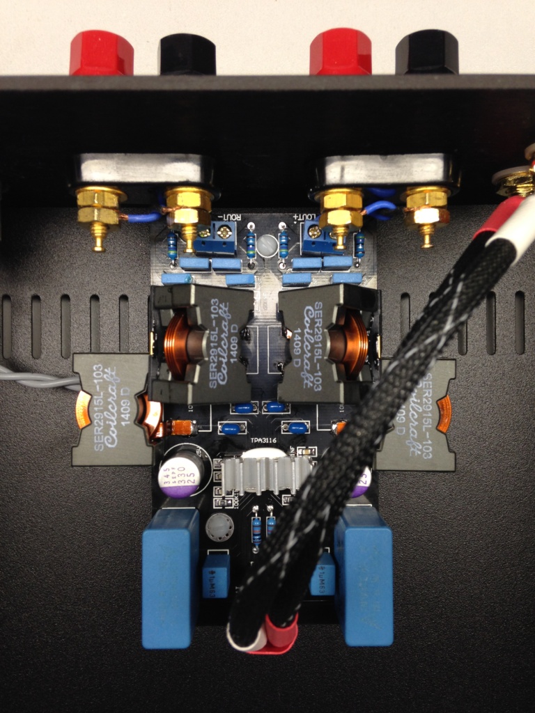

I brought my TDA7297 amp to a friend's home to audition against his modified YJ TPA3116 amp and a slightly modified Sure TPA3110 with Panasonic OSCON caps.
With all the amps, we used the same modified Astron RS-12A regulated linear power supply. We also used a Music Reference tube preamp using a single RAM Labs 12A7 dual triode. My friend has a pair of Klipsch Forte IIs with the Bob Crites crossover cap upgrade kit and Titanium tweeter diaphragm upgrades.
We were both surprised at how well the TDA7297 held up to the TPA3116. It had a smoother treble and the bass was comparable, although the TPA3116 dug a little deeper. The soundstage with the TDA7297 was deeper and the amp's sound had greater presence. The TPA3116 had better definition of notes in terms of strike and decay. Another interesting thing was that the TDA7297 sounded better as a standalone integrated amp. The tube amp made the TDA7297 too polite. We both marveled at how incredibly quiet the TDA7297 amp was between tracks and during quiet passages, and it has no power on/power off thumps like the TPA3116 amp.
We also compared the TDA7297 to the Sure TPA3110 amp. I had removed the Ferrite beads, so the Sure amp had no filter at the output. The bass had a roll-off around 45-50 Hz, but the midrange and treble tone was comparable. My friend actually preferred the Sure TPA3110 over the TDA7297. To my ears, they were similar aside from the bass.
This was a fun listening session, and we played everything ranging from rock to jazz to country to large orchestral music. With really high efficiency speakers like the Klipsch Forte IIs, the TDA7297 has to be one of the greatest bargains available, even with mods and an upgraded Astron power supply. We didn't have time, but my friend will compare the amp to his DRD 300B SET mono blocks (he prefers his modified TPA3116 to them).
It will be interesting once better amp boards like Destroyer OS's TDA7297 comes out. For now, the $5 amps from eBay are respectable with some modifications.
In my own listening, I still prefer my modified YJ TPA3116 with input transformers, but this setup costs a lot more than my simple TDA7297. I had purchased the 1uF Black Gate N caps a while ago when they were affordable. I would think some compact film caps like Wima MKP2 would do quite well in this amp.
