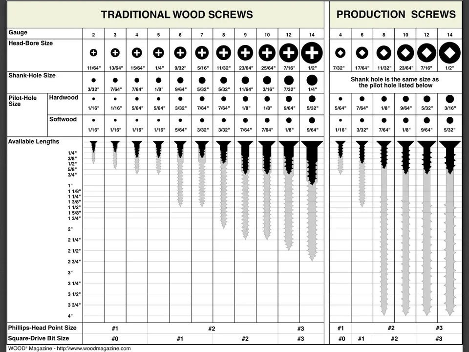

Maybe it is my long history with maintaining an old boat, but I never, never, never use a power tool to fully drive a screw for furniture, cabinetry, speakers, or anything on my boat... All screws are always driven by hand, and always with the correct size pilot hole and counter sink. I also use a screw lubricant, such as wax, with dense hardwoods such as teak, maple, white oak, birch (including birch plywood). I will use a power driver when first installing a screw, but I stop once the screw is a few revolutions from tight. The final tightening is done by hand. I can feel when the screw is tight enough, and any further tightening is just damaging the wood threads. I always remove screws by hand, never with power. I have found I can remove and reinstall screws at least 20 times before the wood threads are worn out.
I don't use T-nuts or threaded inserts when installing drivers. I use wood screws installed as above. Maybe with MDF material, threaded inserts are unavoidable, but with quality plywood, drivers can be removed and reinstalled a dozen times at least without damaging the wood threads.
