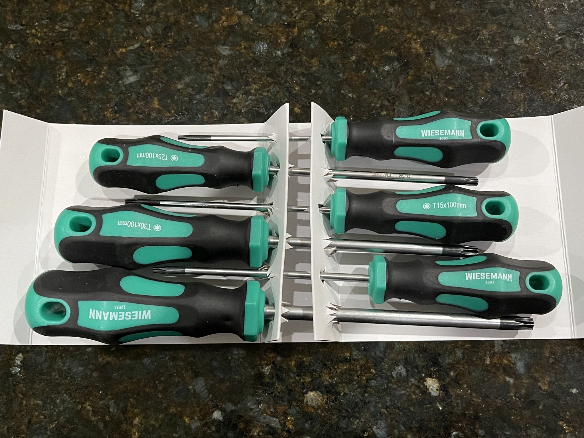

At least 2 times the same mistakeLong time ago, when putting Lowthers on the open baffle, my hand slipped and I made a hole in the cone with screwdriver. Maan that hurt.
but on cheaper drivers…
I decided to use Torx screws as i feel them to be even more secure than Allen screws after my latest attempt...
