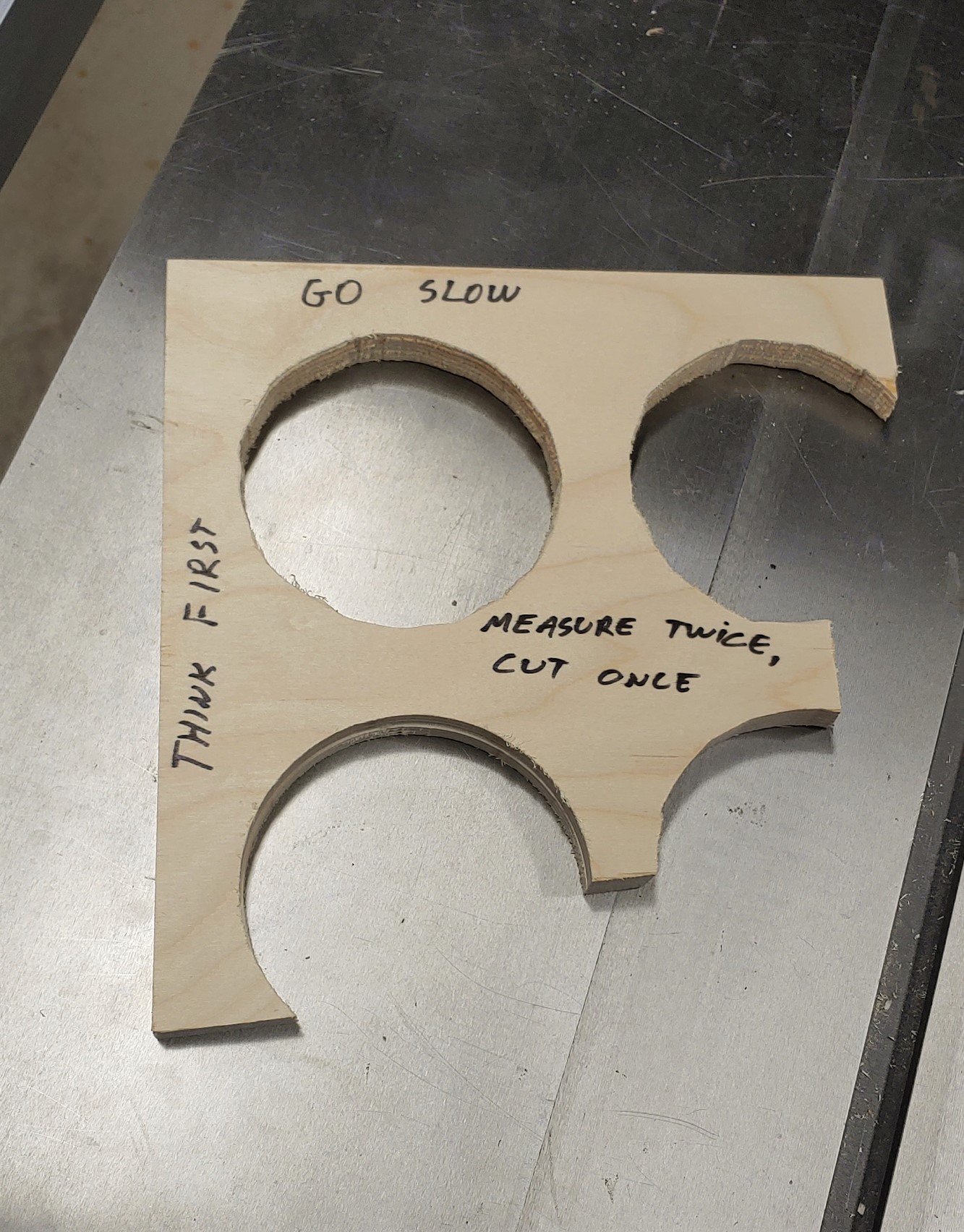

1) I glued a bulkhead-type window pane brace into a woofer cabinet, and the next day realized I had rotated it 90 degrees from correct orientation. I had to cut it out and make a new brace. I use the remains of the old brace as a reminder

j.
