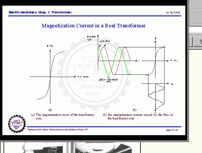

Well, its been a while with no activity so it seems that we are satisfied that the four original parameters mentioned in this thread are the only significant ones to consider when evaluating the potential effect on how it sounds. Of these primary four listed in numerical categories as:
1. core flux density (lower is better)
2. dc tolerance (higher is better)
3. quiescent current (lower is better or application specific)
4. wire thickness (thicker is better or application specific)
Of these four the least contraversial was the lower flux density. A list of ways we can achieve this lower core flux was submitted as letter enumerations on category 1. so that:
1a. core size (bigger is better)
1b. core material (better saturation curve)
1c. windings (more turns are better)
1d. transformers in series
If this list is complete, then we can go forward and make an analysis of the practicality and effectiveness of each method but before we do, we should discuss what sonic penalty we suffer with high core flux density and where we are likely to hear it. Is high core flux just muting dynamics or is some bandwidth limiting also happening?
Contributors are encouraged to put forward their experiences with problems caused by high core flux. Then we will compare which method would be best according to the flux problem observed.

Audio power xformer
In my experience, high flux density may cause problems with mechanical noises from the xformer. These can be quite audible during low-level passages.
So called "low noise" xformers are generally made by overrating the core. For instance, design a 300W xformer but use a core rated at 500W. I know at least one manufacturer of custom xformers (Burmeister in Germany) who does this and the results have been (for me) quite satisfying for a modest cost increase.
I have never experienced an effect on the audio signal itself related to flux (assuming the xformer has been mounted in a sensible position/orientation), so I would be interested in this. I always assumed that if this would be the case there was something seriously wrong with either the power supply design or the amp design.

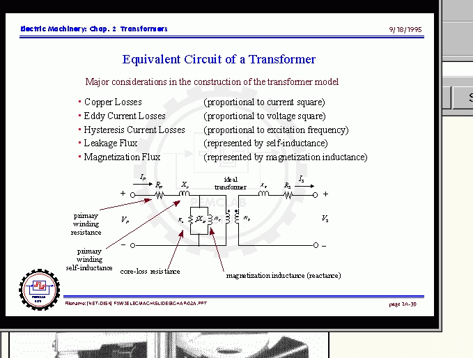

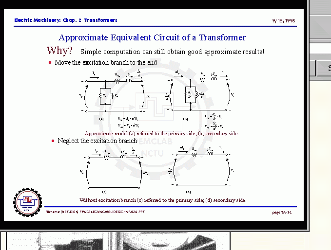

If we assume that flux saturation occurs only when the power delivery is stressed, then the power supply would not typically be stressed in low-level passages but perhaps it would in a class A design. Was your experience on a Class A amp circuit? Describe the noise as best you can. It's quite possible that the noise is also in the loud passages but masked.In my experience, high flux density may cause problems with mechanical noises from the xformer. These can be quite audible during low-level passages.
From the Institute of Electrical and Control Engineering© - go toWhat we need most in an Audio Power Transformer
