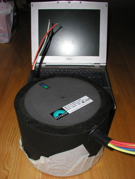

Fred Dieckmann said:" Interestly the difference in weight for a Plitron 1000VA standard transformer and a 1000VA designed for low noise is 6 Kg. for the standard vs. 16 Kg. for the low noise version designed to "remain quiet even at 10% high line with 250 mV DC voltage in the mains."
This is how big Plitron low noise, 1.5kVA toroid is.😉
I tried to use it for balanced AC power configuration (since it had quadrupled 30V secondaries) but actually it degraded the sonics in my setup. I was actually happy for that, since the transformer was $600CAD to have😉
