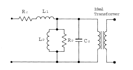

The circuit below shows a (simplified) equivalent circuit of a real transformer.
Rc is the series resistance of the primary.
Ll is the leakage inductance of the primary.
Lp is the inductance of the primary (the ideal transformer has infinite inductance).
Rp represents the losses in the core.
Cd is the capacitance of the primary winding.
The secondary will also have series resistance, inductance, leakage inductance and all these parameters can be measured with respect to the secondary windings as well.
With this definition of terms out of the way:
Large transformer often sound better. The larger cores do not saturate nearly as easily during the peak current demands. Jocko and I have measured this and noticed a subjective correlation between transformer size and sonics. Even for low current circuits like preamps, large transformers tend to sound better. A small resistor in series with the secondary windings to limit peak current often improves the sound of smaller transformers, which tends to confirm the saturation theory. This can be seen looking at the transformer's secondary voltage waveform with a scope.
Paul McGowan discusses the topic of large transformers in a Stereophile interview. The subject is on the first page of:
http://www.stereophile.com/showarchives.cgi?222
Toroidal transformers can sound fine but they do not tolerate DC and low frequency garbage that tends to make them saturate and mechanically buzz. It is not that hard to ADS couple the primary windings with back to back filter caps shunted by diodes to limit reverse bias voltage on the capacitors to a diode drop. Jeff Rowland was doing this 10 years ago as I recall. Toroidal transformers are also designed for high flux density for greatest efficiency which makes them more sensitive to the previously mentioned. I know of one designer that has his custom transformers made with lower flux densities.
Different size and type transformers have different leakage inductance for the secondary windings. The combination of this inductance with rectifier capacitance can form a high frequency resonant circuit creating RFI noise that your amplifier may not like. The use of 1000uF caps with no high frequency bypassed can make this problem even worse since this resonant circuit may be at a frequency above the point were the 1000uF cap becomes inductive again. Paralleling the secondary winding with a capacitor will form a lower frequency resonance with a high Q that can helpful or harmful dependency on the resonant frequency. It is possible that this cap may also provide increased diode switching noise since diodes are discharging the stored charge in the cap as they turn on (and off as well, from the reverse recovery currents) This low impedance cap provides a much lower source impedance that the leakage inductance and winding resistance of the transformers secondary windings and will allow higher diode currents. Winding techniques and core shapes can also provide different degrees of coupling of RFI noise on the AC line to your amplifier/preamplifier circuits and form resonant circuits that ring when excited by RFI from the AC line or diode bridge.
In the course of designing an amplifier with a 60 Hz oscillator to create a clean 120V power source for low level circuits, I found something interesting. The various step up transformers used on the output of the amp sounded different. This was even though the transformer was outside the amp's feedback loop for and did not effect the stability of the amp. The best sounding transformer in this set up was an output transformer from a 200 W Conrad Johnson tube amplifier! The higher bandwidth and better core material may be a factor since the charging current for the diode bridge and capacitor supplies being powered, contain frequencies much higher than the 60 Hz of the AC line voltage.
I don't suppose it surprising that different transformers sound different in light of these and other factors. There are circuits that can minimize these problems whose design should be optimized for the particular transformer used.
It's excitation current not "excitable current"
http://pemclab.cn.nctu.edu.tw/W3elemac/W3slide/ch2.xformer/tsld022.htm
