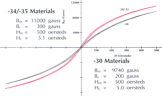

Hey Frank, you got some pretty good charts for iron.
Any Grain Oriented M6 iron charts?
I would be interested on those.
CHARTS.

Regulation, as said, is a function of the design parameters. And power "Raiting" is set by the manufacturer following commercial issues and what they can get away with.
Say a trafo is rated at 100VA but its working at 90% of the max core flux so you will see that it does not have good regulation since it working almost to saturation and will not have any headroom say a 10% overcapacity on peak demands will through it well in to saturation. On this (extream) situation you can expect a lousy regulation.
So coming back to core materials. I would put this issue way up con the selection of trafos. Meaning that a good material will be way better, even in a smaller size and weight than a bigger with lesser core material. This is, a good core material will have a high core flux saturation value plus a proportionaly much lower core losses. Provided that both designs are "good".
So bigger it's not always better even though it implies better regulation but does not take in consideration core and winding losses.
Of course non of these parameters are part of specifications by the manufacturer, so it is very dificult to make a selection. That's why we tend to select trafos form known good brands? I guess so.
As nania says low core flux is something good to have, but that is not the whole story. Since to be good it needs to be acompanied with a high core saturation value (this are all relative terms).
So for good regulation we would need:
1. Low core flux relative to core saturation value.
2. Low core and winding losses

First off the name of the thread should be what makes a good audio power transformer. I think I might have been the one to start discussions on core saturation. most of this discussion is kind of futile because unless you are going to custom design a transformer you will have no say over most of these factors. If you did actually know what you wanted, getting a typical transformer shop to build it like you wanted is a major challenge. Exotic core material? How many hundred of these are you going to build? Really what you realistically have a choice about is running a transformer that will not reach core saturation. Putting dual primaries windings in series and selecting double the secondary voltage for the transformer since it will now be half that value with the primaries that are usually wired in parallel are in series. Selecting a much larger transformer VA rating than the load requirement will also help avoid saturation. There has been way to much emphasis on regulation. It is not that important for anything but power amps. Line level circuits like preamps are a fairly constant draw and are not going to put a stain of a sufficiently large transformer. Low winding resistance promotes larger peak diode currents and more EMI and possible saturation of the core. I often use a series resistor to limit the peak diode currents despite the decrease in regulation.
Well coupled windings for low leakage inductance increase the interwinding capacitance and allows more noise from the AC line to enter the supply. Split bobbin transformers minimize this coupling capacitance at the expense of great leakage inductance with no ill effects that I am aware of. Good luck finding data on the magnetic characteristics of transformer steel. I can routinely find data for ferrites and even computer simulation models but not much on steel on the web or the transformer text I have read thus far. I would read some of links mentioned in this thread on this stuff at the transformer manufactures site. There is enough stuff on the Plitron site to make you head spin. Remember most power transformers are designed for the biggest VA rating per cost and weight of materials. Go do some reading. I think this "4 Simple Rules For Rating my Transformer Wattage " show is getting you nowhere.
