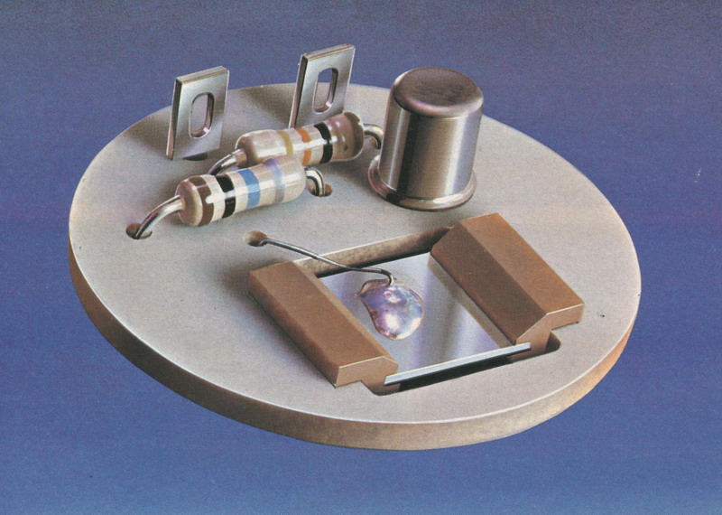

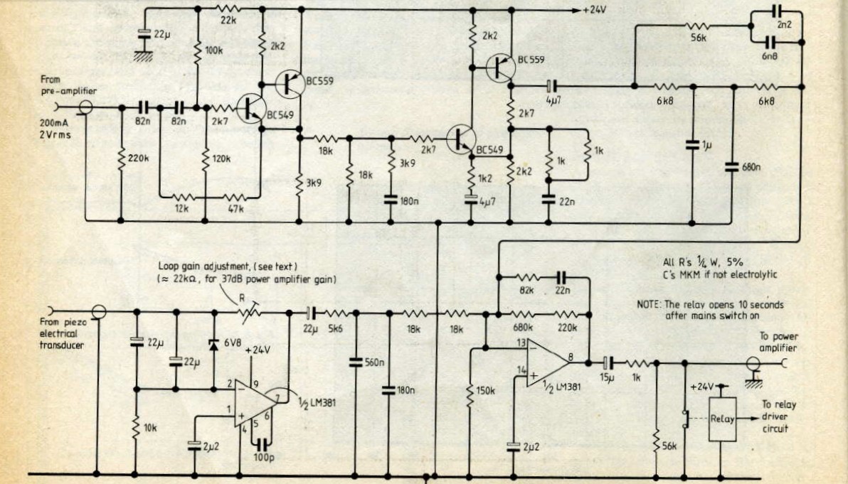

Closed-Box woofers and subwoofers are not yet dead. In the seventies, Philips had a system named MFB (Motional FeedBack), a Closed Box loudspeaker where there is an accelerometer on the cone, and a dedicated power amplifier. The accelerometer registers the actual cone movement, and acts as feedback element in a servo loop with the amplifier. You still need the same big cone excursion for delivering a decent deep bass sound intensity, but you annihilate most of the distorsion caused by the big excursion. The Velodyne subwoofers reintroduced the same principle later on.

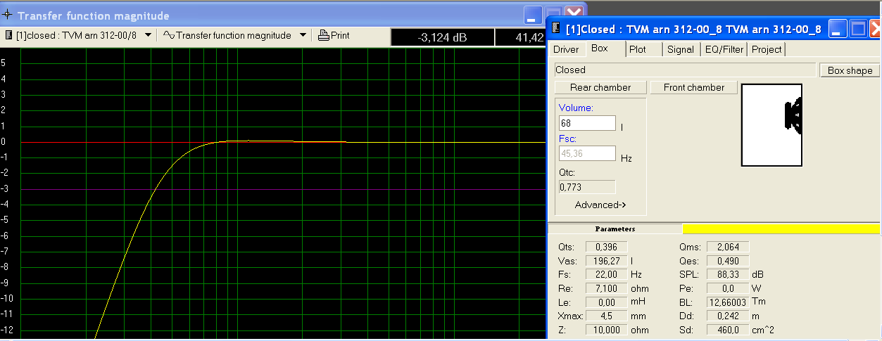

yeah youre right better take the 12" TVM -10dB 25Hz. In a stuffed box of 56 liter. Unstuffed 68 liter.
Looks like nice driver! SB29 has bit too high Qts for closed.
What benefits is to unstuff the box if it demands higher volume? Does stuffing worse transients or what?
Completely wrong. Such Hypex module doesn't support acceleration or velocity or position feedback. You need a heavy PCB tweak, isolating the power amplifier input and adding a daughterboard containing a few opamps. It is feasible, but not recommended as the class-D amp may cause surprises once embedded in the required servo loop. You better use chipamps like TDA7293 or LM3886, possibly wired as current sources instead of voltage sources. If you target a clean transient response and a linear phase, you do a 3-way speaker using a Baekgaard crossover (Low Q 2nd order state variable filter application - KHN BiQuad) with a high quality medium speaker like Dynavox FE87 or FR88. In order to keep the whole stuff compact, use the Visaton CP13 tweeter. If you want to avoid directivity issues, use the WMTM layout. DSP is not mandatory. A few opamps suffice. Oh, you need of course a sensor in the woofer. Read the Philips 22RH532 service manual, then you'll know how to build and how tu use such sensor. Picture of F9638 Flat Membrane MFB Woofer provided by Helmut.Just buy a Hypex module with dsp for your own two way 2x100W class-D design active DSPspeaker with remote control.
With stuffing the box volume can increase virtual 10-20% for the driver. So box volume X 1.1 (or 1.2) after stuffing. Every time I was experimenting I came out I only like light stuffing of a box.Looks like nice driver! SB29 has bit too high Qts for closed.
When the damping material isn't loose enough the box volume starts to decrease so then you get the opposite effect.

Hi StephCompletely wrong. Such Hypex module doesn't support acceleration or velocity or position feedback. You need a heavy PCB tweak, isolating the power amplifier input and adding a daughterboard containing a few opamps. It is feasible, but not recommended as the class-D amp may cause surprises once embedded in the required servo loop. You better use chipamps like TDA7293 or LM3886, possibly wired as current sources instead of voltage sources. If you target a clean transient response and a linear phase, you do a 3-way speaker using a Baekgaard crossover (Low Q 2nd order state variable filter application - KHN BiQuad) with a high quality medium speaker like Dynavox FE87 or FR88. In order to keep the whole stuff compact, use the Visaton CP13 tweeter. If you want to avoid directivity issues, use the WMTM layout. DSP is not mandatory. A few opamps suffice. Oh, you need of course a sensor in the woofer. Read the Philips 22RH532 service manual, then you'll know how to build and how tu use such sensor. Picture of F9638 Flat Membrane MFB Woofer provided by Helmut.

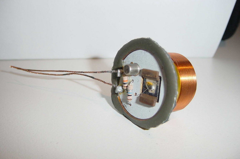

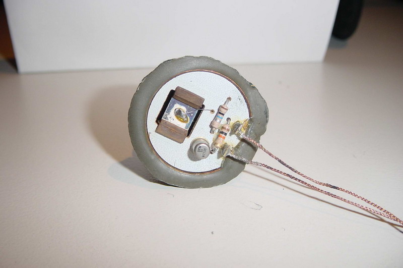

hi Helmuth, the issue with the MFB are the tremors and vibrations induced by the big woofer excursions. After having built one, I felt that two woofers are actually needed per loudspeaker cabinet, firing symmetric. Front+Rear and/or Left+Right firing. This way the enclosure gravity center doesn't move anymore. How would you manage the motional feedback ? Equipping all woofers with a sensor ? Averaging the sensor outputs ? In his Sept 1981 Wireless World article, De Greef used two MFB woofers, but only one sensor. Imagine a solution using 4 woofers, but only 1 equipped with a MFB sensor. What inexpensive 8 inch woofer would you advise ?
Thinking about the sensor functioning in a two woofer box, it will be possible to equip one woofer with a sensor and ad the sensor mass to the other for symmetry.

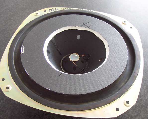

I would cut out the center cap and leave the part glued to the cone where it is and buy a new center-cap and glue it over the modification.
centercap ebay.
http://www.ebay.com/itm/6-3-8-Inverted-Poly-Speaker-Subwoofer-Dust-Cap-Kit-/290552315687?pt=Car_Subwoofers_Enclosures&hash=item43a6447f27#ht_971wt_936

Could not resist mentionning the 1986 Elektor article from R.Conell, hosted by mfbfreaks.
http://www.mfbfreaks.com/theorie/elektuur1986mfb.pdf

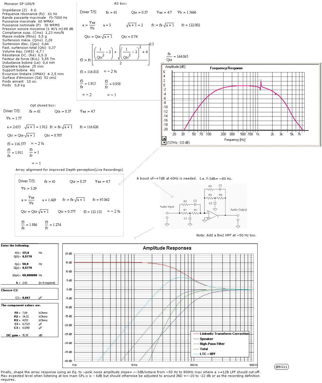

Do you think Realistic 40-1022 can be substituted by Monacor SP100/8 ? Haut-parleur grave-médium Monacor SP-100/8Hi FYI, I still use those great drivers for two bookshelf arrays(2x5) with td> 42 mS using an A+B summed signal at slightly above JND level or sometimes at an higher level for some records. Although an As design would be a perfect use for these divers ,I went for a larger Vb volume. b🙂
Hi steph_tsf,
Yes I do if for an AS speaker but if you want to try an frontally placed delayed array I think you need to adjust the FR a bit, See my picture hints:
b🙂

Very nice Linkwitz Transform application ! Much appreciated !Hi steph_tsf, Yes I do if for an AS speaker but if you want to try an frontally placed delayed array I think you need to adjust the FR a bit, See my picture hints
