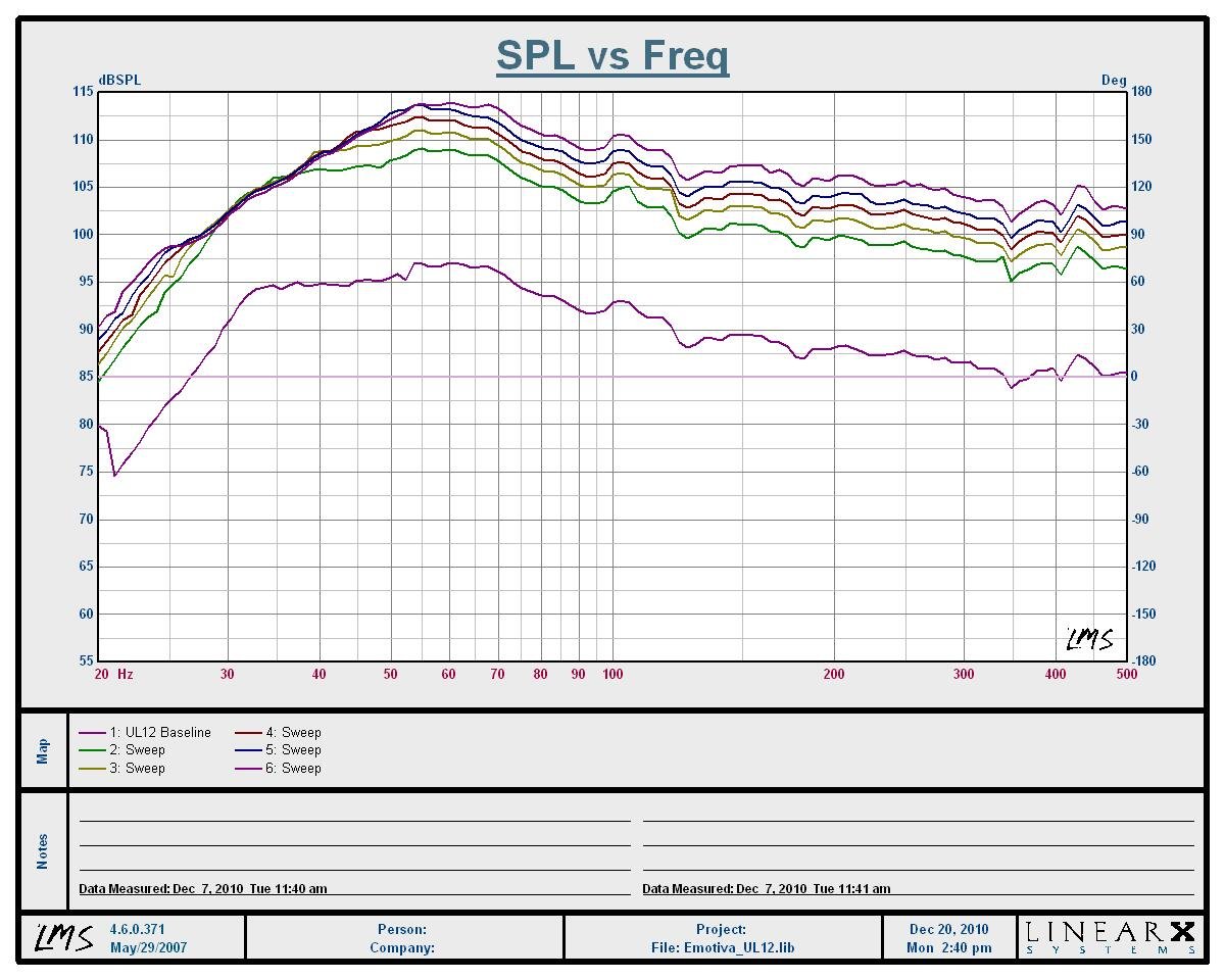

Okay, so I did some searching to (of course) support my hypothesis.
I wonder if this Audioholics measurement of the Emotiva EMO-UL12 sub is comparable to other sealed box designs:
Granted the compression doesn't look bad when you think about the level and measurement conditions, but you would think smaller, less robust speakers would be more prone to it. Perhaps leaving a small speaker's bass output to the port and not pushing it's motor/suspension might prove beneficial?
You know, looking at the response of that speaker under those conditions, I kinda want one.
I may have to do my own tests just to see. I've got a certain speaker that seems to do well sealed (more like aperiodic) or ported, but sounds more dynamic to my ears when it's ported. That may have something to do with the diffraction and reflections from the ports, perhaps the sealed is just compressing more, or it is the loss of 1dB of output.
Here's what the frequency change from the port stuffing:
