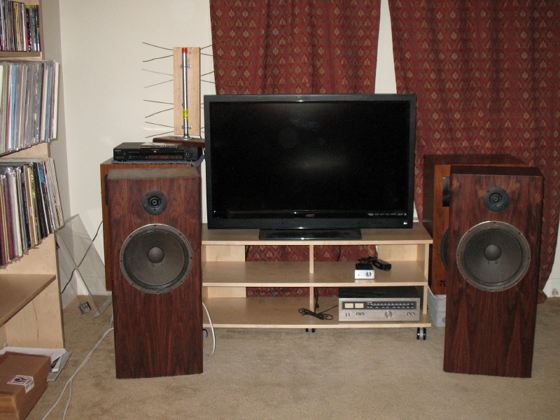

Bill, what components are used in your speakers in the pic? They look terrific!
When i first read this post i thought sealed is not dead and never will be dead. But yes, Thiele/Small made it easier to design ported boxes that also sound very good.

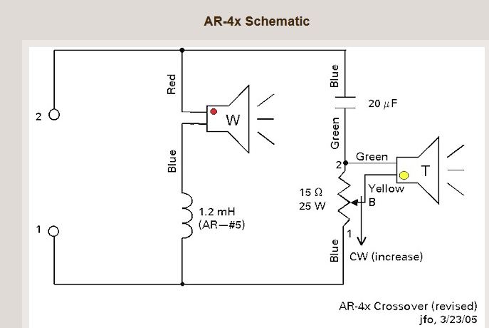

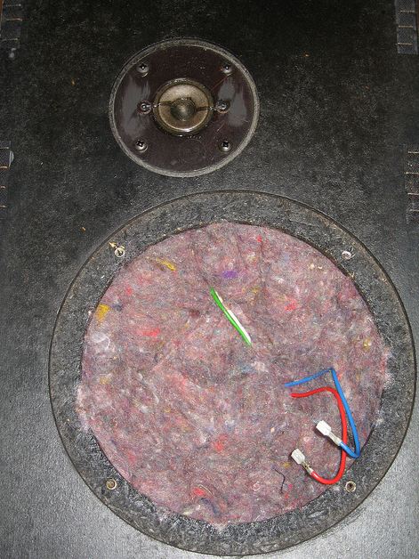

To say that acoustic suspension is just closed box is misunderstanding how it works. AR's bass drivers were very high mass and inductance (ca. 3mH) with soft foam surrounds on a lowish Qts well below the 0.5 you'd use with most closed box. As a result, as mentioned, the Vb is at least 3 times smaller than the Vas. The design also differs from closed box in using a huge amount of glass fibre or similar stuffing.
These days surrounds are much better than in the 1950s and 1960s, and its main justification is past. The AR-3A is still a fine three way design, but the two ways like the AR-4X and AR-6 looked dated and let though a lot of midbass cone breakup around 5kHz which can sound harsh.
It wasn't reflex that competed with Acoustic Suspension in the 1970s , but closed box with more sophisticated crossovers and less stuffing but still using wall reinforcement of bass. Bookshelves, not standmounters.
Overall, I'd say that it wasn't bass that let AS down at the budget end, but the muffled and harsh midrange. Much easier to design a standmounter too. You use a bigger bass coil which makes electronic filtering easier. If I was building a bookshelf type these days, I'd use a low inductance driver for sure. Like this Peerless 830870 4" polycone which is optimised for closed box of 5L:

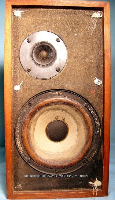

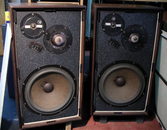

I don't disagree with most of what you wrote, but the early AR surrounds were a ,treated linen not foam.
The 2 way photo on the left in your post #191 appears to be treated linen , the 3 way on the right, foam.
I recently (unsuccessfully :^( ) used the treated linen surroundss from a pair of ARs from approximately 1959 to replace the rotted foam surrounds on some much more recent "digital ready" Cerwin Vega speakers.
The early foam surrounds rotted quickly (especially when exposed to sunlight), which would have had an impact on popularity, it is a good thing that foam surrounds no longer have to disintegrate so quickly.
