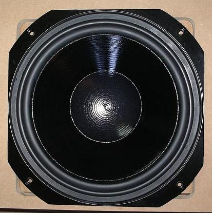

Wow, some speaker! Can that little vent handle that 18" behemoth? Or, are there more ports elsewhere?
That is the only one. Was actually for 15 inch woofer, but never changed the port. The design was from old Jensen paper.

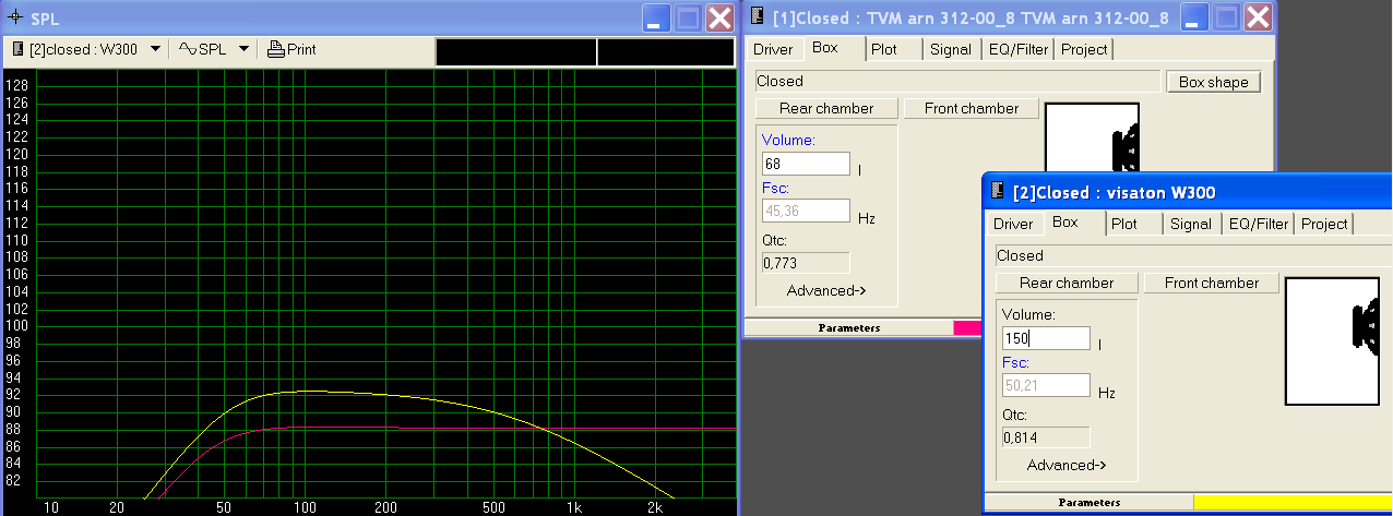

Scanspeak 40liter 30hz -3dB. 82dB
http://www.scan-speak.dk/datasheet/pdf/23w-4557t02.pdf
Visaton W300 low price good efficiency.
http://www.visaton.de/en/chassis_zubehoer/tiefton/w300_8.html

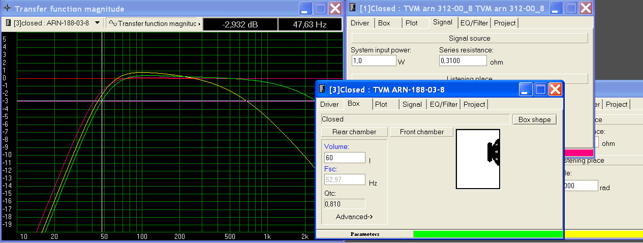

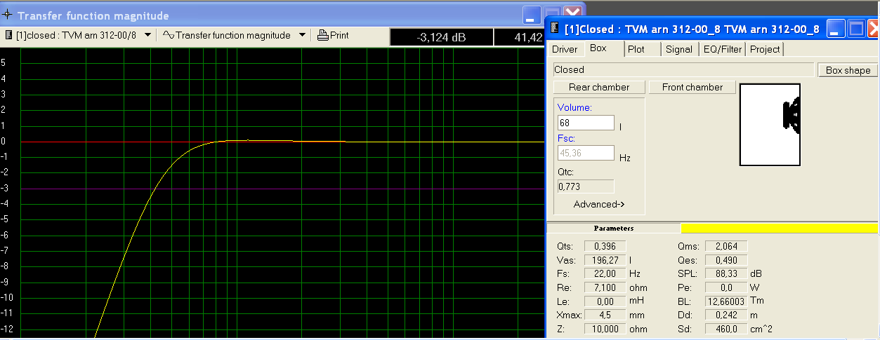

Tjech TVM-acoustics former Tesla has nice 12" woofers for AS ,ARN312. Price 80euro. 89dB
TVM Acoustics, Valašské Meziøíèí - Woofers
small size ARN188
arn188
Arn 188 w zamkni?tej budzie - YouTube
arn312
Bass test - TESLA repro - TVM-VALMEZ.CZ - YouTube

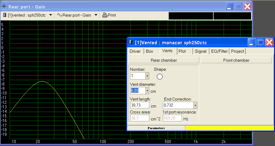

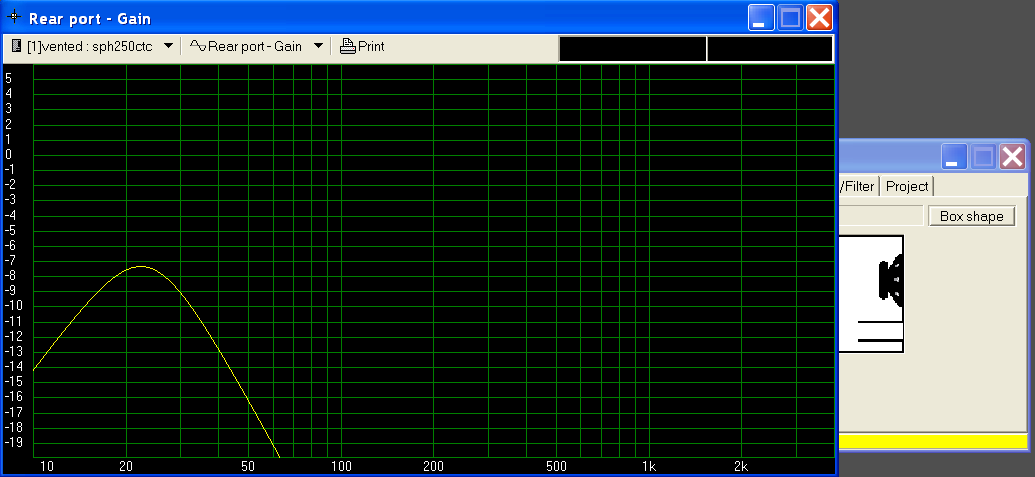

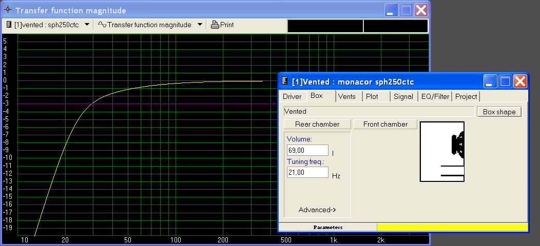

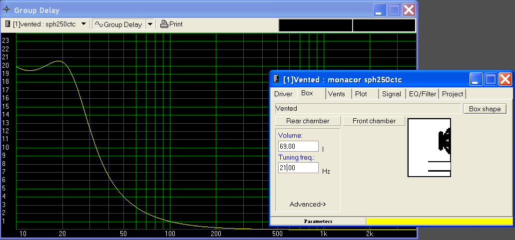

I can not see why a good BR construction would sound different other then with more subbas extension.
The closed box will have a punchy 50Hz region and a steep fall of of sub-bas. I think that AS lovers think when hearing bas blow 40Hz it is hum or poor transient behavior. They have to measure their response on listening position to show them self they made a false assumption.
I made a basreflex construction witch I garante will make no hum sound absolute tight goes down to 20Hz will satisfy the expectations of a closed box lover. I am talking out of experience with this driver.
It is the monacor sph250ctc clean sound low third order excellent transient I measured it and I could hear/feel it, clean reproduction.
Group delay better than a closed design around the 50hz area it increases below 30Hz where you can hear a thing. A very good compact subwoofer watch the limited xmax.
