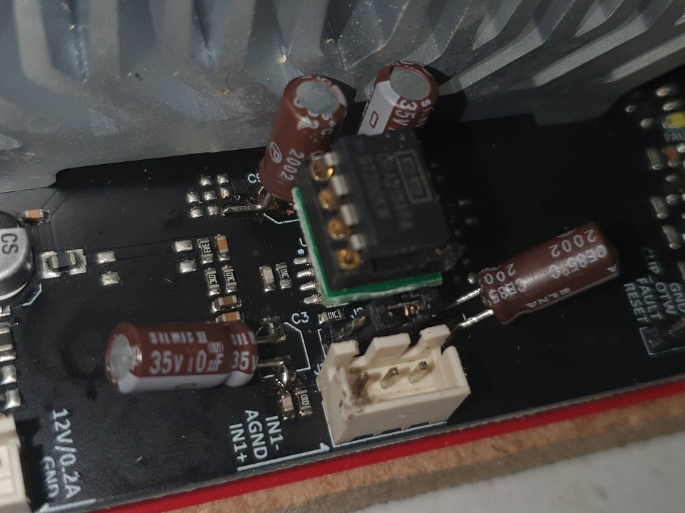

Hi, I have solder a soic to dip8 adapter, and 4 elna caps. -> nothing is working now so going to try the bypass to get rid of the op amp input of the 3e audio board.
Will let you know.

Some news,
THANK YOU A LOT LINUXFAN !!!
I made the input bypass as you told me, what a difference !!!!
A completly different sound, more dynamic, and a huge bass improvment ! It's completely different, like other speakers, I mean, it's not a small or placebo difference, before I had no bass and now almost too much !
So I'm really happy 🙂

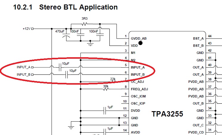

Just a technical question, after the blocking caps there is smd resistor (100Ohms i think) and a smd caps (100pF I think) but there is nothing advised by TI in the TPA3255 datasheet.
Can somebody explain me?
Also, I can reach the maximum level of my DAC very easily. I have a good volume but I thought those PBTL amplifiers would be able to kill my speakers eaysily, which it's not the case.
Any idea about the max power PBTL on 6-8 Ohms speakers?
Yes, I'm surprised that only a few other people have bothered to go this way.
Of course it's not for everyone - you need a differential source, preferably with solid line drive capability - because there is no longer a buffer stage at the amp's inputs. DAC's with opamp-based output stages generally meet this description.
Have a look at the TPA3255EVM schematic -
https://www.ti.com/lit/pdf/slou441
at the input of the TPA3255 is a series resistor (R5) and a cap to GND (C19). I think these are to filter high frequency noise. More knowledgeable people here might be able to comment further.
I would leave them be.

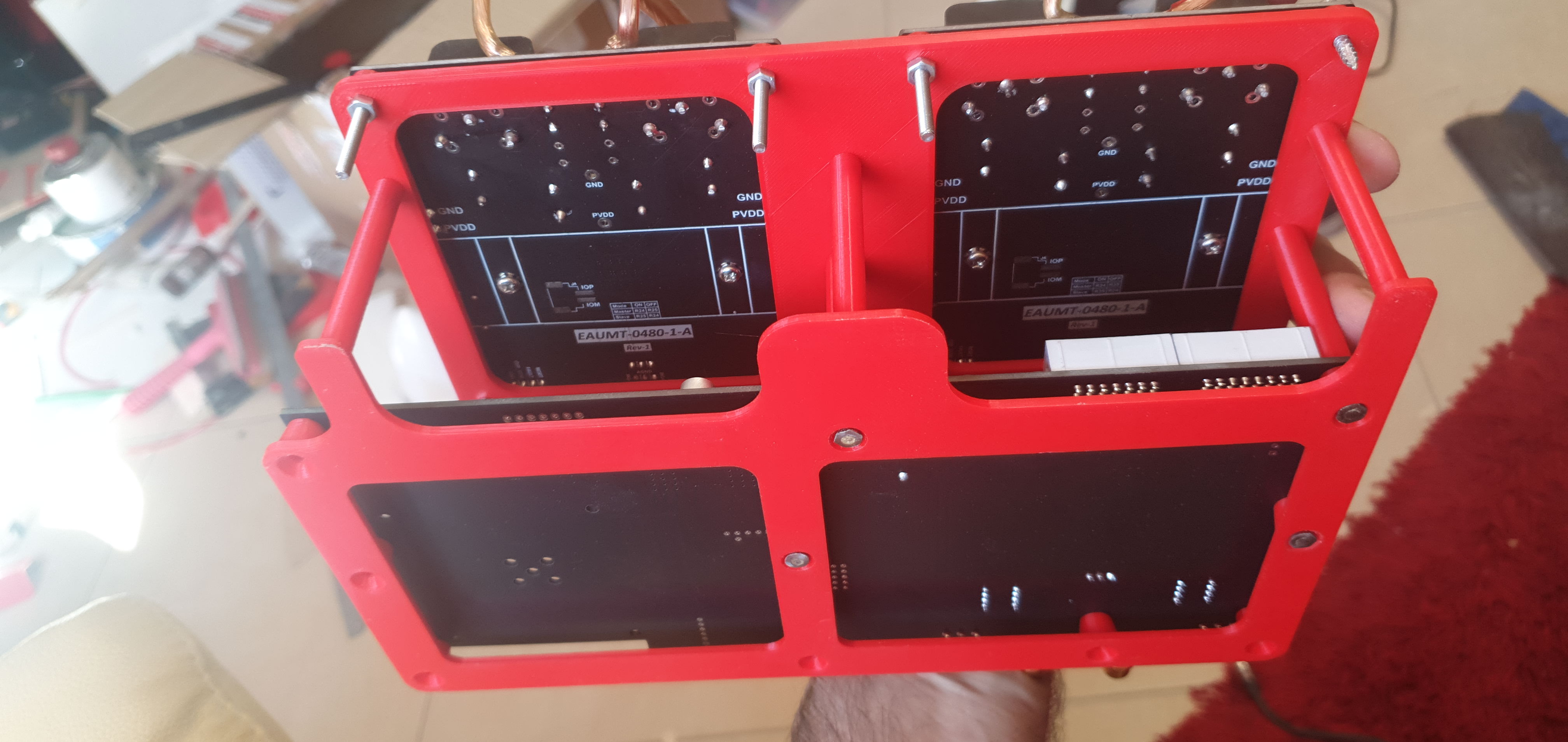

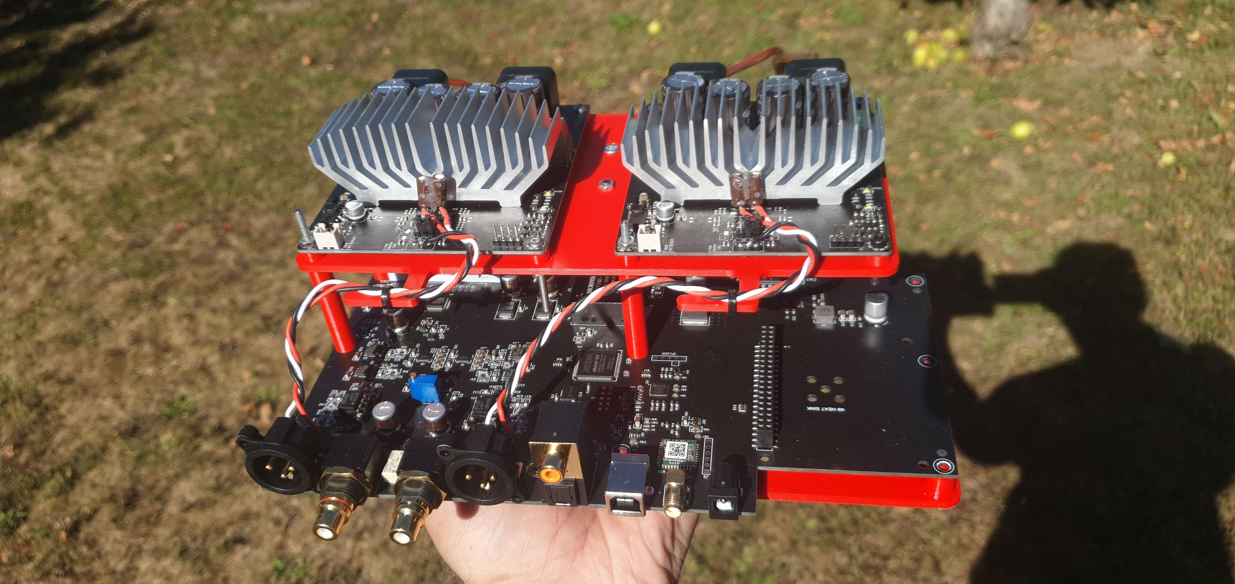

Some news of the project ����
Souding really well now I'm super happy.
First assembly on the 3d printed chassis. I have to buy the good screws ��
Question, if I buy 2 btl boards, is it possible to supply them with 1 xlr cable - > my dac is stereo, and would like 2 btl amplifier boards, to bi amp each speakers. Don't know if I'm clear ��
Sorry for my voice on the video ��
