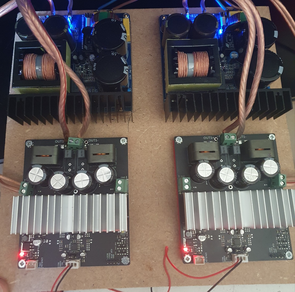

I have 2 very good 600w power supply.its on Eval board at the moment 🤣

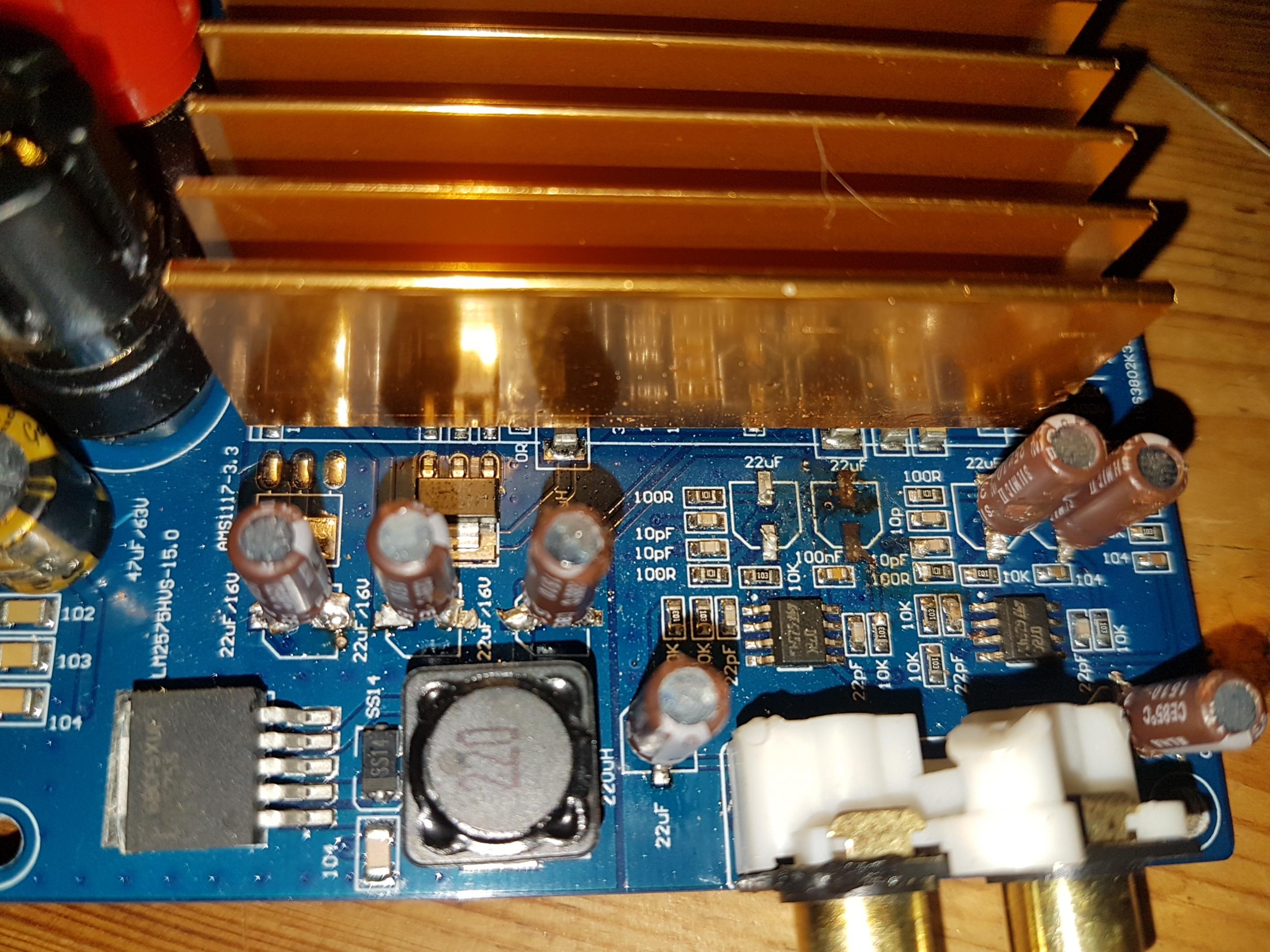

Hi all. I've been following this thread for over a year now because I'm impressed with this this amplifier even though I have the generic Chinese version. Today I started upgrading the the capacitors to Nichicon and Elna's. I'm not electronic savy or have much skill in soldering but I want to give myself the chance to learn after reading here the improvements you've all made to this amplifier. After successfully fixing 8 of the 10 I was replacing number 9 didn't work. Both solder pads came off as well as some trace. I'll try uploading a picture. if anyone here can advise me if it's salvageable or am I wasting my time on this I'd be very appreciative.

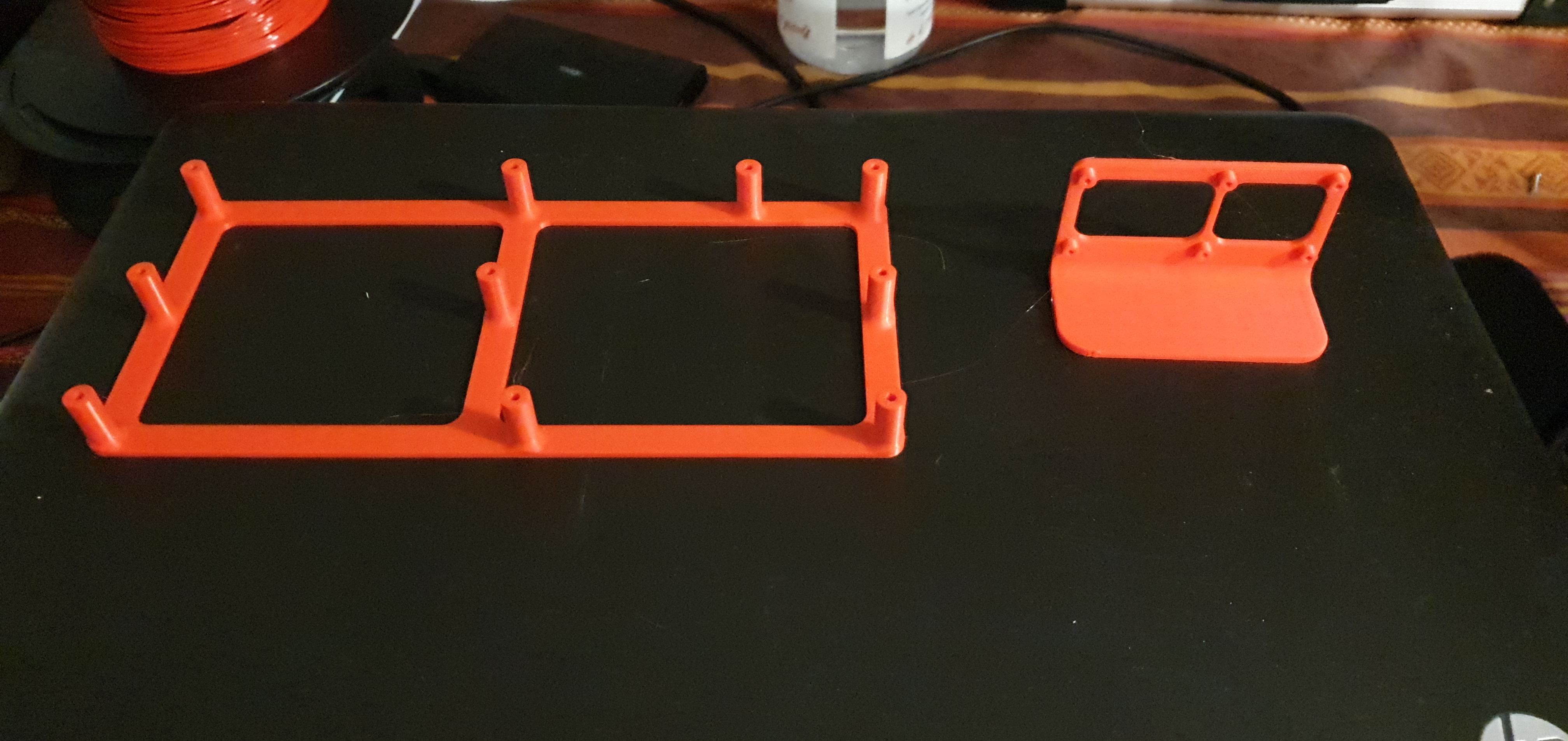

I should receive my DAC today, and have been working on the crossovers of my speakers 👍
Will test this first 😂
I don't know if it's psychological, but something I have always laugh about, the electronic burn in, seems to really happen. I have now a lot more bases and definition in my sou d than at the beginning... I mean I had to set the bass at the maximum at the beginning to get a bit of them, now I'm back at the setting 0 position and I have a lot more...
Anyway, looking forward to install all the new staff this afternoon. I have already design/print the support 🤣
