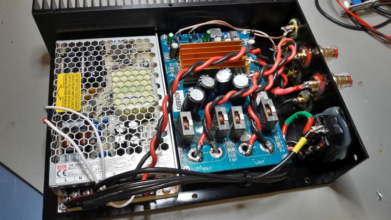

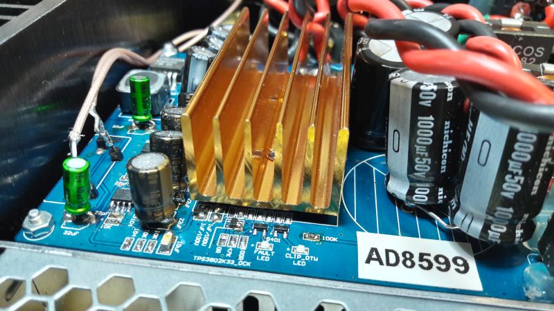

Thanks for the work you did on this. So it seems the warning LEDs are. Ever going to work? What was max peak to peak output you were able to get into a dummy 4 or 8ohm load?
Hi X,

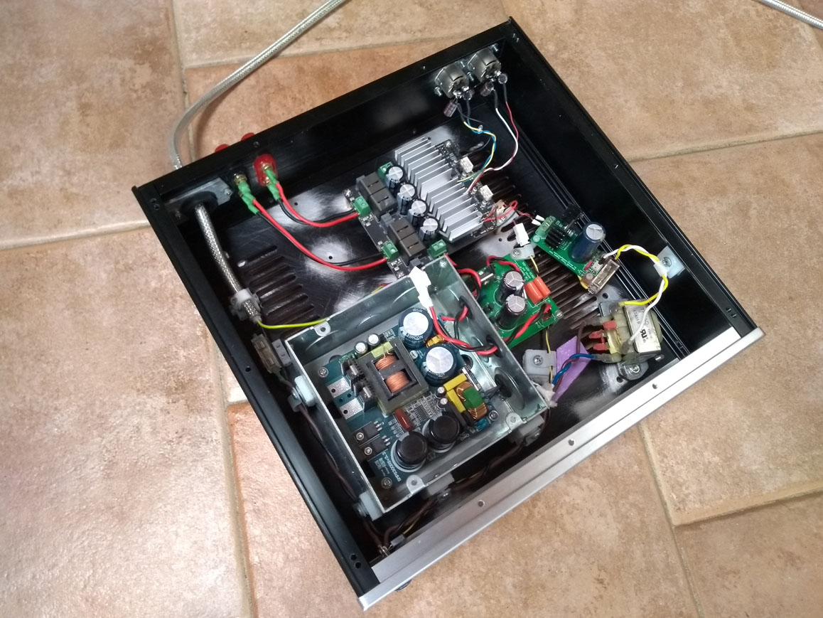

I just did at the beginning test with my Rigol DP832 - max Voltage with 3A is 31V. i Got no clipping with 760mVrms. So i can´t say what they do with this board/chip.

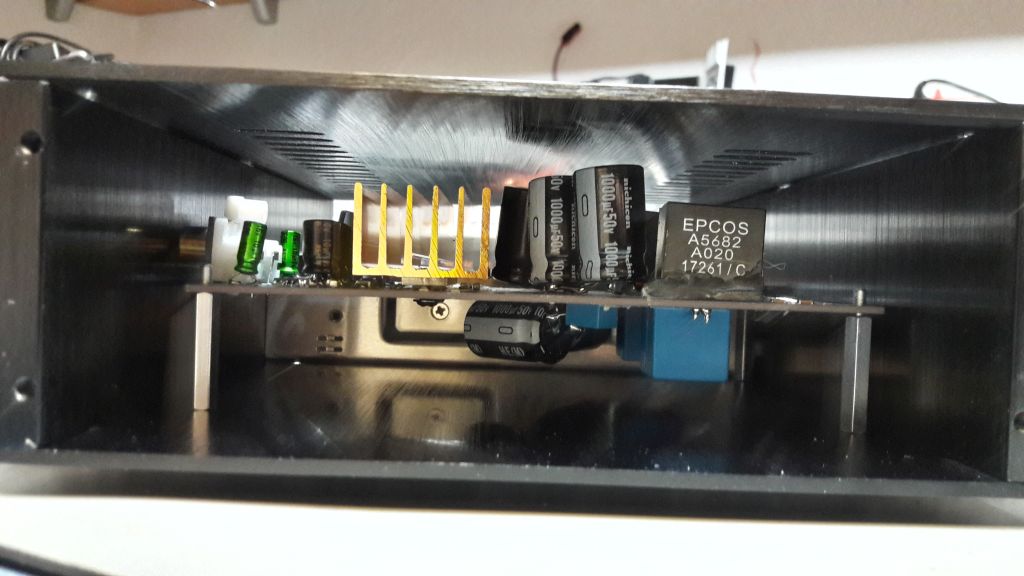

at my "fake amp" i use a 24V smps and set it to 28V.(pic 2)
chris
chris

Hi Chermann,
Thanks for showing the data at max output. I suppose that's good that you are getting 30Vpp out of a 24Vdc supply. 30Vpp is 10.6Vrms and that is 28Wrms into 4ohms - still quite a ways away from the clipping I saw at 48Vpp with a 51Vdc supply. But yours does look promising - although it appears heavily modified.
Hi Chermann,
Yep...some helped me to go ahead with my tpa3255 project (doctor and voltwide and others) -- they get partly crazy 🙄😀😉 about my noob questions😉
chris

One thing that came in my mind is the "Over-current programming resistor", check if it is as low as 22k, otherwise output power is limited. 22k corresponds to 17A max into 1R. When using latched mode, this should be 47k for 17A into 1R.
