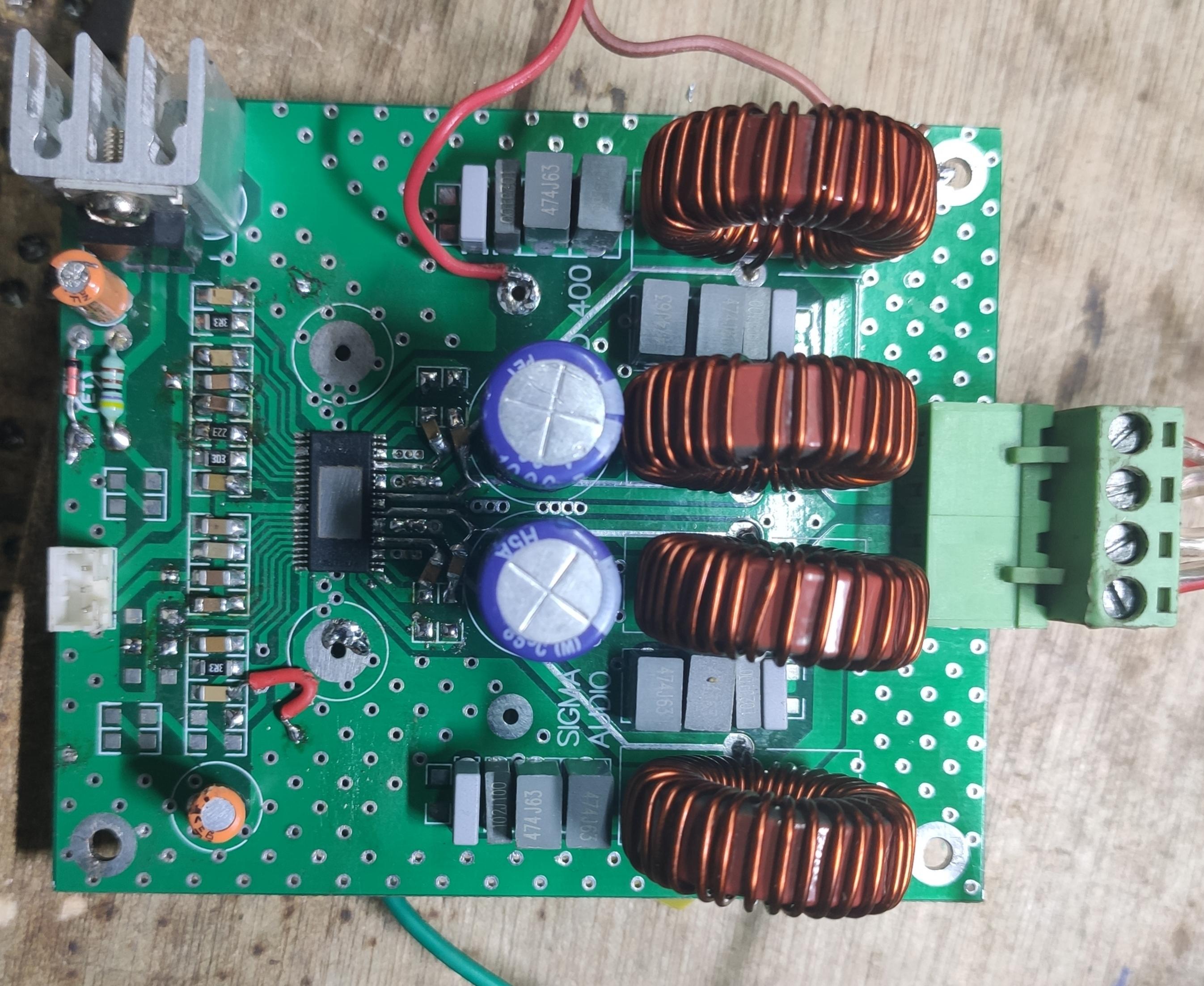

I tried my own board for TPA3255 and no matter what i do i cannot get pass 20watts from my board. All the drawing is same as in datasheet. Using 3.3 volt on board. Gate supply is 11.7volts. main supply is 33volts.
The problem is when i increase input gain it just goes off. Fault pin goes low and i have to reset it again. Don't know what is causing problem.

Sweetperfume,
Nice work making your own board!
There are a couple of things that may be causing this.
1. Are you running without a heatsink? If so, it gets hot when more than a few watts output and thermal protection kicks in.
2. Did you set the max current limit programming resistor correctly? If too low or not set, current limit kicks in around 20w. I bet that’s what you have. Read data sheet to select proper value.
Sweetperfume,
Thanks for your reply man. I am running without any heatsink but this happens on startup so no heat issues.
I am using 22k resistor as specified in TI datasheet. And to check i used 20k to 100k but still same issue persists.
Don't know what went wrong. I made another board to see if there were minor shorts on previous board but same issue was on new one.
And one more thing, sometimes it wont start and will remain in fault from start and while increasing input channel AB shuts down first then Channel CD.
For test i am using it on single ended btl mode.
Your board is wrong. There are no wonders in electronics. There are bad contacts and short circuits.
See error in your PCB.
Show board file?

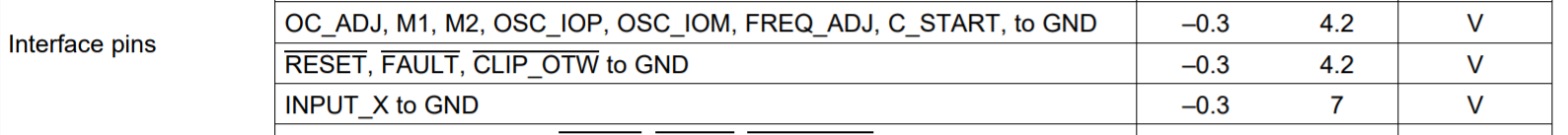

That statement about board is wrong was a hard one. Broke my heart. I don't have board file with me. Laptop is away now. But no shorts as i checked every pin. I never used anything like TPA3255. I am using tpa3116 commercially. Never faced issue like this one.
Only thing bothers me is reset and fault pin. I did not make any arrangements on board for 3.3v supply so i supplied reset n fault pin from AVDD pin. Can this cause any issue? If yes what should i do?
