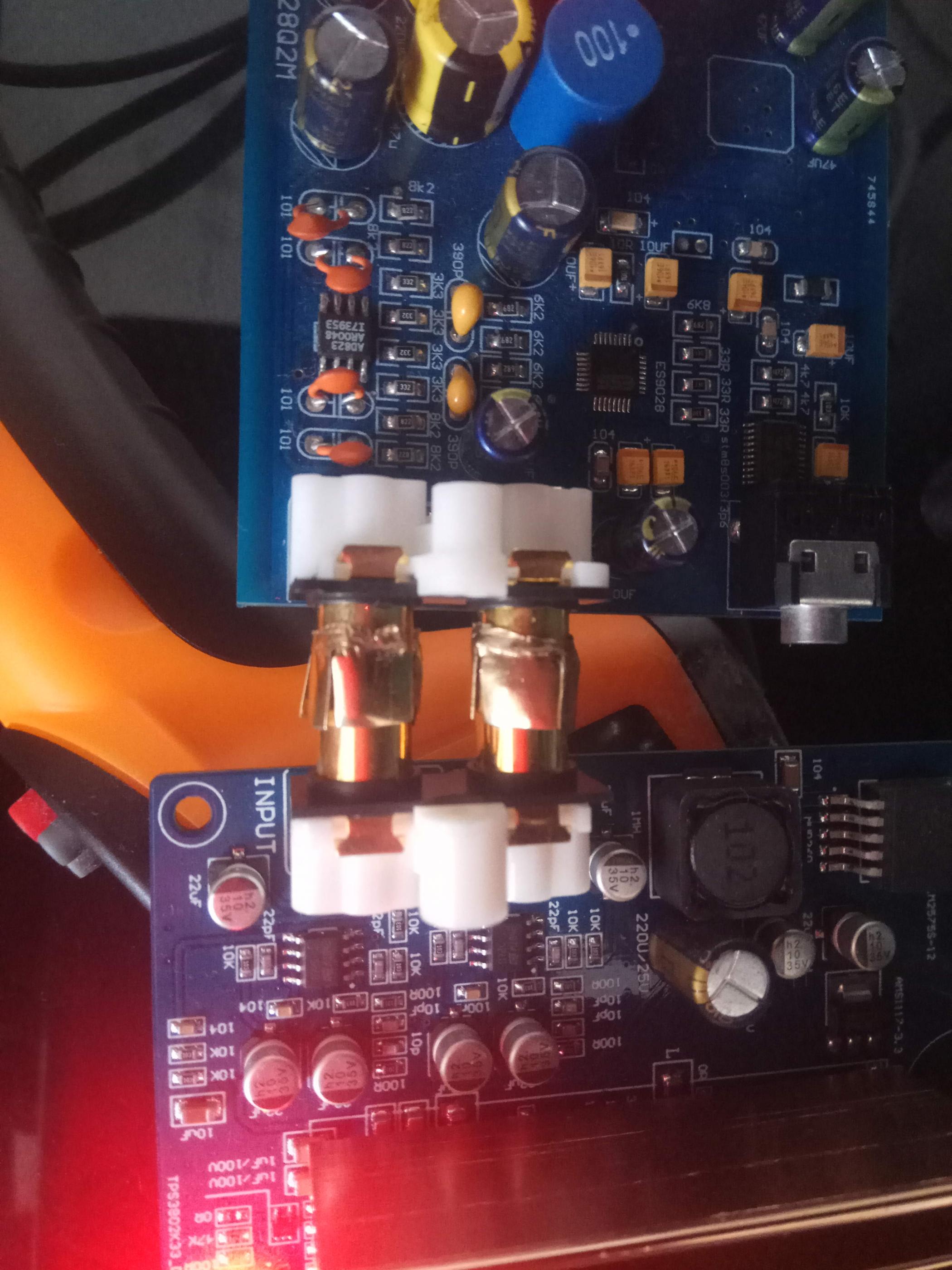

i tried it at the input rca instead of silmic 2 and the dark nichicon muse. it would be nice to here your feedback

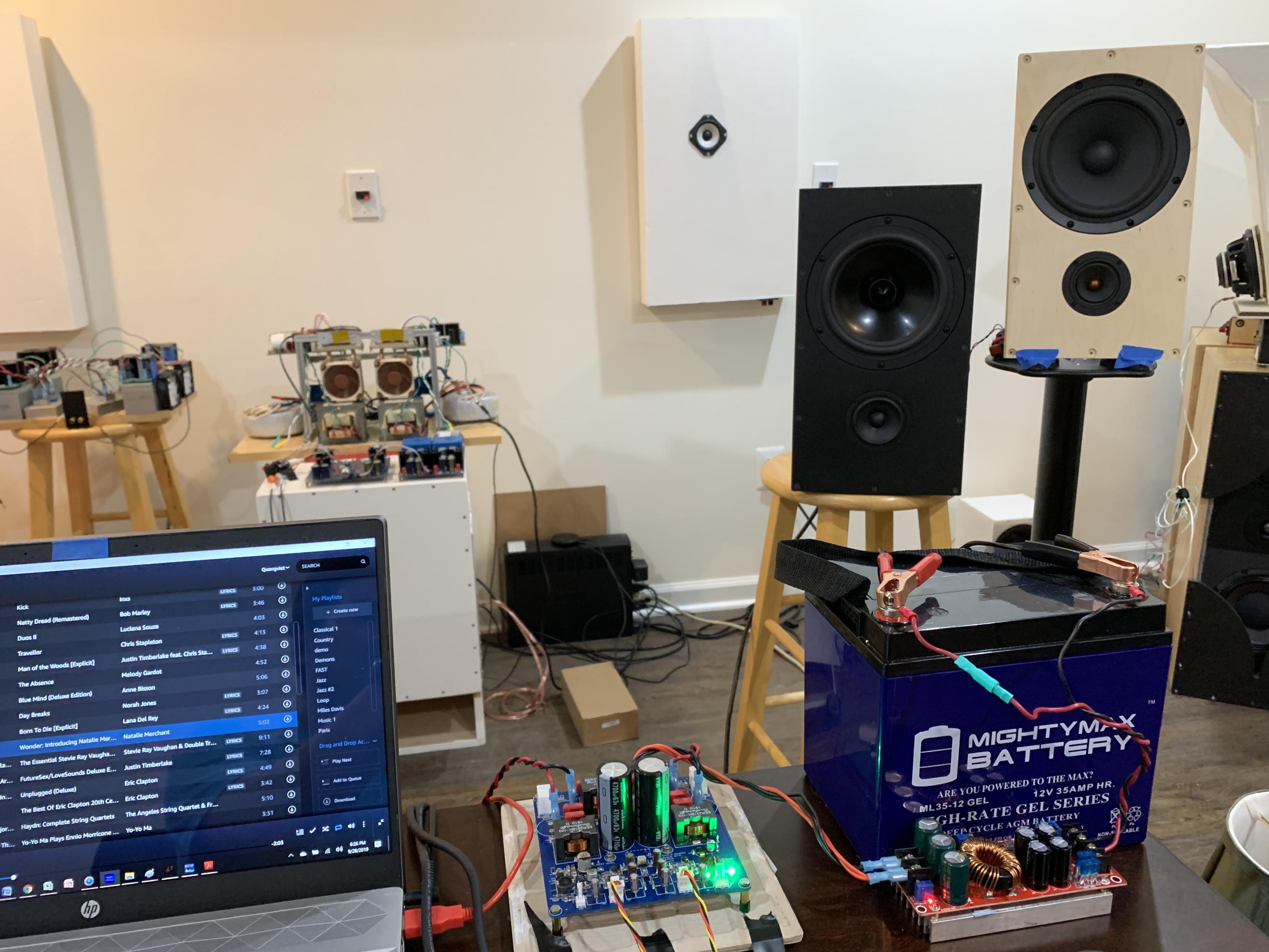

if you want a better focus at the speakers please try this:
as sandwich to avoid vibration - filter between your stand and your speaker
gel pads...e.g
https://www.amazon.de/gp/product/B00EANTICY/ref=ppx_yo_dt_b_asin_title_o06_s00?ie=UTF8&psc=1
bamboo plate.e.g.
https://www.amazon.de/gp/product/B0015ZCSS6/ref=ppx_yo_dt_b_asin_title_o04_s01?ie=UTF8&psc=1
gel pads
speaker

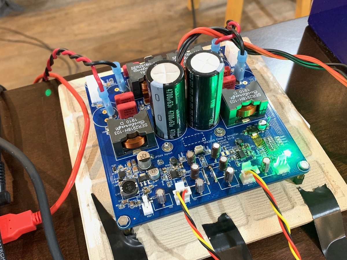

What I've done is to keep the amp muted all the time and only unmute via a raspberry pi GPIO when it starts playing music. If the power goes out the raspi goes out fast and the mute kicks in before the SMPS power ramps down and causes the pop.
Obviously, a dedicated controller that would watch the fault signal and trigger the reset would be better but that would be another project.
Can you (or anyone - it was a while ago!) point me to a schematic/piece of code for this?

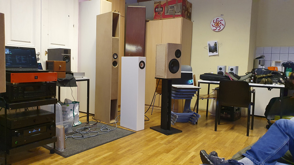

the pics shows a contest where some DIY speaker (4" +1, partly active) guys made a session. at this event i moved my DAC (CM6631A + fake amp) with me. i know that they are not really interested in compare "electronics". so i enjoy and wait...late evening i was lucky to demonstrate my DAC+amp....
the small speakers on the table - "twiggy" (81db...) i have to push over 1 hour with a lot of titles... i get from all guys very positive feedback
