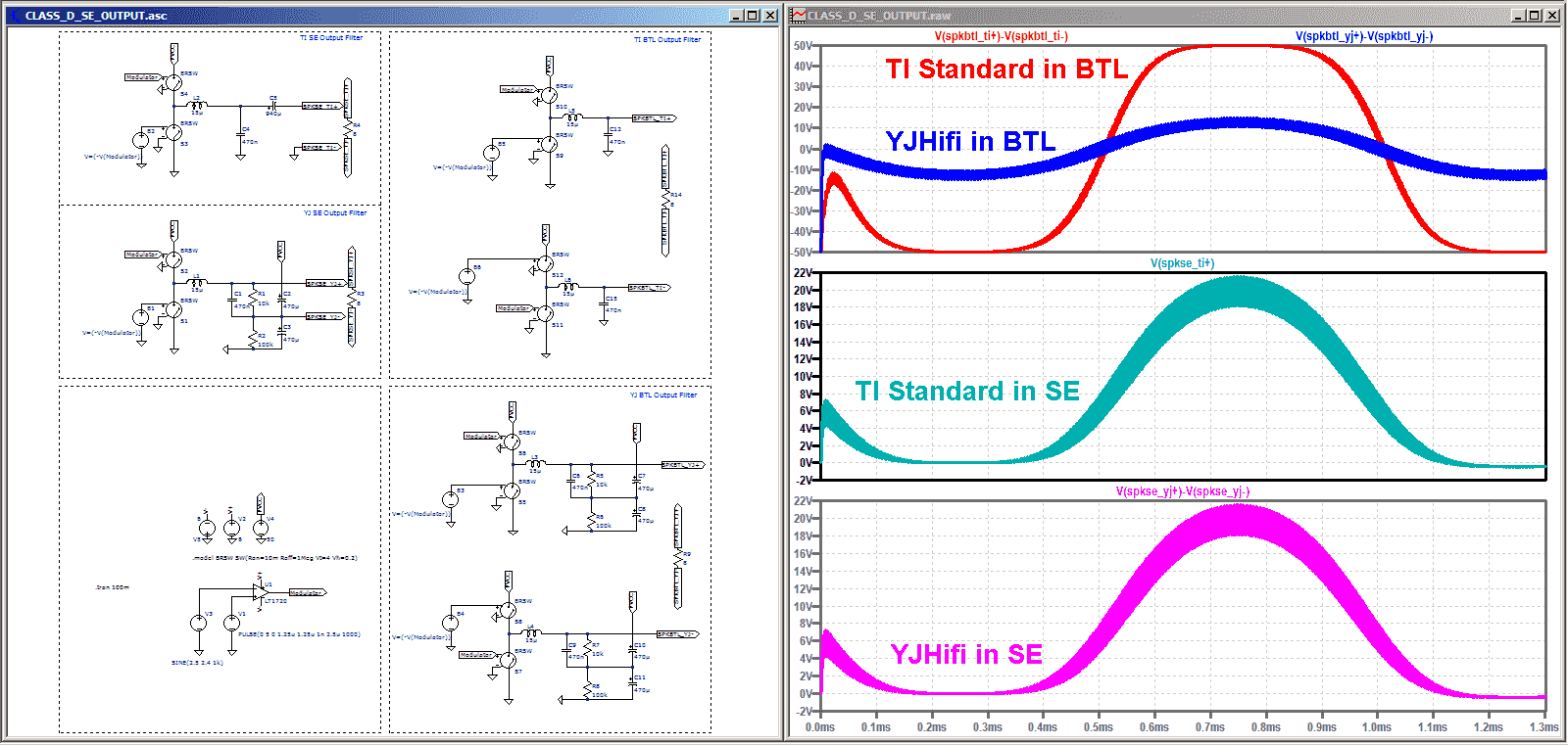

So this is a "save on caps" cirquit? Is it really worth the hassle with all these parts? Anyway, even if it works fine, the amp does not sound good. Maybe they should have designed the Bluetooth side better instead of going fancy with parts cost saving mod´s?

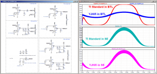

@RuslanK35,
no joke, it should work like it is intended by YJ. If the sound is worse with the original YJ arrangement compared to the now TI standard arrangement something's screwed up with the layout.
(I did simulated the arrangement with Spice to understand and asked some guys who should know better than me) 🙂
I do not know how it will work, but everything is done differently with them in the TI documentation. I will go mad before I get at least something worthwhile from him. I wanted to deal with the noises in Twitter that remained. I go according to the entrance scheme. I do not understand why there is not a capacitor for 10uF before entering the a b c d channel. Before the entrance there is a resistor at 100 and there is no capacitor. I hate Chinese crafts! while searching for information, 2 thoughts appeared in the noise fields. I found it with a similar problem, but on the TPA3116 board. if interesting link will leave. and the second reason is freq_adj pin. (described in paragraph 2.2 of the document TPA3255EVM user manual). but while the head is no longer working, I'll go to sleep)

hmm.. 😕
but what about these 2x 470µ caps - 1 to gnd the other to PVDD instead of the signal GND as TI
post #850
@RuslanK35
You wont need 10uF for the tweeter channels as they normally don't run fullrange. The input impendance forms a highpass with the DC-linking caps. (Aren't these two black market blue foil caps the DC-linking-caps for the tweeters? Connected via 100R)
Things you may check out of curiosity -> desolder the two foil caps and solder 100nF ceramic in place to compare the noise signature)
That is what i mean, it can be done like that and it should work fine. (Haven't seen such an arrangement in an amp like this before for SE outputs, but makes sense)
hmm.. 😕
post #850
ok Doc...you are an expert and if you say it should work its fine for me...😉

1. As long as the output stage is switching, this shouldn't be an issue.
2. I don't know, maybe intented for bleeding current

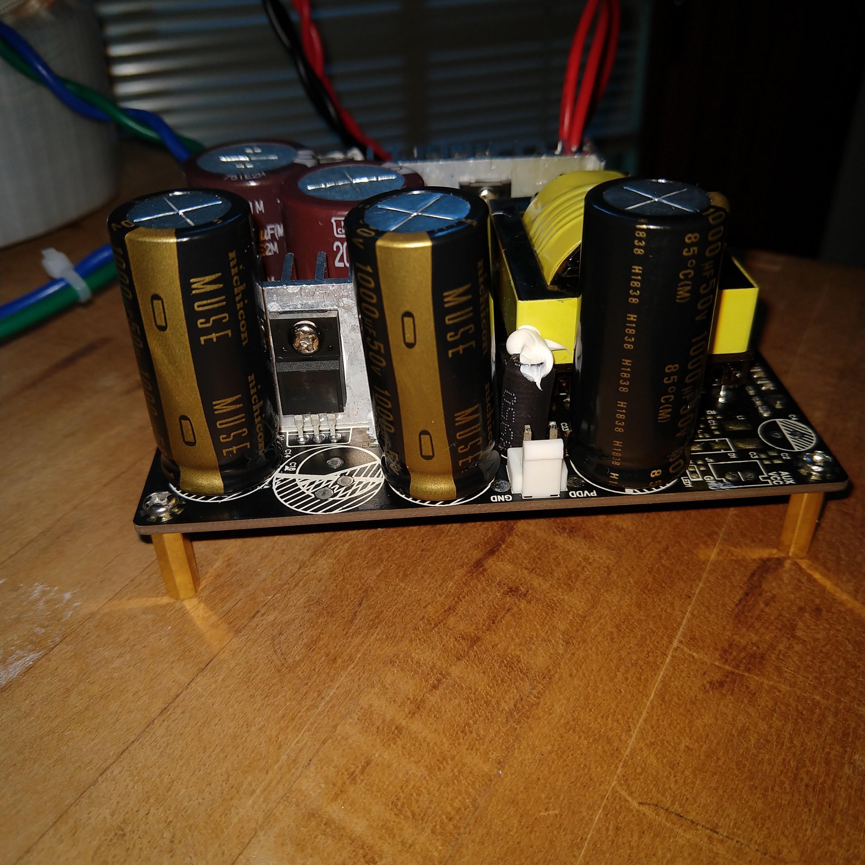

I came upon the thread after talking to a friend (an EE) who said I should look into the cheap Class D amps from China which sound amazingly good for their price. I’ve been building numerous Gainclone either based on the LM3875 or the LM3886 but have been disappointed with the lower frequency responses (even though the soundstage is pretty amazing when they are designed & built right). I’m using Genesis Physics model 210 speaker (8 ohm), an Akitika PR-101 preamp (bypassing tone controls) and a Cambridge Audio Dacmagic 100 modified as per this posting (Cambridge Audio DacMagic 100 – Audio Purist). So I bought the tpa3255 board from 3e Audio (260watt 2ch amp) along with the ICE2QS03G PS. They were so cheap what could I lose? I connected them all up (using the lightbulb protection startup routine). Everything sounded pretty good on the test speakers and not too bad on my normal stereo system. But there was no presence. It was a perfectly acceptable reproduction of the music (for the money I spent I had little complaints) but the musical reproduction was rather unexciting. I had some audio-grade caps left over from various Gainclone builds so I decided to experiment. I replaced the four cheap 1000uF/63V Chengx caps on the amp board with Panasonic FC grade 1500uF 50V caps. It was an immediate, dramatic improvement in the warmth and soundstage. Then I replaced the three (tiny) 1000uF 50V output caps on the PS with Nichicon MUSE 1000uF 50v caps. Holy cow! This amp sounds fantastic now! I would have skipped all the other Gainclone builds I’ve done (well not really..it’s was fun to build and experiment with them all & I learned a lot along the way). I just can’t believe how good this inexpensive Class D amp sounds now. Nuthin’ wrong with this TPS3255

Hi turion64
you change at the power supply or at the amp board at the supply section? pic please ...
chris
chris
