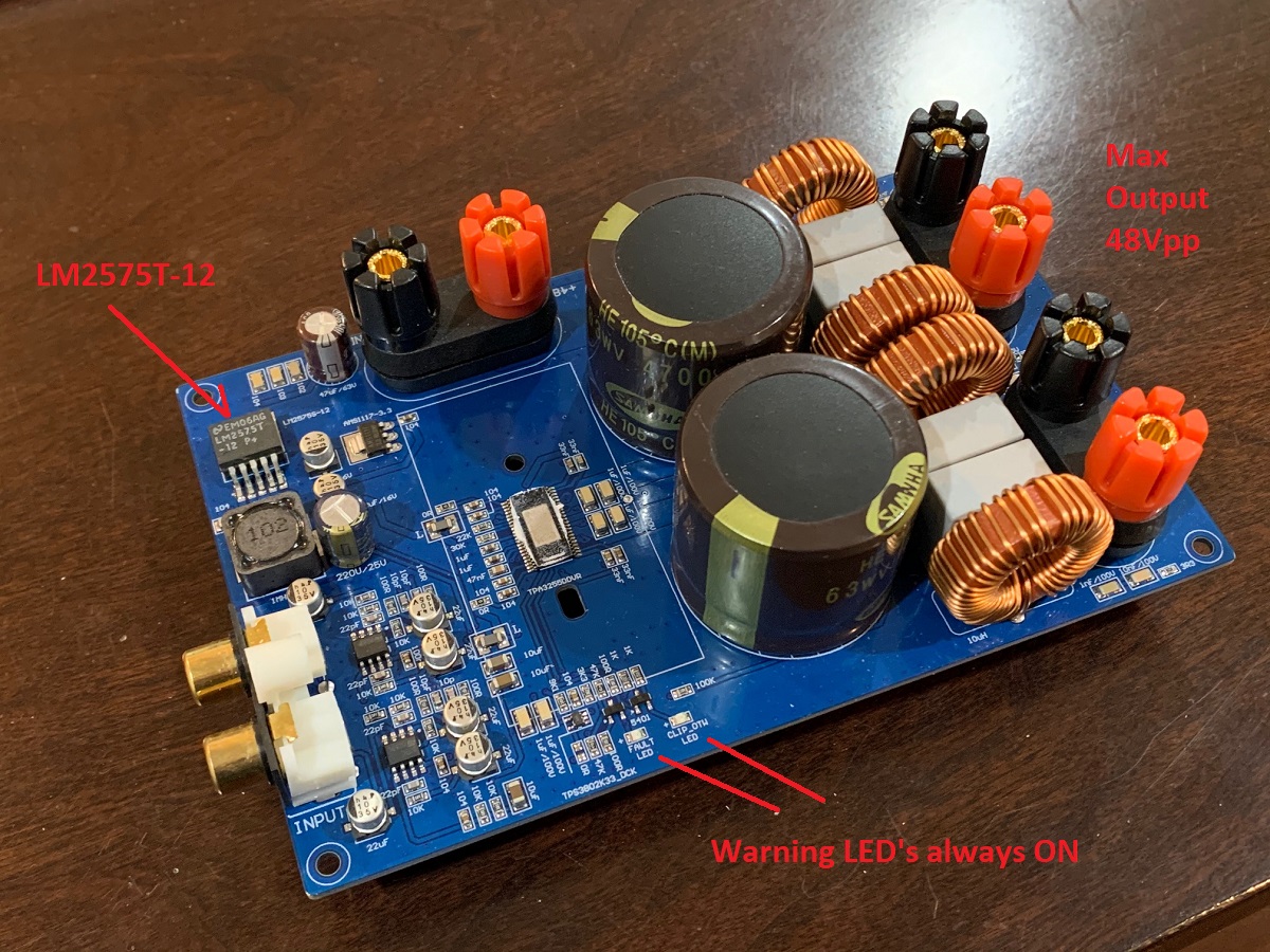

Is it just me or are all these issues observed in the other eBay/AliExpress/Amazon Chinese blue TPA3255’s?
These boards have errors on them that prevent them from being a practical amp. I bought two from different vendors and one was on Amazon. Still same problem because same layout.
1. The error lights for fault and OTW are always on when operating normally. How useful is that?
2. The amp has no remote reset capability, so if your input RCA has a glitch, the amp goes onto protect error mode and shuts down. The only way to reset is to unplug the power input. That is every inconvenient as the errors can happen with something like hot plugging in the RCA to a source.
3. I was unable to get more than 48Vpp out of it with a 51v PSU. I believe the hardwire soldered or layout based setup mode jumpers were incorrect and so it is not working in BTL mode which should give a swing of close to 2x48v minus MOSFET dropout on each end or 96v-8v or +/-78v theoretical max or 27.6Vrms for 190w into 4ohms. 48Vpp into 4ohms is only 72W - a far cry from 200W,
4. It has an LM2575T-12 switching step down regulator for making 12v from the 48v input. The "T" variant of this regulator is only good for 40V max input. It needs the LM2575HV-12 version which can go to 60v input. So I suppose the regulator must be sort of working because it makes music with a 48v to 51v supply, but who knows what the regulator is doing in terms of regulation.
5. The measured harmonic distortion profiles were not close to the specified levels of the TI reference design.
Basically, I can’t believe they went into production of tens of thousands of these boards without anyone catching these glaring errors.

I tried twice already on two separate "blue" boards. Maybe both are lemons? I had sufficient drive voltage headroom as preamp was +/-15v rail. If someone else can please test the Aliexpress/eBay/Amazon blue TPA3255 with a clipping test, that might confirm that I have lemons or flawed design. Redjr has one on his shelf... hint hint...
