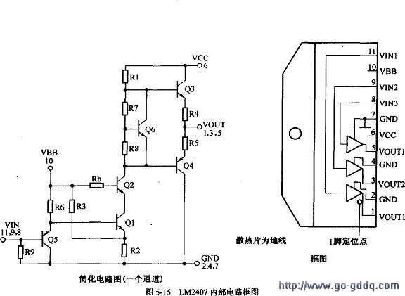

what do you think did LM2407 and other similar HD CRT video drivers chips is usable for some audio app.?
No idea, never use it. Some transistors designed for CRT video drive with very low Cob are preferable for VAS, but I don't see how this one can be used.
