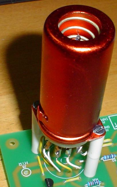

The Rusky dual triode equivalent cost me a dollar each, even got plenty spares.
For a dollar extra, I have them sticking out the top of the amp case, in pretty little red riding hood overcoat & knickers.
http://www.diyaudio.com/forums/atta...d1210075638-kleinschmidt-10a-red-russian2.jpg
http://www.diyaudio.com/forums/atta...60-kleinschmidt-10a-little-red-ridinghood.jpg
That tube looks much cooler without the cover installed.
