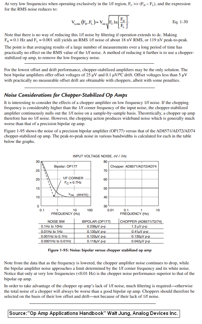

Scott, if one is interested on the noise and stability at very low frequencies close to DC, aren’t Chopper-stabilized amps a viable option?
I was reading from the link that rayma kindly provided http://www.kelm.ftn.uns.ac.rs/literatura/mpi/pdf/Op Amp Applications Handbook.pdf
George
I think the problem here may still be noise George - great DC performance though.
Someone will probably crack this noise issue with a 'left of field' approach rather than the brute force one of paralleling numerous devices, or cooling etc. However, I suppose you could just wire bond a whole wafer of BF862's directly to create a massively parallel device and then cryogenically cool it to deal with the dissipation.
Trying to extract information at 10^-22 levels below ambient reference - well there's a challenge!

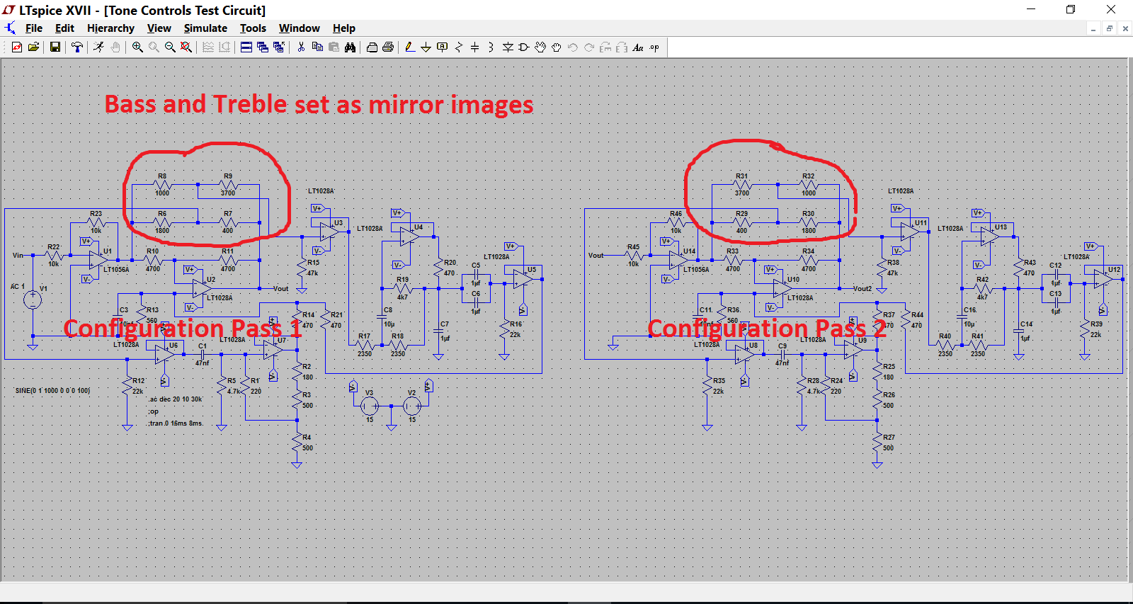

Is there agreement that Mooly's choice of opamps are equally suitable in the particular application example ???.
If not, please explain where any confounders to Mooly's experiment lie (Schematic please Mooly) and suggest schematic values changes to 'level the playing field'.

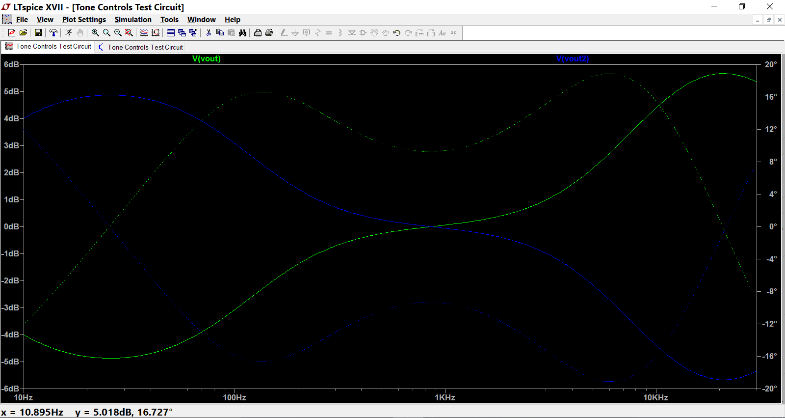

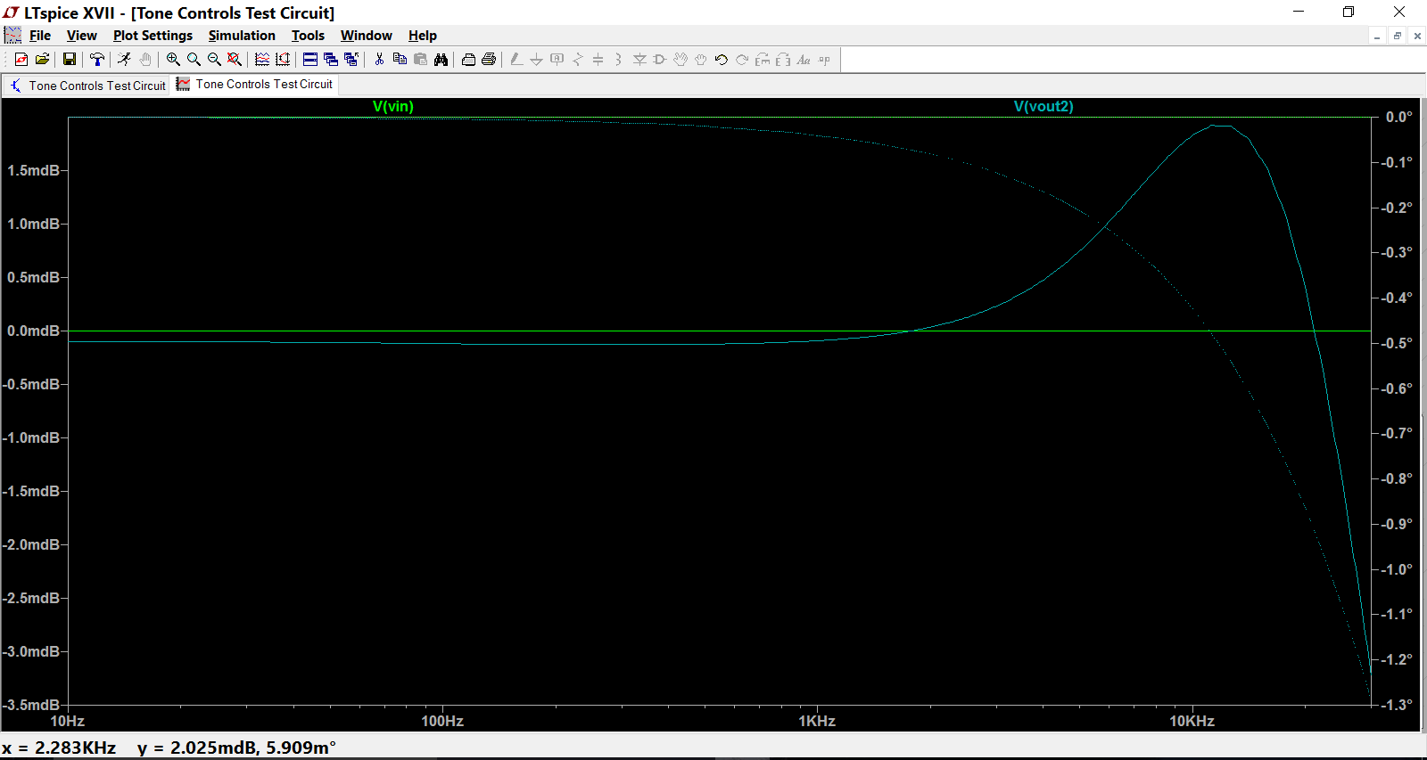

This is the circuit and its response with the controls set to 'cut and boost' and then 'boost and cut'. The last shot is of the overall response of the two set ups, one after the other. The rise in HF looks alarming but look at the scale.
George
Yes, but I need to find out any issues with that route. They tried composite amps but they didn't work. I suspect something is missing from the equation. BTW not much commercial interest here (8 sockets total) this is purely for the enjoyment in helping out. FYI, the reason for this is that the beginning of the chirps are buried in noise and there is real information lost there.
