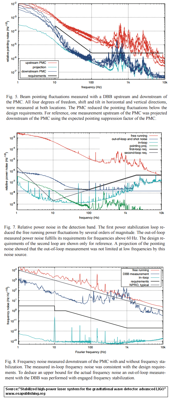

The LIGO site has full public access to some of the data sets/algorithms, just search around the site https://www.ligo.caltech.edu/WA/page/scientists. I personally don't understand what the theoretical physicists are saying but since the waves are much stronger as things spin faster they loose early data at low frequencies. There is also a desire to measure the background which I think they are far from.
Yes Andrew. As I read, the range of concern for them is from 1mHz to 100HzI think the problem here may still be noise George - great DC performance though.

https://arxiv.org/pdf/1602.03838v1.pdf
https://www.osapublishing.org/Direc...0-10-10617.pdf?da=1&id=232860&seq=0&mobile=no
http://dspace.mit.edu/openaccess-disseminate/1721.1/88409
https://arxiv.org/ftp/arxiv/papers/1502/1502.06300.pdf
George

Fascinating reading - incredible technology - thanks for sharing George.
