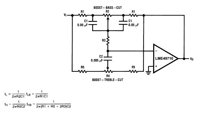

Thank you, John. What would you think of something like this circuit, with an extra opamp in front of it (as a non-inverting buffer)?
Let's say we want to have 20db boost or cut of HF and LF, center frequency somewhere between 1kHz and 3kHz, the shelving frequency a reasonable choice that's up to you. Total gain of the circuit at your choice from x1 to x4.
Output impedance of the source around 10k, and the tone circuit is expected to work into a load of 10k too.
Let's limit it to OPA134 and the LME49710 for now. Which one would lead to a nicer overall design?
P.S. You don't have to use the C values indicated in the schematic. They are up to you too.

Kind of a broad question there, and since it's Saturday morning and I'm lazy, I'll just venture that my gut says I could build a lower noise version of that circuit with the LME49710, and I always consider lower noise "nicer" 🙂
