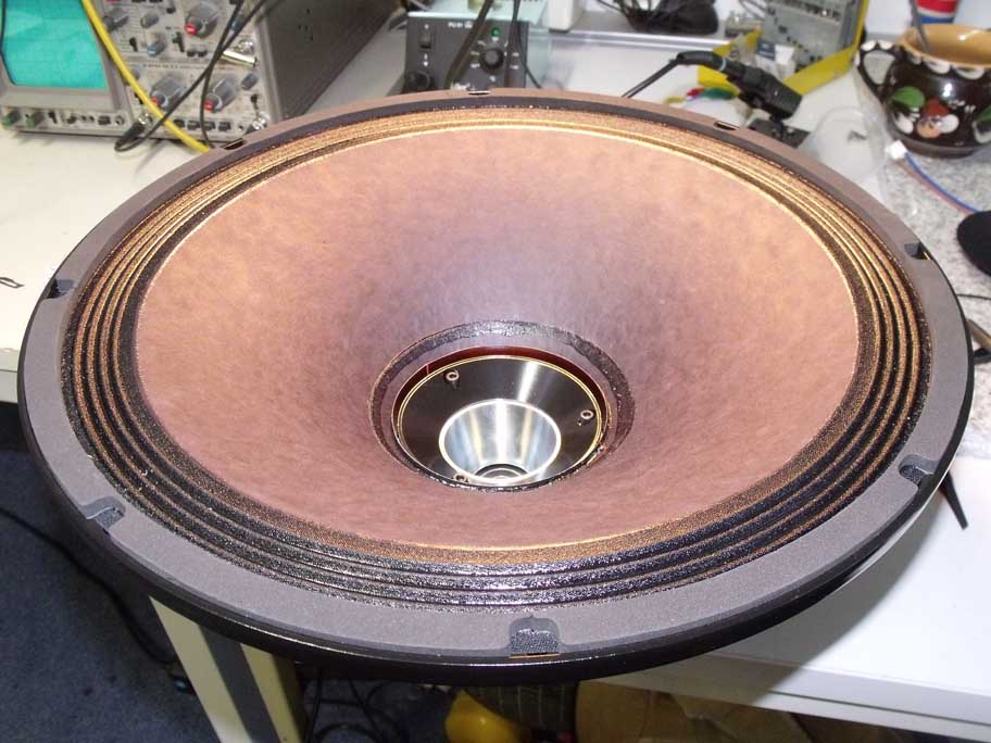

That one? Doesn't look too bad if one is looking for a very wide dispersion chassis. What driver is it?
I carefully removed the bug screens. Mind you, out of sheer curiosity, not for any specific acoustic reasons (there was only miniscule difference in the LF and HF response with and without). Close-up pic and full view attached.If that's a Beyma 15XA38Nd in your picture, what did you do to the cone?
The brown-ish color change comes from the light used (flash and regular bulb), in reality it is rather gray-ish.

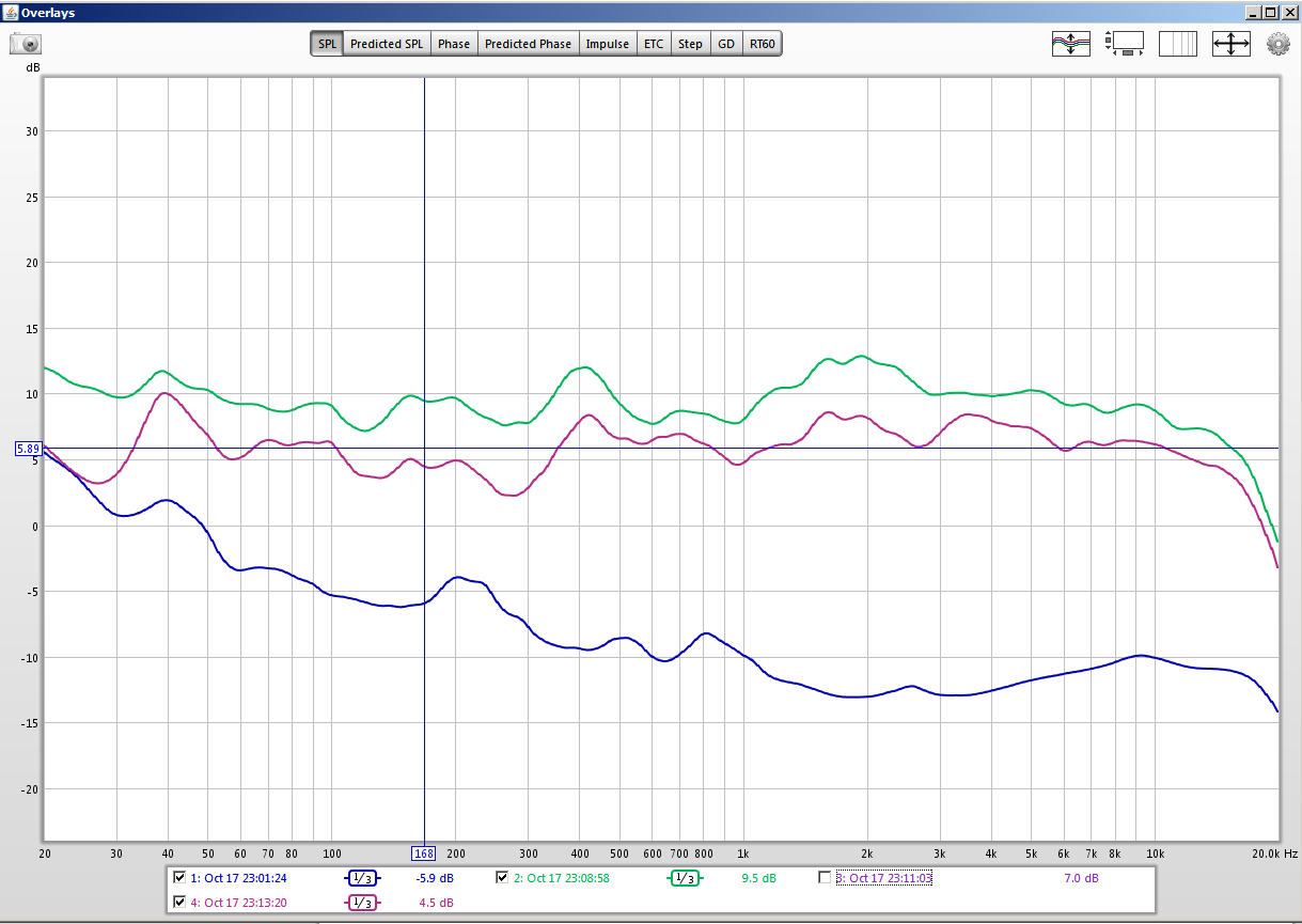

Hi Pano, I'm going to have to have another go tonight. apart from just sticking the mic randomly where I thought might be the centre, after I went to return the speaker cables to normal I noticed that the negative wire on the left channel had snapped off (not a mean feat for stranded cable) and was hanging down not connected. I think it must have still been connected when I did the measurement but it is possible that it came off when I was changing the phase of the right channel, and that my second measurement is just one speaker running. )or would that only result in 3db difference?)....
oops gotta run will miss the train!
Tony.
Both signals are coherent (they must be to make this measurement meaningful at all) and therefore add up to +6 dB. But then we have a problem with the situation at the cursor position ... 😕... but it is possible that it came off when I was changing the phase of the right channel, and that my second measurement is just one speaker running. )or would that only result in 3db difference?)....
Hi Rudolf, Yes I thought that was a little odd too. why just at one frequency? around 200Hz which is coincidentally (or perhaps not) the frequency that the raw drivers start rolling off in these enclosures.
I've also realized this morning that the hump at 560 Hz explains why I wasn't seeing a normal smooth baffle step drop with the first crossover. It was being filled in by that hump and then dropped like a stone at 300Hz. I'm wondering if the 560 Hz bump is actually due to the TV screen which is between the speakers. It is an 81cm CRT and has a slightly convex screen (ie not dead flat) I'm wondering if it is extending the baffle and acting like a bit of a lens at that frequency. (raw driver nearfiled for the mw144's is ruler flat from 200 - 1Khz)
and pano, yes I think that you might be onto something (assuming my measurement was valid) and perhaps the crossover itself plays just as big (or bigger role) than the type of drivers or enclosures?? BTW are your horns time aligned? My MTM's I believe are.

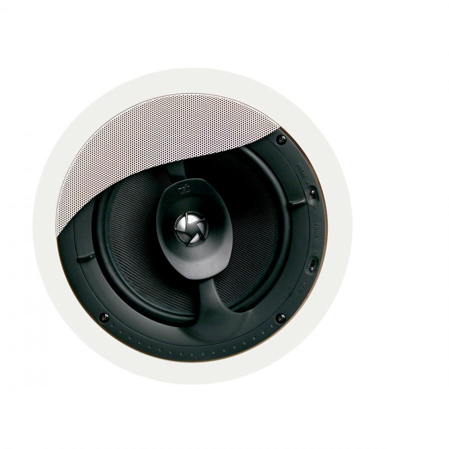

You know, in all honesty I forgot the brand on that driver. I did it for someone else who had done the design and I just don't recall what the drivers were, just that it was a coax horn on a woofer.
I've seen worse responses thats for sure, but I have seen better as well. In a pinch, where space is at a premium, coax is very attractive, but the belief that they somehow "solve some serious problems" is clearly not correct. They create more problems than they correct.

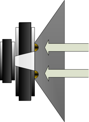

Hi KSTR,
Maybe you could try to change the profile of this horn. It's possible to make a kind of half donut (or half tore) because you have enough space between the horn exhaust and the coil. It would be relatively easy to do it with wood, and with a better profile than the half round of my scheme. Only the back oblique part will require some adjustment skills. Or maybe it's disposable and then you can made an easy flat base ?
You will not harm the driver, and if it's not positive, you will at least be sure that the designers did a good job.

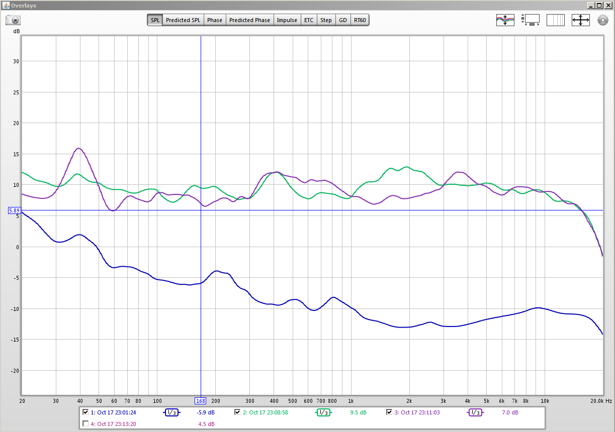

Only a quick test tonight, but after it I suspect my test last night had only one driver running for the second test. I was able to reproduce a very similar result tonight only by running both drivers then disconecting one. When I reverse the phase of one it is all over the place!! interestingly tonight I don't have the large 560hz bump, It may have been the bicycle helmet I was using as a mic holder 😉
I was running with a much lower spl tonight as well, but almost deafened myself when I quit REW and started getting massive feedback!
ugly response follows, more testing required!!
1st pic clearly not right. 2nd pic with left channel disconnected.
OK then. Looks like it was a simple 2 speakers vs 1 speaker test. Interesting in and of itself!
