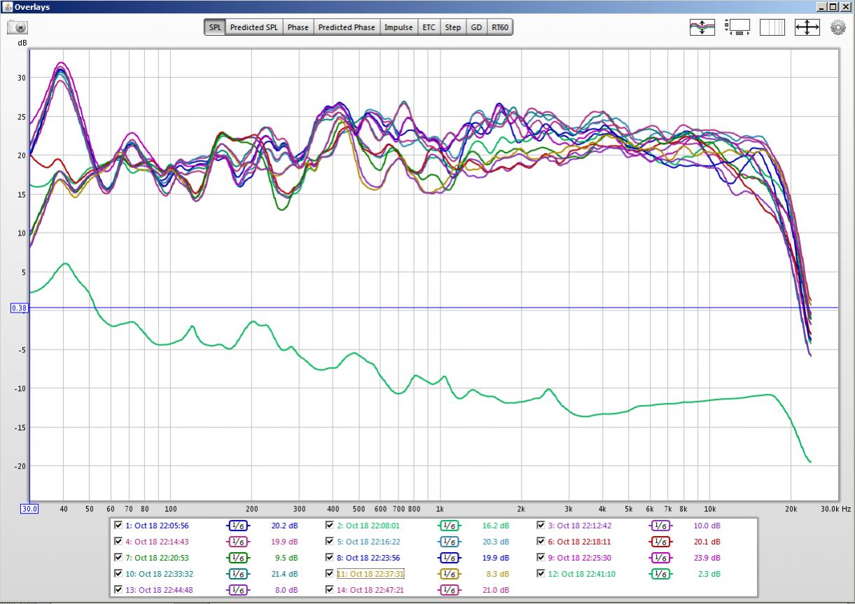

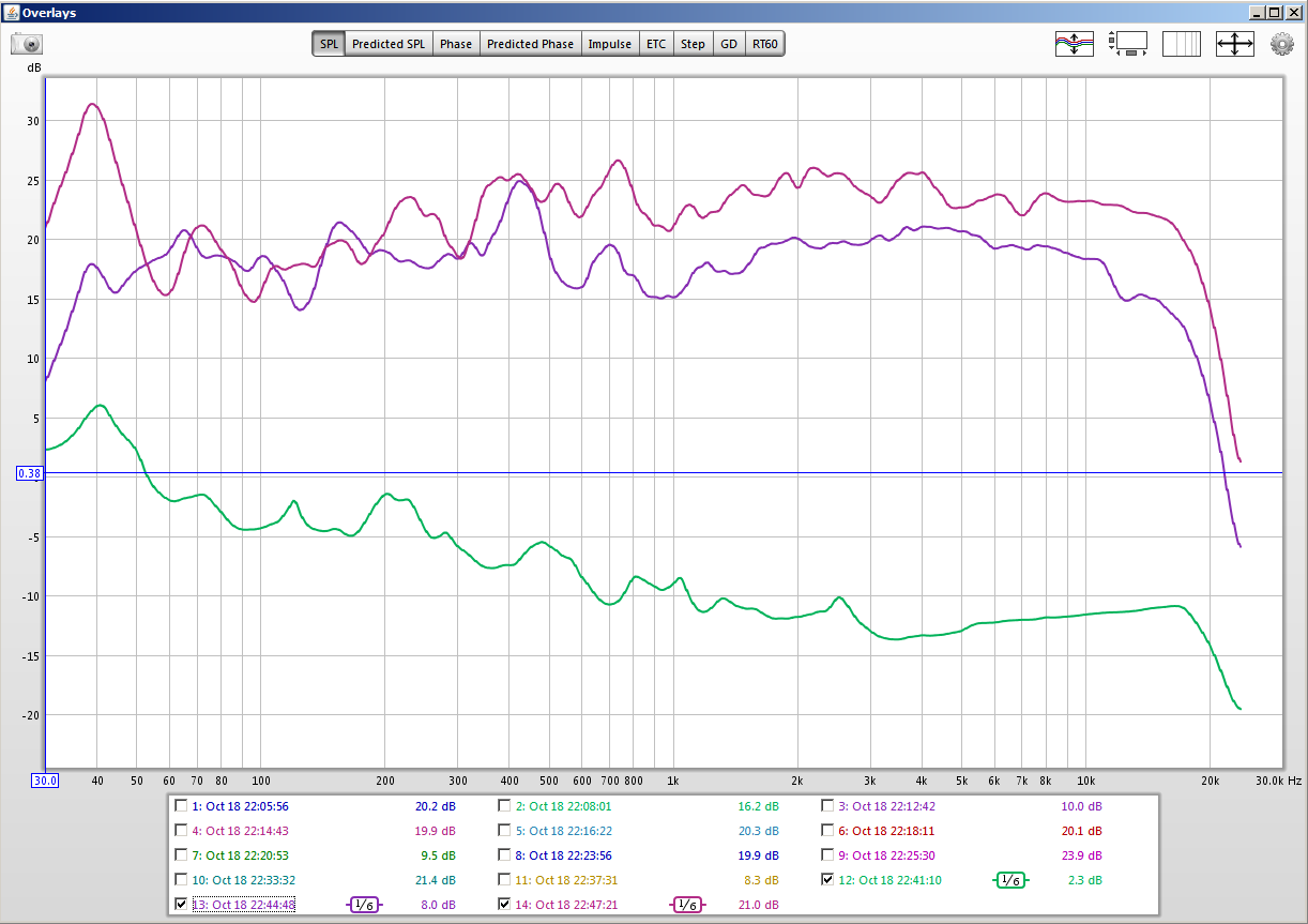

Thanks Simon, that makes sense. I've done some more experimenting tonight, played with speaker position a bit (widened slightly and toed in more) and also spent quite a while trying to find the ideal mic position. I've given up with a somewhat better result. The fact that my room is far from symetrical with one wall within about 1.5M of the left speaker and the other wall about 7M from the right speaker I think means I will be hard pressed to get a uniform result. It was quite interesting to see just how far the measurements varied just from moving the mic small amounts.
The first pic is the best result I managed. The second pic is all of the measurements I made tonight with slightly different mic positions (moving left and right probably a maximum of 5cm) as you can see the lower frequencies vary very little but after about 200Hz the differences start to show up.
tonight I've gone with 1/6th octave smoothing rather than 1/3rd

Your first graph is quite interesting, above 500Hz or so there is a good fairly uniform ratio between in phase and out of phase, then below 500Hz it all turns to custard, which will be almost certainly your room assymetry with one speaker close to a side wall and the other not. (I see a smaller but similar effect with my slightly asymmetric side-wall spacing)Thanks Simon, that makes sense. I've done some more experimenting tonight, played with speaker position a bit (widened slightly and toed in more) and also spent quite a while trying to find the ideal mic position. I've given up with a somewhat better result. The fact that my room is far from symetrical with one wall within about 1.5M of the left speaker and the other wall about 7M from the right speaker I think means I will be hard pressed to get a uniform result. It was quite interesting to see just how far the measurements varied just from moving the mic small amounts.
Of particular interest are the frequencies where the out of phase line actually goes higher than the in phase line - 180Hz, 100Hz, and 60Hz. What that means is at those frequencies the actual phase shift between left speaker and right speaker (inclusive of room reflections) when connected "in phase" is actually mostly out of phase - somewhere between 90 and 270 degrees, due to the room modes and boundary cancellation.
😀Yes, a real gold mine of info in there. Not sure what to do with all that gold ore, tho.
I just thought it looked pretty :🙄
The one I think is most interesting is the 40hZ spike. around 15db difference between in phase and out of phase! But yes those out of phase higher than in phase frequencies are also very interesting.
I guess it is showing me what I knew all along, that my listening room sucks 😉 It is quite surprising that I do get an image, though I do have trouble trying to pinpoint locations. Its more like I can hear the trumpet up a bit higher and a bit to the rght, the piano seems lower down with low notes further to the left high notes further to the right. The singer sounds more forward but reasonably central, it's noticable there are differences in location, but they are not that precise.

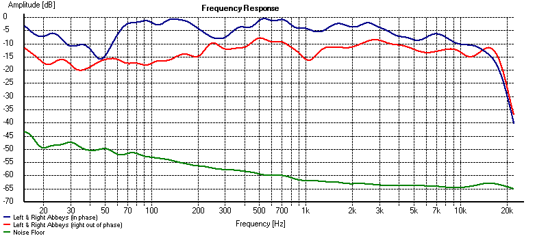

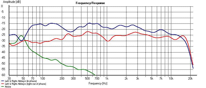

More cancelation at low frequencies than high frequencies. Seems a little odd assuming the directivity rises through the range. Is your channel balance good?

David,
with such a high noise floor at 50 Hz Pano doesn't see the cancellation any longer. 😱

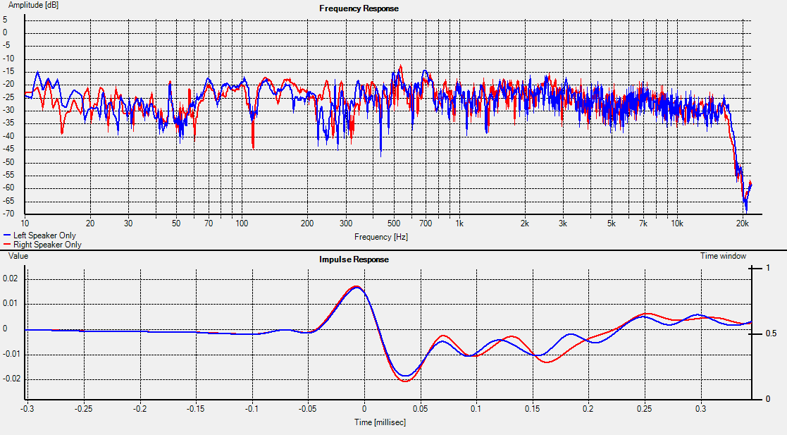

See raw response below.Is your channel balance good?
Also, not my room so I can't comment on noise. The noise peak is at 46Hz, so no idea what it is. Other than that, very quiet. It's a residential neighborhood, typical US style.
Most non-American countries have a mains electricity frequency of 50 hz. Maybe a ground loop is what causes the noise?
Apparently it was computer fan noise near the mic. I don't know the SPL that the test was run at, but it might have been low, thus the fan noise showing up.
