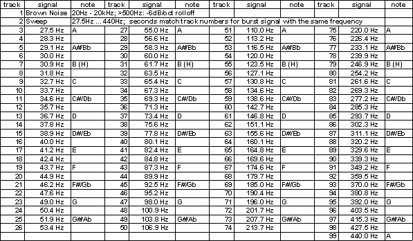

If you want to do some listening tests with shaped tone bursts, you might want to try a set of low frequency test signal sequences I made about 10 years ago (man, I'm getting old, time passes by faster and faster) : http://casakustik.de/down/testsignale_v0.9.21.zip
(Sorry, no english documentation, but the CD-index pic (see attachment) gives the basic information).
Main intent was, originally, to have a very ease to use test CD (if you had a CD-text feature in the player) to dial in EQ for small live venues at the time I was a (semipro) live mix / club sound engineer, but it is well suited for home use, too.

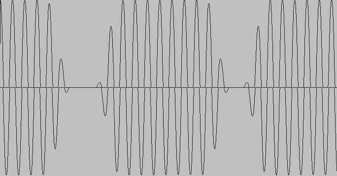

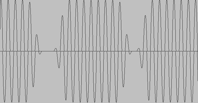

The sequences are organized as 4 sets of bursts per test frequency (1/24th oct steps), with raised cosine edges, burst length continuously decreasing in each set.
1st set has no polarity flip beetween bursts (left pic),
2nd set has polarity flip after each burst (right pic)
3rd and 4th are like 1st and 2nd, but with the right channel inverted (out-of phase).
Keep volume low (signals are at very high digital level)!
The key is to also listen to the silenced parts in between, how they are smeared, and the overall temporal character (besides the obvious level differences).
It is a pretty annoying test, you might think your speakers and room are total crap, but to our rescue the problems with real music are less pronounces, but still noticable. Try listen to the signals with headphones first.

While this is a MP3-download of a complete CD content, all that is really needed is the two little generator proggies (DOS, 16bit, source code provided) which build a set of 98 .WAV files. A pink or brown noise signal is also assumed to have at hand for the first track.

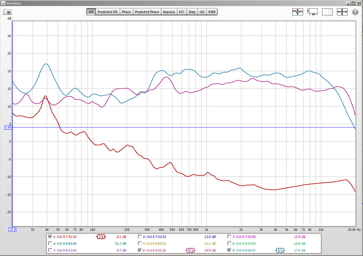

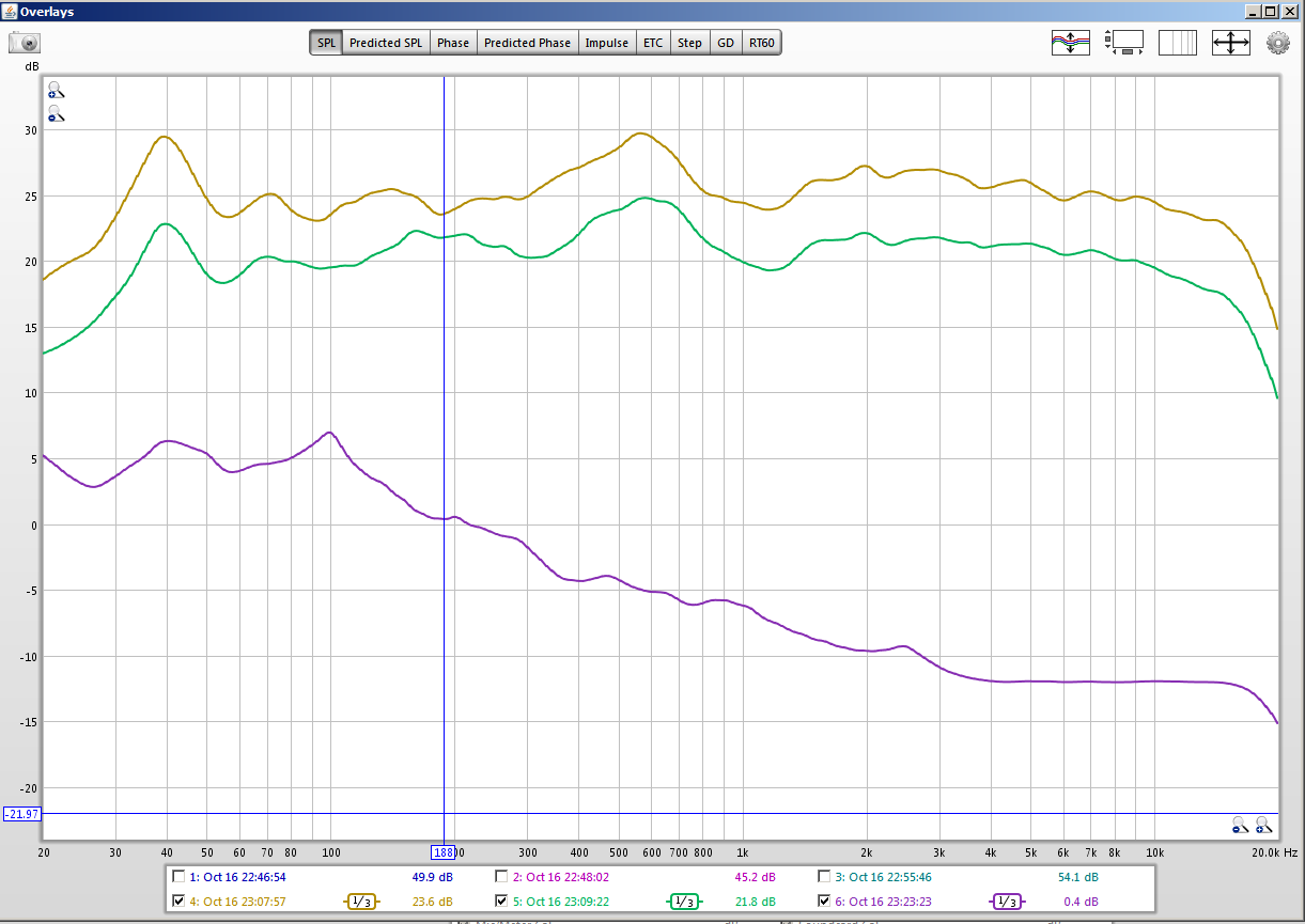

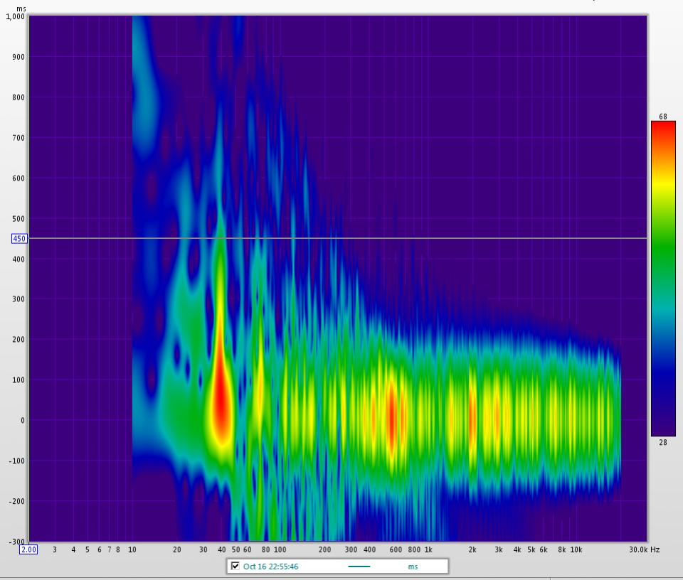

Well I said when I finished my new crossovers I'd do the pink noise test again. I seem to have got a much more uniform result than with the old crossover. Pics attached. 1st is the latest in/out of phase measurement (again It's late so I didn't try and optimise). The second pic is a spectrogram measurement taken at the same point. Looks pretty nasty below 500Hz (though I'm not really sure how to interpret it).....
finally the third pic is the previous comparison.
The big peaks in response at 40Hz and 560 Hz are interesting, I'll have to see if they are room nodes. Certainly I don't think that they are the speakers! The 40Hz one is puzzling as the speakers should be about -10db by then.
Tony.
Tony.
