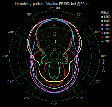

@ Rudolf : to make it clear, you mean that your tweeter is dipolar ? If they have the figure of 8 (for sure you have measured) your conclusion makes great sense. Could it be lively rooms = tweeters audible as separate sources ? My room is indeed very reverberant in HF.
"Full" figure 8 only up to 4 kHz in this case. 6 kHz is already -10 dB in the rear 🙄:
attachment.php
The front wall to side wall corner is drywall. No acoustical treatment at all.
Rudolf

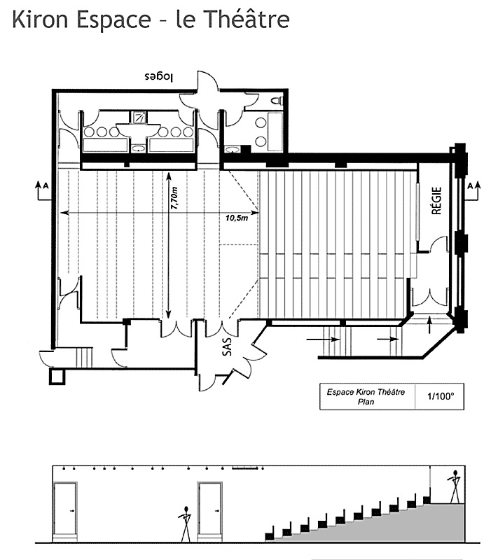

David, as concerns the demos in Paris, I would say yes, no and I don't know.
As I was very familiar with the sound of that space - I practically lived there - the space recreated by the system was often much larger and different than any I'd heard before or since in that venue. I'd heard a lot of live and recorded music in there but it didn't sound like this. Nothing else had that immense sound of a much larger venue. There were a few amazing symphonic and choral recordings that had completely believable width, depth and height clues. It was the precise height clues that many of us found so surprising.
It was not all "you are there". Some of the jazz and pop recordings where very much "there are here, right on the stage."
Was the space anything I'd heard before in there? No
Did the size of the venue help? Yes, for sure.
Were the acoustics of the venue the main factor? I don't know, but I don't think so.
I've played some of the those amazing recordings on many other systems, some were larger systems in larger rooms, and they still never came close to the demo. Why, I don't know.
Just FYI, here is a diagram of the demo space. Much larger than a domestic listening room, but not the size of a symphony hall.
