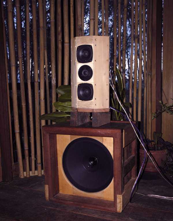

erjee, your remarks are legitimate and welcome. Joined pic, the speaker I used this day, made from recycled projects but very orthodox (if compared to my everyday system), triamp, DCX, EQ, more or less flat, no worries.
The 3 persons I had (women, 18, 30, 34 yrs old) are I think trustworthy. The first one was always showing the right side as a source, annoying ! I checked, and discovered that this speaker was 15 cm too close from the axis. All mankind has good ears, not only the audiophile crowd (and not at all the pro musicians, sorry...).
I conduced the test like that : the connected R & L speakers, and a fake speaker in the middle. I explained that the sound will alternatively come from the right, the left, both sides together or the center. This one being incarnated by the fake speaker.
Like this, no hesitation to show an empty place as the source (and I don't have to explain what's a phantom image). I think it's a valid process.

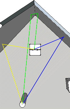

Elias,
in your statistics you can firmly count on me as a member of the "center image only" camp. My pink noise test was done in a (dipole) system with strong ipsilateral reflection:
Very week first ipsilateral reflection (yellow), strong second ipsilateral reflection (green), week frontwall reflection (blue). Pole is listening position.
Compare that to Markus' comment:
With a toe-out and the Nathan's my experience is nearly identical to that of Rudolf. When using a 45° toe-in things change, the phantom center is very well defined but also near.
Isn't this an indicator, that systems with strong ipsilateral reflections will make tweeters even more audible as separate sources than the usual stereo triangle?
