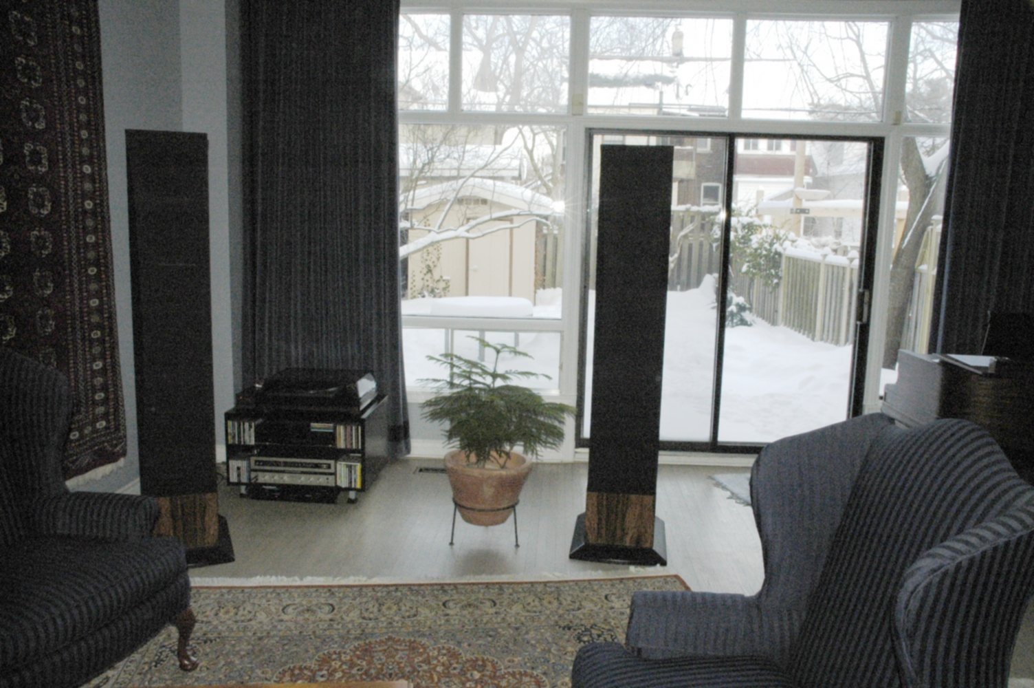

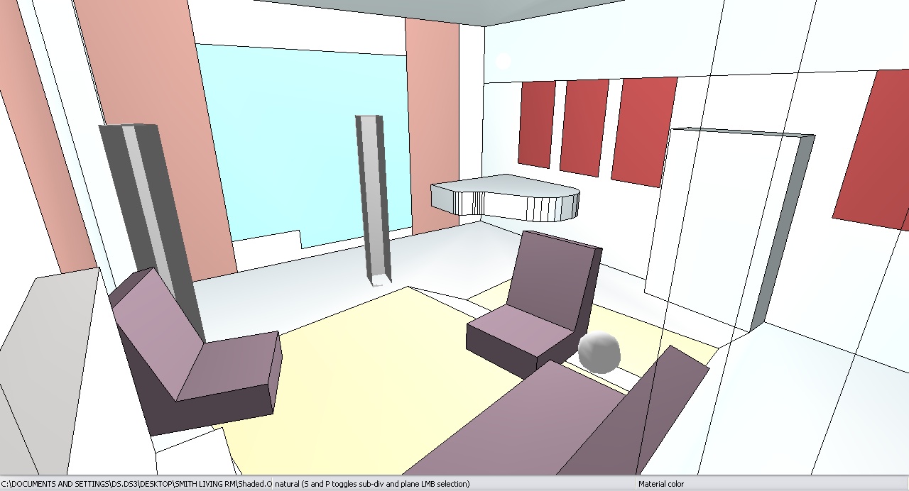

I just tried a calculation for my small room with a mean Alpha of 0.4 to see what it would give.
Length is 4.8m, width 3.45m, height 2.4m, which gives a volume of 39.744m^3, and a surface area of 72.72m^2. Using the sabine equation I get 0.22s.
The room is at about 0.4ms now and sounds a bit too live to me, (I prefer the drier end of the scale) but 0.22 seems quite low, unless I've calculated it wrong ? Mind you, this is the smallest listening room I've ever had, so I'm basing my expectation on somewhat larger rooms.
My 0.4 alpha number is probably a little misleading in that it is a number I've found works for a well treated commercial theater of any size. It is probably significantly higher than the typical living room, although a purpose built listening room or home theater could easily hit it.
My living room is 96m cubed and has a mean alpha of .17 with the drapes open (0.69 secs. with Sabine equation) and alpha of .21 with drapes shut (.57 secs RT). An alpha of 0.4 would give .3 secs RT. These calculated RTs are with a spreadsheet model. Using CATT acoustics, a ray tracing program gave .5 secs drapes open and .42 sec drapes shut. Measurements are closer to the CATT acoustics numbers.
Even with some significant damping material I am probably only neutralizing the hardwood floors and thin oriental rugs.
I've attached some pictures plus an image of the computer model, for anybody interested.
