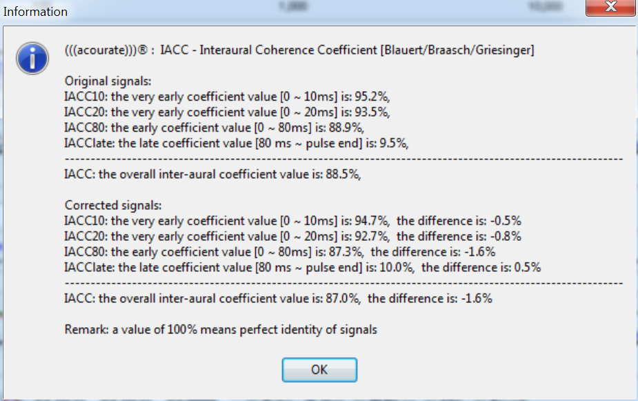

Attached is an example of an Acourate IACC measure of my stereo speakers and room. It covers 0- 10ms, 0-20ms, 0-80ms, and 80ms - pulse end. This would suggest that Acourate does measure the time intervals for reflections.
The longer the impulse response is as close to identical for each channel, including room reflections, the better the stereo imaging. I suggest this has been known for sometime in the recording studio/control room world (where I come from). See Chips Davis AES paper on LEDE concepts as it was using TDS and a TEF computer that started to uncover/document this in the 80's.

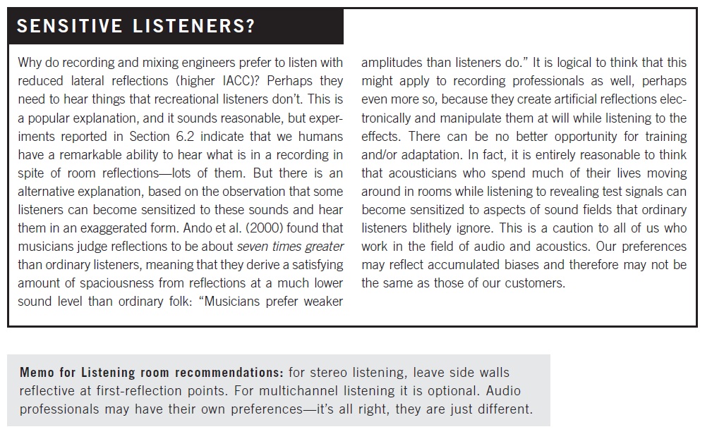

Toole, "Sound Reproduction: The Acoustics and Psychoacoustics of Loudspeakers and Rooms ", page 119:
I think we need be careful to draw too conclusive conclusions from Toole's tests in this area. He's not very conclusive himself if you look at this answer below.however such loudspeakers are losers in listening tests according to Floyd Toole
The "Sensitive Listener's" article is interesting in that regard and Toole touches that himself in the comment below. It may be that listening over both for a period of time changes the preference. Personally I've always preferred to remove the side reflections in small rooms. Especially when it's combined with a later arriving diffuse field from behind. The diffusion from behind is the closest you get in a small room to the 20-25 ms lateral contribution in concert halls. Toole by the way, never conducted a test with a highly diffusive rear wall to my knowledge, and he also point out that stereo is limited in spaciousness. To increase spaciousness, is one of the reasons to use diffusion in a LEDE/RFZ matter. Multichannels with rear speakers is his approach rather then diffusion and they are certaintly not the same. One uses a passive contribution, the other an active. Passive with diffusion sounds much more natural and pleasant IMO. In other words, there can be variables here that can change the result of such tests.
His comment on reverberation time shows IMO that he misunderstands what true reverbaration is. It simply doesn't exist in a small room within the strictest definition. Well known among those who have studied small room acoustics.
"People who say I dismiss room reflections as unimportant - and there are a few, it seems - simply have not read or understood my book. It is patently obvious that room treatment is necessary, if only to establish conditions suitable for comfortable conversation. This requires reverberation times under 0.5 second. This alone, also pretty much ensures that film dialog will be clearly understood.
The most debated issue relates to first lateral reflections. Some of those arguing vociferously in favor of eliminating them seem to have a conflict of interest, being providers of acoustical materials. Others have more reasoned arguments. I say up front that there can be no universally satisfactory answer because there is no universal scheme for recording stereo or multichannel signals. Only through controlled listening tests can we get useful insights, and these are in short supply. In the meantime opinions reign supreme, and there are many of them.
In the book I show results of several double-blind evaluations, some done by me, some done by others, showing that listeners tend not to be disturbed by lateral reflections, and many even prefer them. I also point out that the professional side of the industry almost universally feels the need to eliminate them. I suggest, respectfully, that humans have a remarkable ability to learn, to adapt, and that recording engineers spending their days adding, adjusting, and removing - at will - delayed sounds from mixes undoubtedly are more highly sensitized to these sounds than are lay listeners. This probably applies to any audio professional, acoustical consultant or enthusiast who focuses enough attention on this task. We learn to hear things and, once heard, they tend not to go away. I well remember that during the resonance detection experiments, we all became extremely skilled at hearing and identifying resonances. During the tests, and for some time afterward, we were hearing little resonances in everyday life that normally would have been totally unnoticed. From such things paranoia is born, and if we had taken this to an extreme, we would have damped our wine glasses.

well, I read everything:
For stereo listening I have found that it very much depends on the program. Music with lots of decorrelated sounds, classical for example, is sometimes enhanced by reflections, although coincident-mic recordings may benefit from a lack of reflections - letting the direct sounds be more dominant (the Blumlien stereo effects work best in an almost anechoic situation). Pan-potted recordings (the majority of pop) end up delivering essentially monophonic sounds from left and right loudspeakers, and these may well benefit from a bit of spatial enhancement.
perhaps I am wrong but the above quoted for me clearly reads: "whenever there are spatial cues in the recording itself the recreation of this space is not hindered by a low IACC stereo setup and sometimes it is even enhanced by it". Right? Perhaps with one exception of pure Blumlein recordings which are rather a rarity today.
