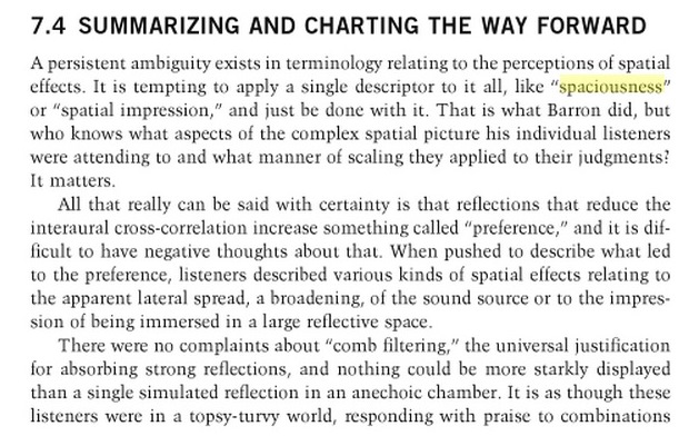

well, in Toole's book "spaciousness" appears 67 times
Toole writes about a "sense of spaciousness" or "spatial impression" in this context

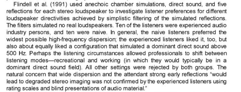

I'm afraid that's not impossible with just two speakers and no additional processing. While strong listening room reflections can create a sense of spaciousness, this is NOT the spaciousness of the recording space. One would need to extract spatial information from the recording and present it over additional loudspeakers from different direction than ±30°. Not a trivial task because important spatial information is lost in stereo recordings. For example no specific room response for let's say 90° can be extracted. There are processors that try that stunt though, e.g. Dolby PLII or NEO:X.
What is that based on? Your personal preference?Actually there are several good reasons for this that are NOT contrary to the notion of improving sound with side-wall reflections.
1. Generally 5 feet or more away from the side wall and it's NOT an issue. Anything closer and lowering the intensity of that sidewall's reproduction can be a good thing.
How does that relate to "are NOT contrary to the notion of improving sound with side-wall reflections".2. Lowering contralateral ("far" side-wall) reflection effects - effects which increase cross-correlation.
3. in context with #2, substantially lowering contralateral reflection effects when listening at a significant distance from the loudspeakers relative to the loudspeakers and their contralateral wall.
Either I misinterpret or it looks like you contradict yourself.
Sounds doubtful. Two absorbents? Two bookshelves would probably be better since they also isolate more from outside noise.4. Lowering room noise generally - which tends to increase apparent direct sound.
What I can however see as one reason that contribute to why many prefer removing sidewall reflections is that their speakers aren't very constant in their response and sidewalls are close in most rooms.
yes, it IS
of course only when there are any realistic spatial cues in the recording
